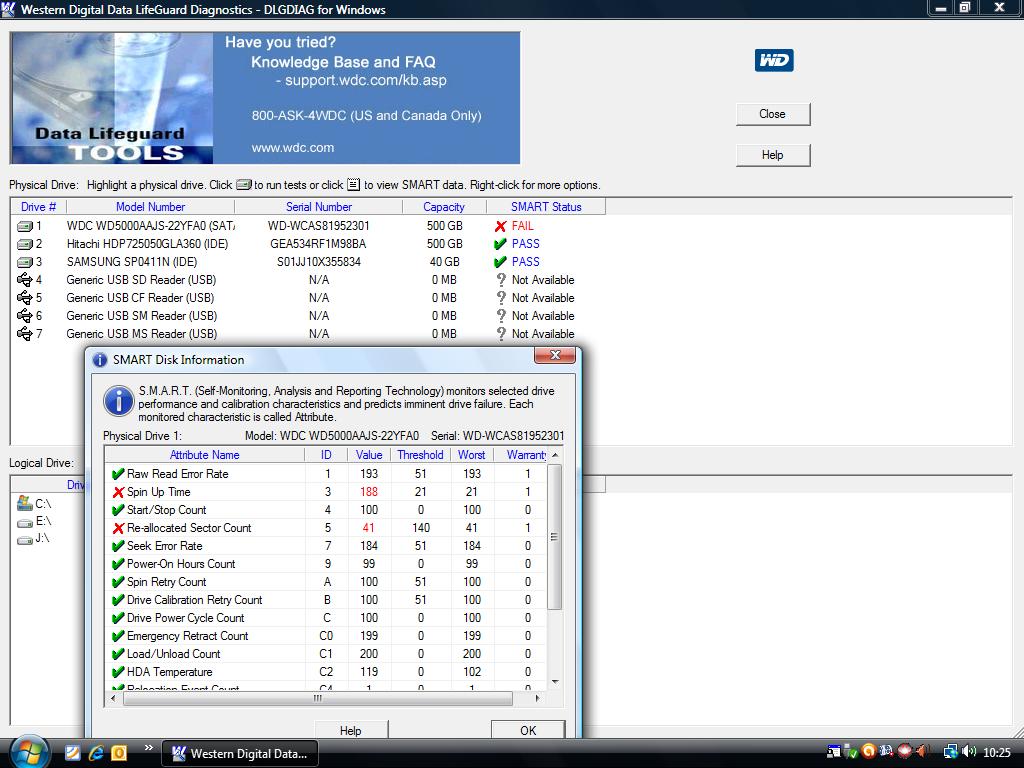

update: hi i have been able to format the disk to fat32, but the disk sometimes it crashes my pc, i have been able to take out the disk from the enclosure and connect it to the pc direct to sata. the model number of the hdd is wd500aajs. sometimes i can write files to the disk then sometimes i cant, sometimes i get a error saying 0x8007045D i/o error, i cannot format it to ntfs.
when i booted up my pc a warning came up saying that to backup up file from that disk and that the disk crash could happen. i have got the dianostics tool from western digital website and accessed the s.m.a.r.t. info PICTURE BELOW. i am currently runng a full scan of the hdd and will update as soon as its finished.
From what i have seen the disk is done! i my be wrong perhaps you could tell me if thats the case?
Thanks for the update. You've confirmed what I said before - the disk is definitely faulty - with little chance that there is anything you can try to improve the situation (other than the contact cleaning I explained before, which is unlikely to improve matters, and couldn't reset the incremented SMART counters anyway).
I doubt that the warning message used the word "crash" :) but a BIOS message warning you of likely impending drive failure is because of the SMART failure, which is confirmed by the output in your picture.
pin wrote:
i have got the dianostics tool from western digital website and accessed the s.m.a.r.t. info PICTURE BELOW. [...] From what i have seen the disk is done! i my be wrong perhaps you could tell me if thats the case?
Although that software is showing "cooked" rather than "raw" values, 2 of the pre-fail SMART parameters have dropped down to, or below, their thresholds (they are the ones marked with the red crosses). I won't waste time on hypotheses as to what the problem might be, although one problem could certainly cause both parameters to behave in this way.
It is almost certain that the drive is beyond economic repair - so unless you needed data from it (which you've explained you don't), then we're done here! Have fun :)
