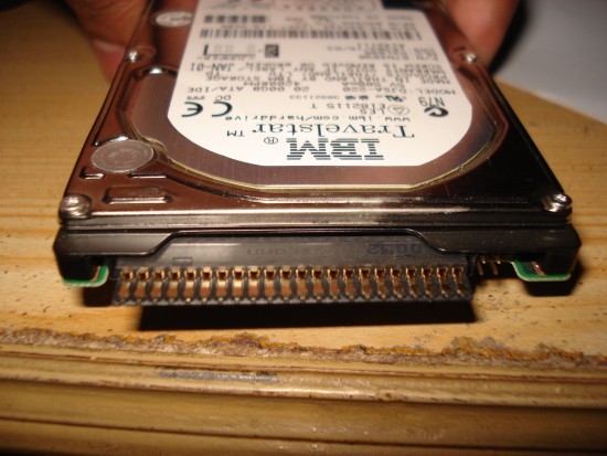

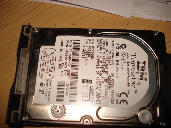

My old laptop died a few days ago and I was wondering if I can use its hard drive as a external hard disk.
Its a Travelstar DJSA-220 20GB HD, i wanted to know if there is any converter or something else that i can use to connect the driver externally to my desktop pc using a usb.
I have also attached some picture's of the hard disk that i have!
I hope you guys can help me out! :)

At first take out the adapter connected (now - visible on the photo) onto the ide hdd.
You then have a standard 44pin 2,5" ide hdd - and there are noumerous USB2.0
adapters or cases - for low budget - available out there on the market.
Try to get one with its own power supply - or if its not available, use a usb hub
with a power supply - older 2,5" hdd need more power to spin up than some
usb 2.0 ports supply.

ok so what you are saying is that there is a adapter connected onto to hard disk and that taking it off will turn it into a standard IDE hd rite?
 Post subject: Re: Can I connect a IBM 20GB DIE HDD to my PC using a usb?
PostPosted: April 12th, 2011, 10:57
Posts: 447
Location: Austria / Europe
Have a close look to the pins of the hdd as it is now.
One easily can see that these pins belong to a little adapter which
is connected on top of the ide contacts of the hdd itself.
Again, have a close look to your hdd - one can see it on the photo:
On the right side of the rear one can see the 4 pins which are not
covered by the adapter ....
Take this adapter carefully off from the hdd pins.
After doing that, you have a standard 2,5" IDE hdd
The little adapter is only to connect it to the notebook and does
not belong to the hdd.
PostPosted: April 12th, 2011, 11:10
Joined: April 12th, 2011, 7:36
Location: pakistan
I got now only thing left is to buy an adapter!
Thank you soooo much for your help! :D
