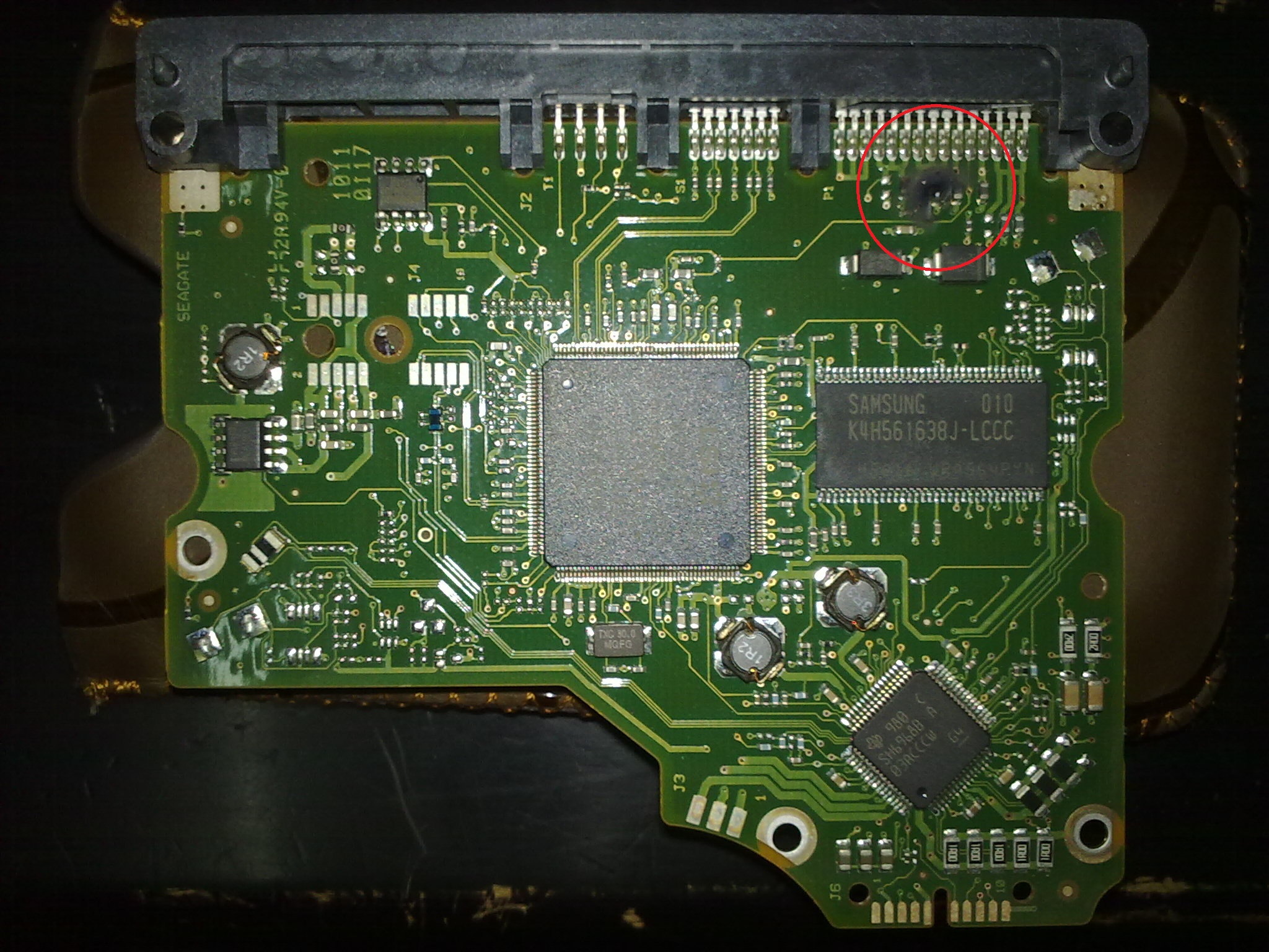

    Now See the picture of its PCB i'm attached here.
    It has some power burns obviously. But I dont think its diode thingy :roll:
    So I need a new board to take its place.
    But as we all know in seagate HDD's above 500GB capacity Boards are not interswitchable even being of same HDD capacity & firmware(according to my knowledge each firmware is fetched some production error correction data which is different for all pieces :idea: )
    So I need a new board with my old boards firmware as result.
I also wanted to know if firmware CC38 is same for all capacities of HDD or not?
PROBLEM : the main problem is I wanted to send my PCB to Canadian company to have another identical board and copy my firmware to new board(or may be desolder firmware chip from my board to new one :mrgreen: ). But most of courier companies & National Post offices denied to send my scary looking(to them) electronic chip :(
So I wanted help from you all folks here to let me know in my HDD's picture where is the firmware chip?? I'm planning to find any expert certified electronics solder person to replace it to new same looking board. So attaching new board to old drive would make it run like old times :idea: :D :D

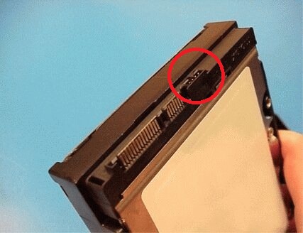

Can anybody tell me if my HDD can be turned on by communicating Serial port of PC with the marked port outlet on Attachment picture. Same issue as above applies.
I want to know if power-section-burnt HDD be turned on by serial power input?? Also want to know if data can be read through that serial interface. Seagate people say its for factory debug purposes. Which debug i want to do :)
Assumption :
the circled thing is for serial interface. I seen somewhere it has serial +ve, -ve & GND pins from its 4pins.
No, and no*.

Your drive has sustained an overvoltage on the 5V supply. Check your PSU.
As for replacing the PCB, if you are not experienced in soldering, then ask your local TV/AV repair shop. A ROM transfer should cost around US$20.
Otherwise, assuming there is no other damage, remove the 5V TVS diode with flush cutters. Clean up the burnt area with a toothbrush and isopropyl alcohol (tape head cleaner), and then replace the burnt out inductor with a wire link.
See these photo clips:
http://www.users.on.net/~fzabkar/HDD/ST ... AS_fix.jpg
http://www.users.on.net/~fzabkar/HDD/ST ... AS_TVS.jpg
Instead of replacing the inductor, it may be easier to solder a wire between the 5V SATA power pins and the striped end of the 5V diode (after removing the diode). This is marked by a "v" on the PCB.
Be sure that your power supply is OK, as doing the above will remove the overvoltage protection from the 5V supply.
Hi fzabkar!!
Thanks for teaching that. I had a doubt that why inductors get that kind of burns? Shouldnt the Protection TVS diodes got blown off?? :D
I also have read a lot about removal of 5V & 12V diodes. But I wanted
& yes it was a power spark, clearly hearable spark :| Sad thing is I plugged my HDD to back it up on my Friends PC & at that day itself this happened. Just missed a day :( He didnt have the surge protector at home.

The CC46 board should be compatible, if it is for the same model.
The flash memory chip is the 8-pin IC at the top left of your photo, adjacent to the "1011 0117" text. It should have a "25" in its part number.
See my notes:
http://www.users.on.net/~fzabkar/HDD/HDD_ICs.txt
http://www.users.on.net/~fzabkar/HDD/TVS_diodes.txt

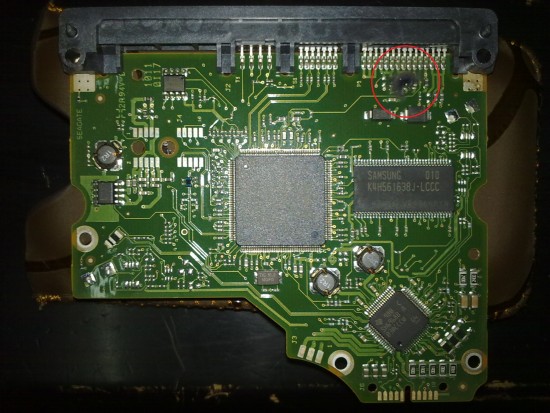

Hey wanted to let u know I got my HDD recovered. Removed that 5V Diode & after cleaning burnt area my solder person just got some solder on that half inductor to get connected :) Then fingers twisted & the HDD Spinned back after a long age :mrgreen: :lol:
Though Firmware transfer was the last way to try :roll: , this simple soldering worked :wink: & I got saved few hundred buks for new TB HDD :D

@fzabkar
Hi M8, one kind question about the other chip that is made like the EEPROM, the one at left end (in the picture on top of this thread)
Is it involved with heads? If yes, what exactly is it?

Corsari,
I can't see the part number, but I believe it would be a FETKY, ie a MOSFET and Schottky diode in the one package. It appears to be part of the switchmode DC-DC converter that supplies -5V (?) to the preamp.
My notes should help you identify it:
