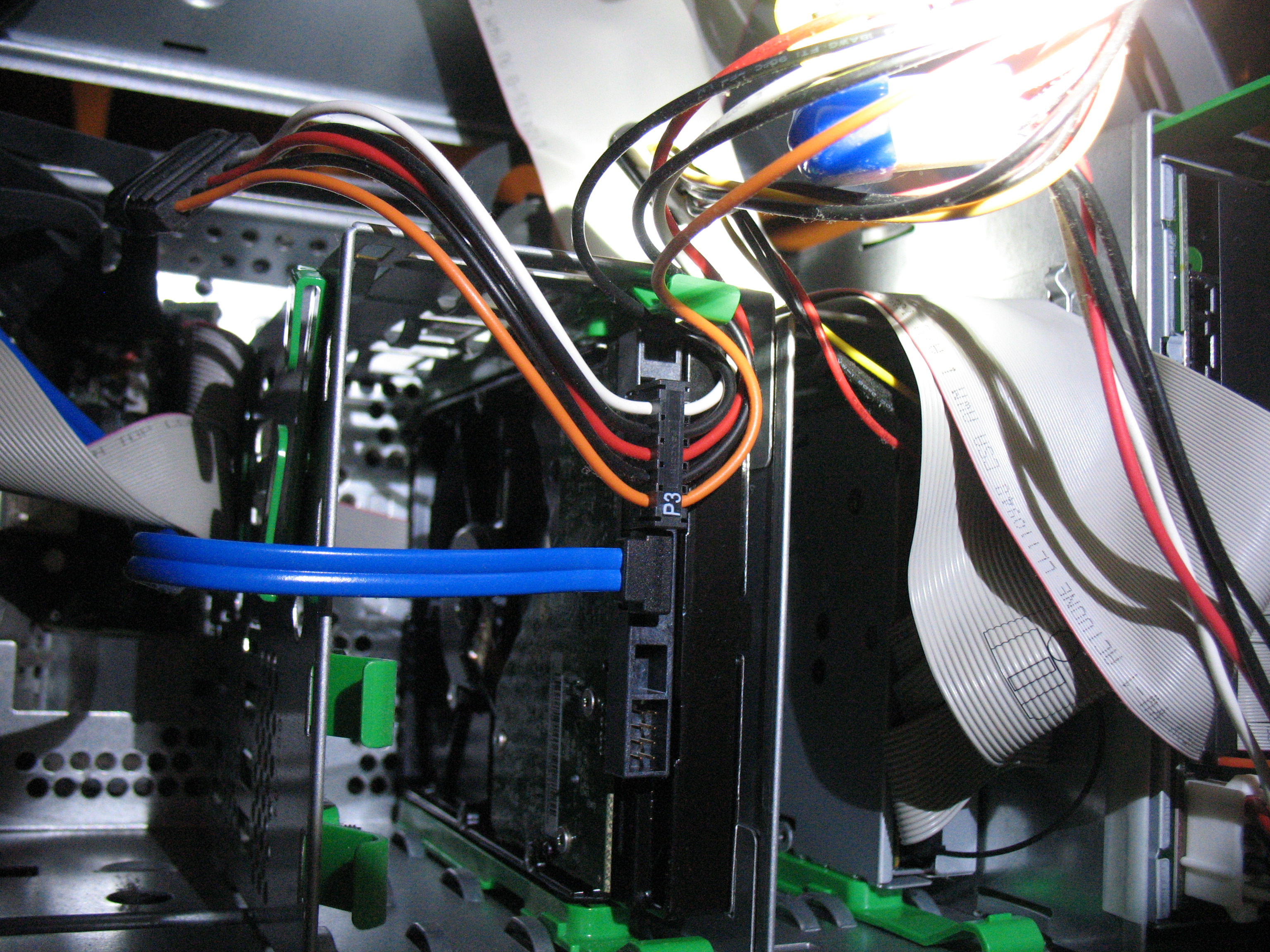

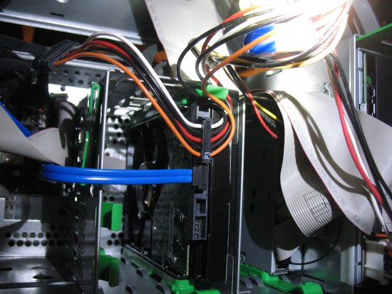

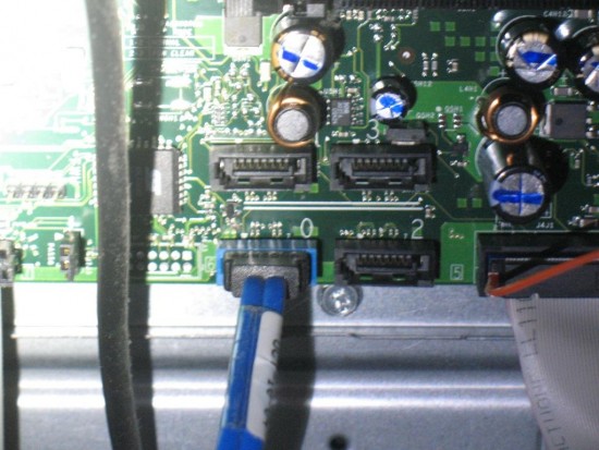

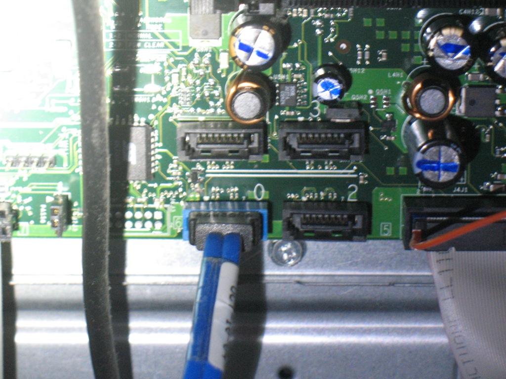

Okay, I opened the case and looked around. Are these SATA ports - the little group of 4 there?

Hmm...me last post didn't show up...think I must have posted a picture incorrectly. Trying again...this is inside my case...

I checked, and I have 3 unused SATA ports. I tried to attach a pic, but the post isn't showing. So, how do I check the BIOS configuration? And is there anyway to know if the board will plany "nicely"? I don't want to screw anything up. The pc is a Dell Dimension 8400.

yes, those are SATA ports, but what Dell said in that post is a little strange.

A SATA to ESATA bracket would be ideal. Some external ESATA drives (Vantec) come with this bracket. You can use one of the three open SATA ports but the number you use has to be turned on in the BIOS (F2 at Dell startup screen) otherwise it will give a missing drive error; F1 to continue (if i remember correctly). Once the new drive was discovered in the BIOS you may have to tell the motherboard which drive is the boot drive. Make sure your BIOS is updated to the latest version A09 on support.dell.com. The SATA controller on the motherboard is also the older 1.50Gbs speed. If you wanted to use 3.0Gbs or the newest 6.0Gbs install a cheap x1 card. Most can be purchased for as little as $20 to $30 dollars. The X1 card may also be more hot swappable than using the motherboards SATA ports. If it were my computer I would add a X1 card. Maybe even connect your Western Digital ROYL boot drive to the X1 card for increased speed.
