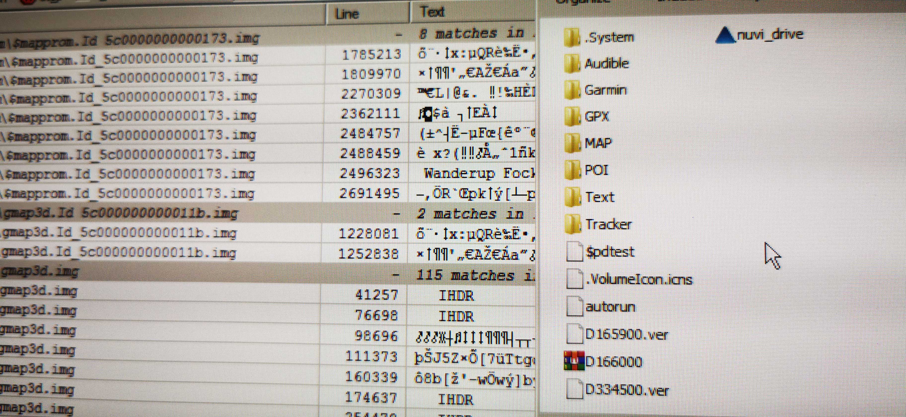

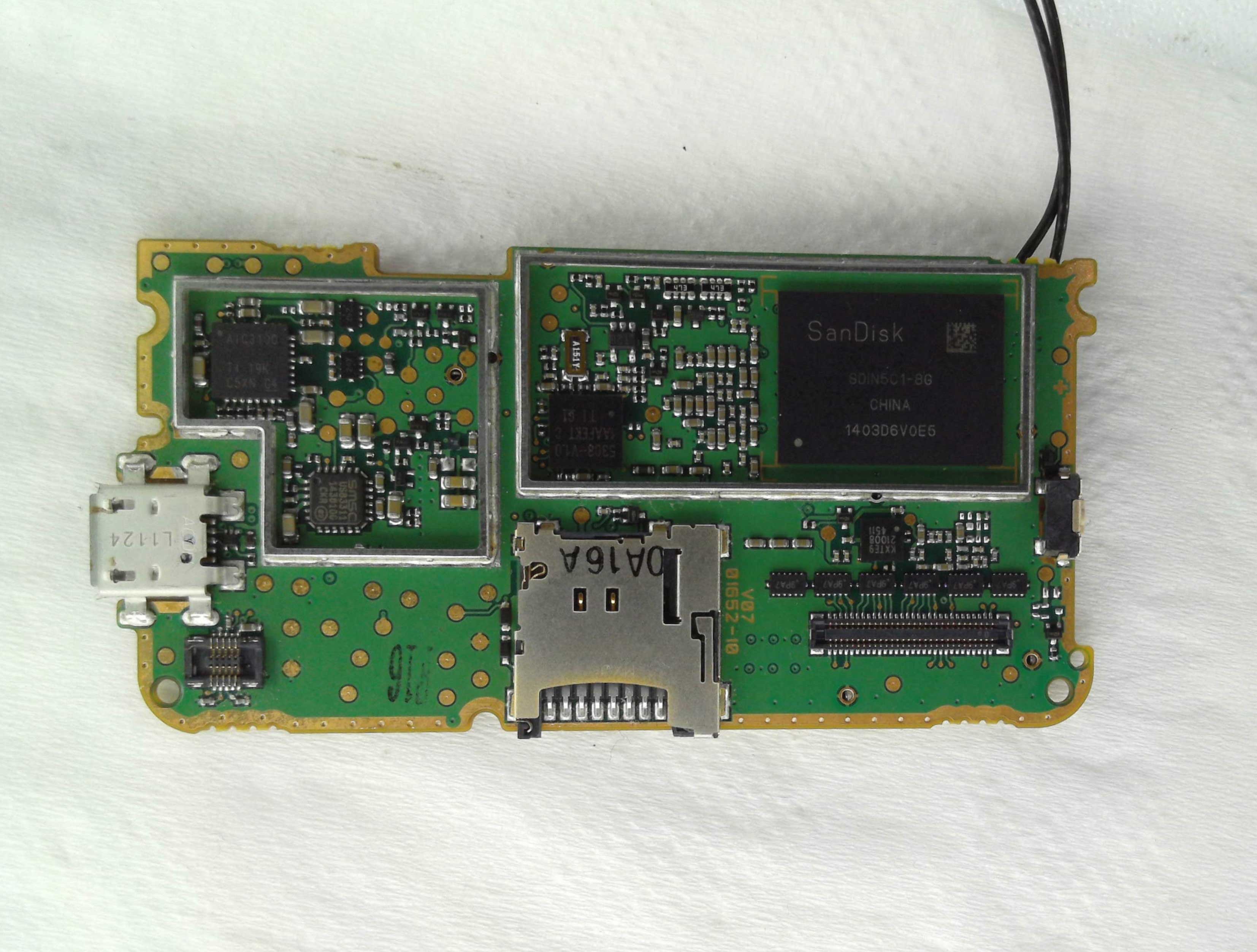

I have to admit this is one of the good cases i ever worked on..
Dead unit beyond repair, has a lot of saved info. & no backup
Took me really long time to research the FS structure
BGA-169 Sandisk 8GB SDIN5C
https://www.instagram.com/p/CvxKUOZtL2F/
:idea: :|

That NAND chip is an eMMC. If it was intact, then a straight dump would have produced a file system, I would think. :-?
There is a pinout for the 8GB version in the following circuit diagram (page 8):
http://www.friendlyelec.com.cn/dl/Schematic_NanoPC-4412_1312.pdf
This is the pinout for the 16G:
https://widora.cn/_media/zh/emmc.pdf
I have attached datasheets for the 4GB and 16GB versions.

Your research is based on a "Working Unit" the case i had was dead beyond repair, so chip-off & the research is your only friend
by having a look @the Sandisk BGA169 (make another research) needs some custom reading/dumping method
Then the story begins with decoding the NAND image and extracting its FS structure
FYI, its 8GB NAND. the 1st. 4GB is the OS FS and the other half is the user DATA (been mounted by MTP) <<------- in order to mount you need to decode 1st. part
Thats why it took me long time to research

Hi, have a look here for example: https://multi-recovery.com/subpages/MRTYPE7.php used for this Sandisk NAND
My Case Sandisk BGA-169 needs special reading setting/methods (similar to this Adapter) to have a proper reading (since you are in Flash DR field you know this already Others just keep talking, No tools No experience equipped with a PC+Internet & Browser to search and post results here )
what am saying in short that It took me some time to figure out something similar to this adapter solution which does the same job (longer path but same destination)
after many failed attempts got succeeded. 1 month, 50 times is a figure of speech not very important i think
