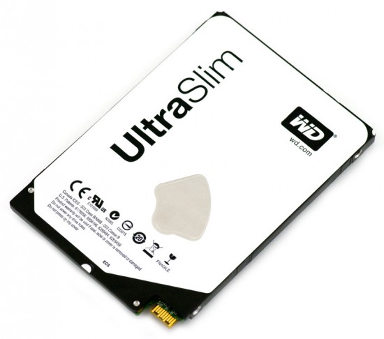

please advice
any connector for convertor for this hdd, how to conect with sata port

SFF-8784 to SATA would be the keyword and something like this:
https://www.amazon.com/UltraSlim-WD5000 ... B0161EB8U4
