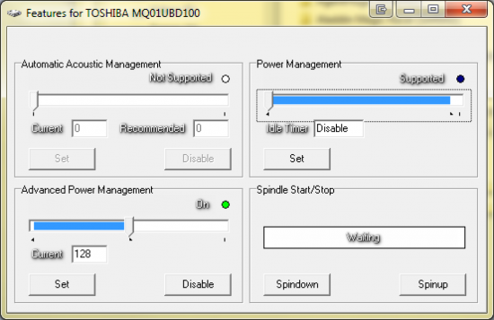

And the IDE Features dialog-box, screenshot enclosed herewith,
File comment: Rev 0001 HDDScan v3.1 IDE Features Screenshot (Before Idle)
for each drive shows Automatic Acoustic Management as Not Supported (white circle), with the options and numbers greyed out; Power Management is Supported (navy blue cricle), with the idle timer set all the way to the left at Disable; and Advanced Power Management is set to On (green circle) with the current value set to 128 - the ticker is in the middle. Spindown and Spinup buttons seem fully functional, taking about 2 and 4 seconds to process on average.

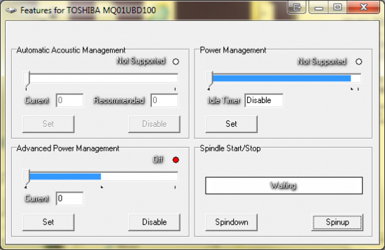

And now the IDE Features for Rev 0001 vary from what was originally stated; Power Management is Not Supported (white circle), though the button is not greyed out, and Advanced Power Management is Off (red circle) with the current value set to 0; screenshot enclosed herewith.
File comment: Rev 0001 HDDScan v3.1 IDE Features Screenshot (After Idle)
But, if I then take a large file from Rev 0001 and copy and paste it to one of my local drives, even though the operating light was already on, I suddenly hear the drive spinning-up and the light begins blinking rapidly while the transfer occurs. And if I generate the reports that had moments before produced duds, I now get full reports as I did when the drive was first plugged in, with even the IDE Features dialog-box reporting the original values. Strange, but reproducible exactly as described above.
