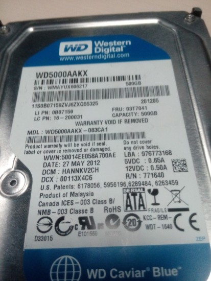

Hi, Spildit, Thanks very much for your kind help and guide. I'm not sure about the type of my drive WD5000AAKX-083CA. Here are the detailed parameters of my drive, http://www.wdc.com/global/products/specs/?driveID=896&language=1. It seems the drive is SATA. And this is its picture.

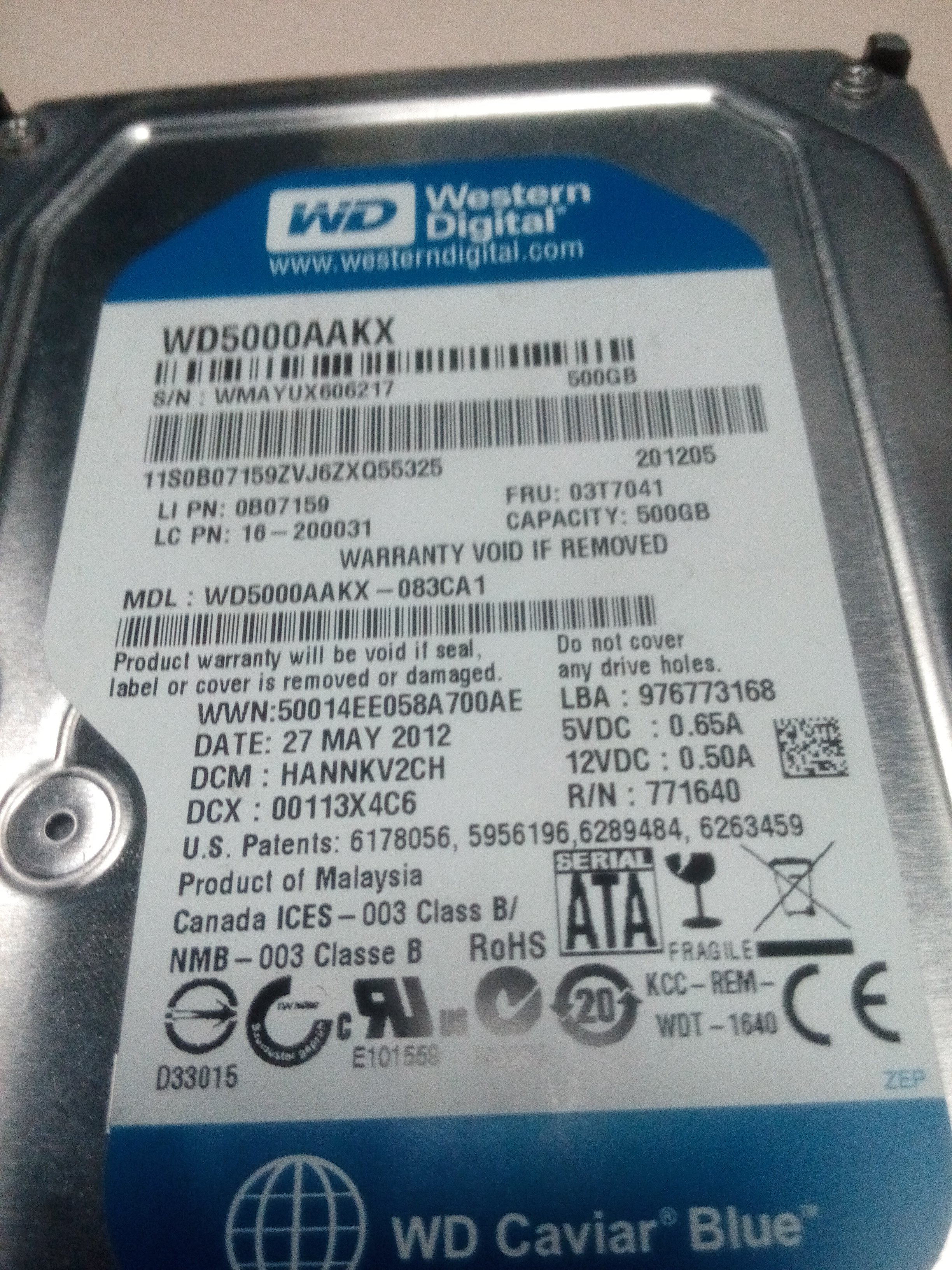

Upsss ...
The above post is for SATA/IDE drives.
I think your drive is a SCSI so the mentioned tools will not work on your drive ...
Thanks for you kind help and guide. I'm not sure about the type of my drive WD5000AAKX-083CA. But here are the detailed parameters of this drive.http://www.wdc.com/global/products/specs/?driveID=896&language=1. It seems that its type is SATA.
