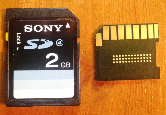

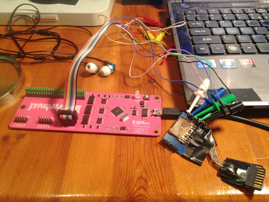

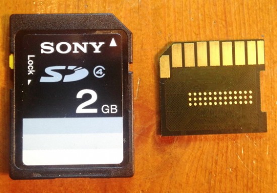

Motivated by the research above, I thought I might test out my JTagulator on an SD card.
This particular card is a 2GB Sony Class 4. The controller appears to be made by Phison, a PS2233 or something close. The NAND ID is 0x98 0xD5 0x94 0x32 and the part number is likely HVPE4F4. I have seen the manufacturer of these to be listed in vatious places as both Toshiba and Hynix, and also Samsung. I don't know which it is.

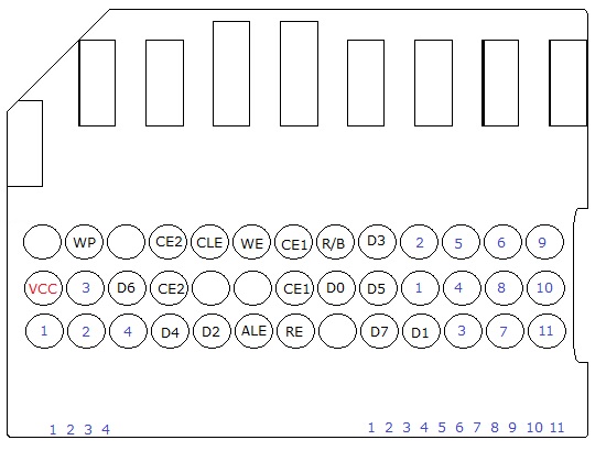

I noticed that after the coating was removed, there were 2 sets of traces leading to the edge of the card. I was thinking test point or programming points.

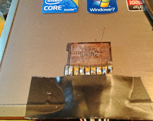

The wires were too fragile so I made up a board to hold it, and also extension made from a sd-microsd adapter so I could insert it in my laptop still while analysing.

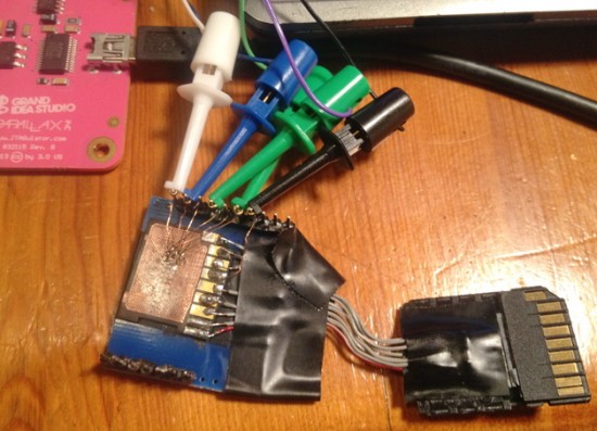

Here is the whole setup.
