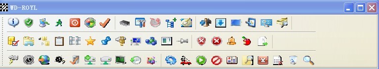

I have a full version of WDR. But i can't find where to find this info.

Spildit wrote:
WhitePP wrote:
Spildit wrote:
Yes, WDR provides the info that you are looking for, but you need a full version, not the DEMO.
Try to right click on the window :)
Thanks, Spildit. I have a hard drive WDC 1600BEVT-22ZCT0. And here is the info of Reserved Region Table.
