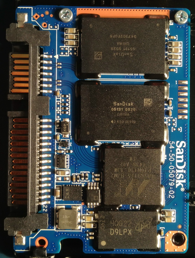

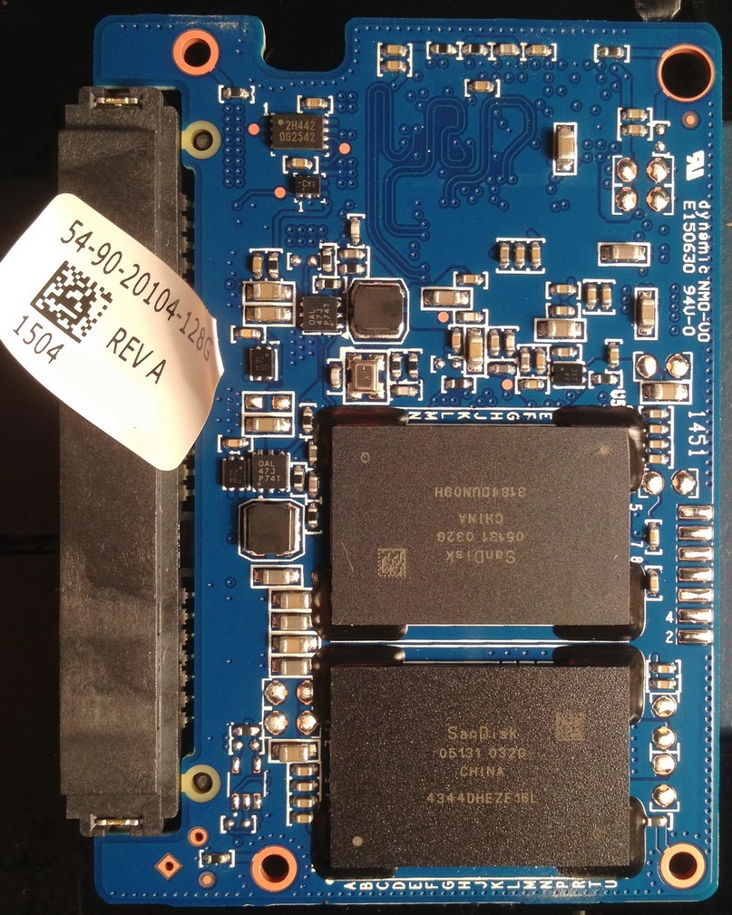

On the board there is a 7pin unpopulated row of pins, and a couple of Test Point looking pads, but al in all, not much.
Chips are held secure with black epoxy, I assume to stop the BGA's from lifting, which is fairly common in other devices.. macbooks, Xboxe 360's etc. This makes it harder for us a little as well.
