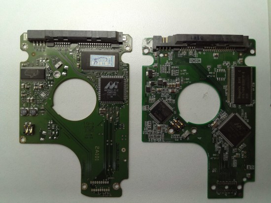

Hello guys,
I was wondering for the last few days about this Question here which is: Why is WD PCB`s repairable (at least some of them) & Samsung is NOT?
both share the same MCU (for some cases)...
anyone worked on those or tried?
:wink: :idea: :idea:

Very strange question/observation ...
Can you show us one example where WD and Samsung use the same MCU? I had assumed, perhaps incorrectly, that each MCU was specially designed for each customer.
What do you mean by "repairable"? Clearly your understanding of the word differs from the rest of us.

look here @this image, MCU`s are 88ixxxx
WD: 701499 - 88i6745N
Sam: 00249B - 88i8823
In both no ROM chip
Before in this WD pcb there was a way to remove few resisters (can`t remember sure not) and you solder a ROM chip and go on
now in 3k (using terminal no need to solder anything)
hope its clear now.
thank you

@einstein9, something got lost in the translation. By "same", I took you to mean "same IC", not "same IC manufacturer".
In any case, IIUC, HDD manufacturers would be involved in designing the specification for Marvell's SoCs, presumably by selecting cores and peripherals from Marvell's library of components. In other words, I suspect that MCUs are custom parts, assembled from standard components, as specified by the HDD manufacturer. I doubt that Marvell produces general off-the-shelf products for the HDD industry, at least not in the past 10 years.

Anyway, as i was saying here, about WD for example 3k terminal is able to communicate with the MCU directly through terminal and write ROM back and ur done
if WD is able to do it why samsung is not? (both share the same MCU) thats what am working on now....
some part of the MCU memory (maybe) is reserved for the ROM and if they figured it for WD why not Samsung?
