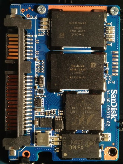

Vendor: Sandisk
Model: Ultra Plus SDSSDHP-128G
Type: SSD
capacity: 128GB
Interface: 6Gb/s SATA
Condition: New
Controller: Marvell 88SS9175-BJM2 (code-name Van Gogh Lite)
NAND chips: 4x 19nm MLC
NAND Vendor: Sandisk
NAND Laser code:0531 032G

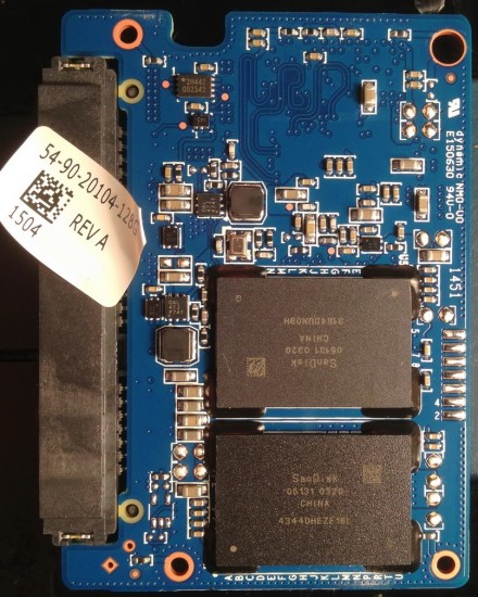

On the board there is a 7pin unpopulated row of pins, and a couple of Test Point looking pads, but al in all, not much.

Chips are held secure with black epoxy, I assume to stop the BGA's from lifting, which is fairly common in other devices.. macbooks, Xboxe 360's etc. This makes it harder for us a little as well.
