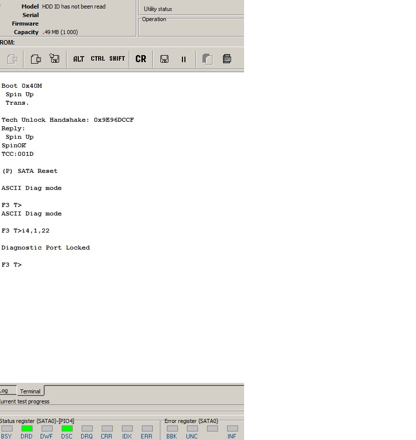

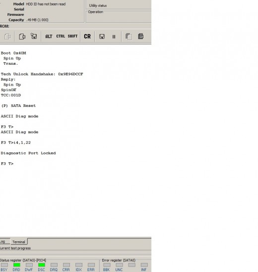

Humm,
I just tried the Option with one of NEW Drives (Grenada)
and my drive is BSY STATE now And very very slow
I did as it says and finally
Good Luck :shock:

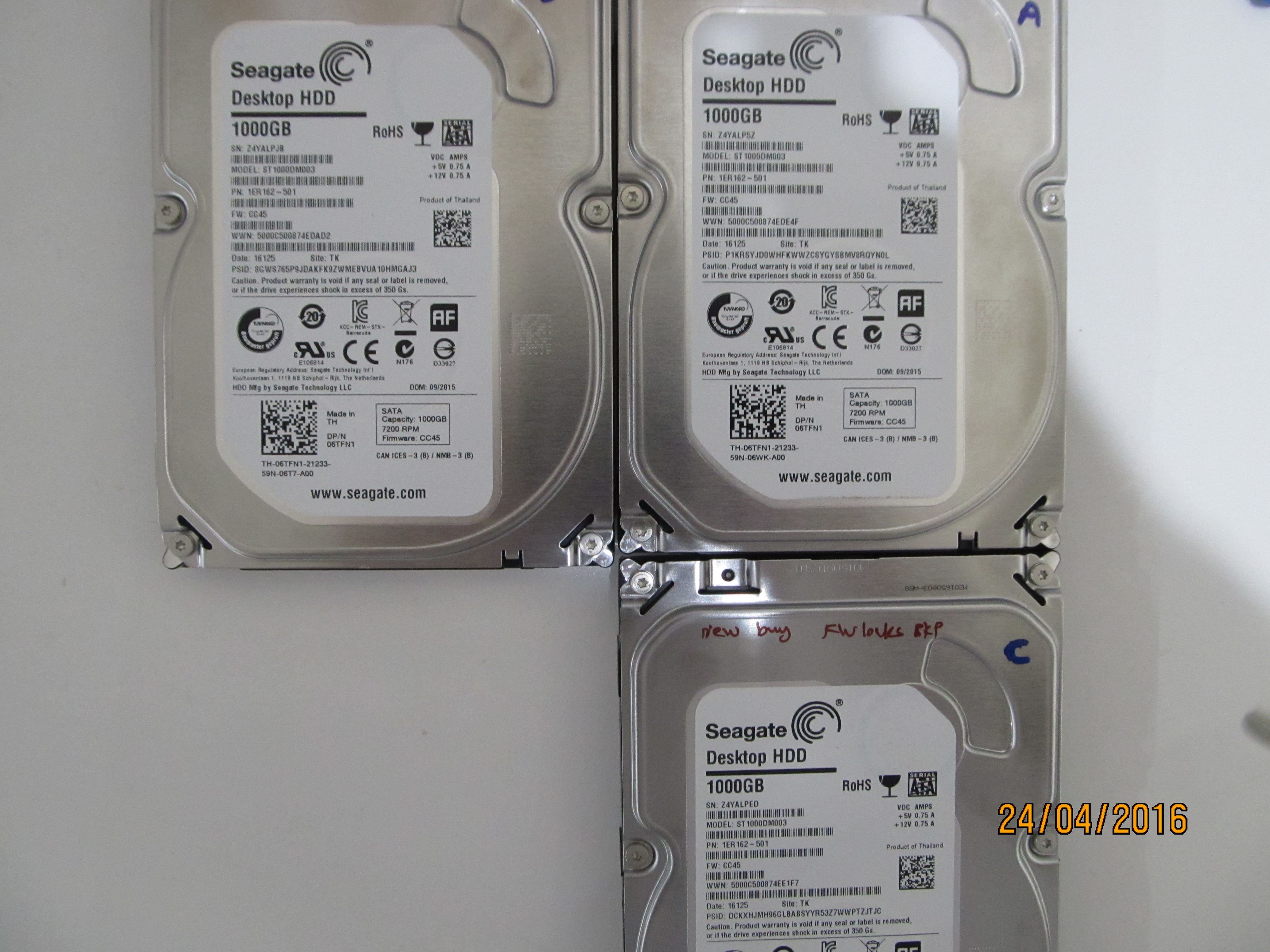

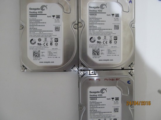

And here is Attached my 3 TESTING DONORS - BRAND NEW
ST1000DM003 Z4YALP5Z
ST1000DM003 Z4YALPJB
ST1000DM003 Z4YALPED
I dont think there will be a Match better than this. (Dead one is the Last)

Just keeping this thread alive
Are there any solutions To Diagnostic Port Locked on later Seagate drives
(different to the other short read channel techniques on some older ones)
