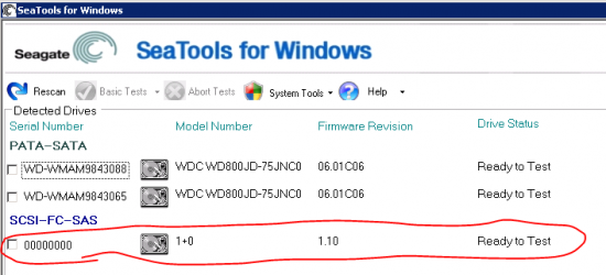

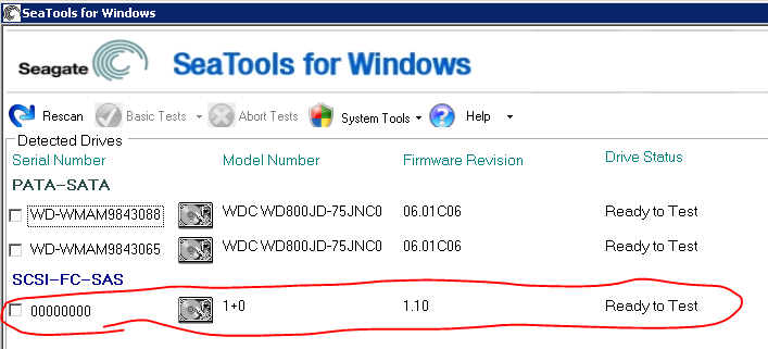

Yes - I tried this SeaTools for Windows. It actually sees the drive - but not as Seagate, but rather as JBOD. It actually allow me to use Advanced options, but when I select Firmware Download - it starts it, but never actually finish. Just hanging...

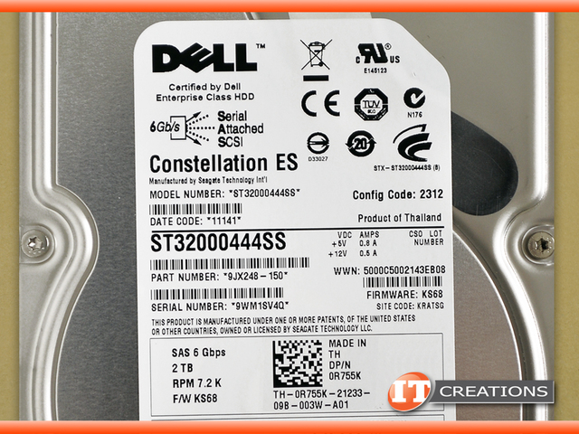

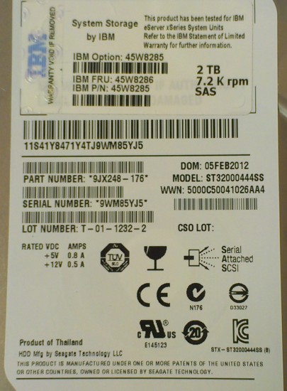

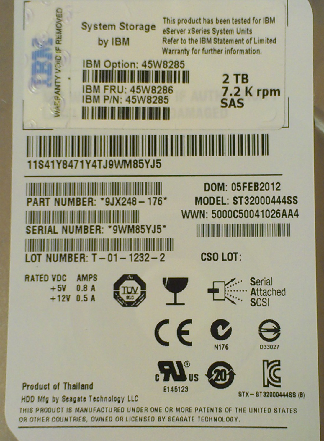

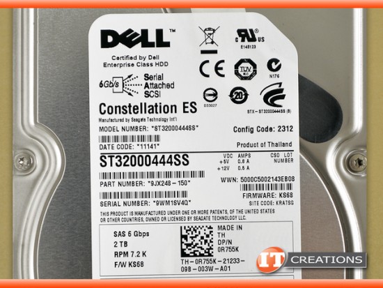

Hello! And I have a similar issue too.
I have several HDDs from IBM System Storage, SEAGATE ST32000444SS and DELL MD3200 Storage. Photo attached.
Dell MD3200 Support Matrix contains this Seagete HDD, but with P/N R755K.
If I put drive into storage, it marks as "Unsupported":
http://en.community.dell.com/support-fo ... 51400.aspx
Is it possible to put DELL firmware into these drives to make them work with MD3200? And does anybody have this firmware here? Please, help.
Thanks!
