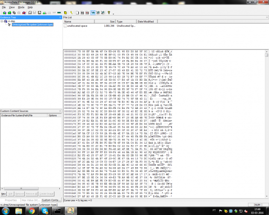

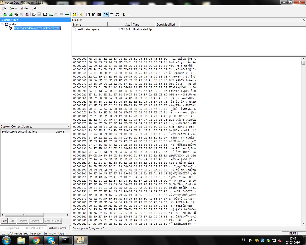

After dumping the contents of the chip, I open the image file in FTK imager:

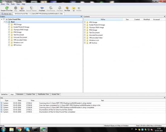

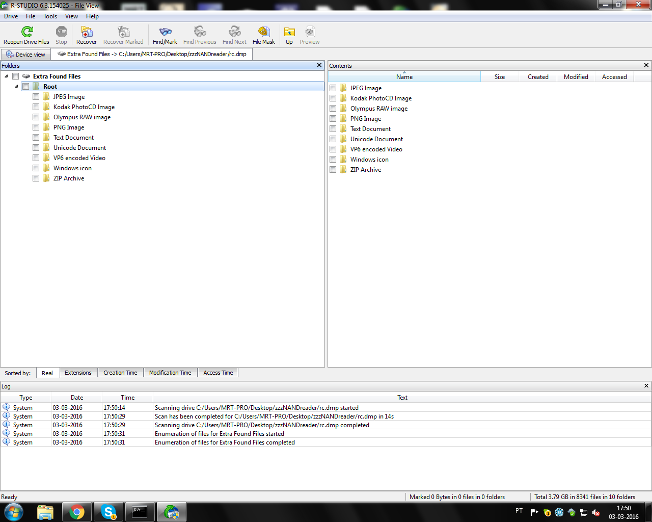

I see that data is there, but no FS is recognized, and i try to carve it trough R-STUDIO:
Even though it finds files, they can't be opened, and so far the best results I had were from an 2007 MP3 player, wich I've managed to see all the musics that used to be there, and even play some bits of them.
you wasting your time, programs like that in not designed to handle the structure of flash.
of course not

 Post subject: Re: NAND READING VIA FTDI2232H
PostPosted: March 3rd, 2016, 16:15
Posts: 17328
The OP is not trying to reinvent the wheel. Obviously there is a fundamental lack of understanding of flash structures, despite the fact that the OP has an expensive professional tool. I would want the tool to be an extension of my intellect, not a substitute for it. How many in the DR profession actually understand the technologies that they work with?
My approach would be to use a relatively simple case as a learning example. I found an earlier industrial knitting machine thread to be very educational in this regard. If I were embarking on a career in data recovery, I would want to be much more than a mere ROM jockey and head swap mechanic.
You need to examine the spare area (OOB). Can you upload the first 20KB of the dump?

Here is a link to a sample of the dump, and the full dump.
password is: hddguru
http://cloud.g3t-server.com/owncloud/in ... tJtCLjce8k
PostPosted: March 4th, 2016, 10:36
Data recovered :-)
Do you want the data uploading?
PostPosted: March 7th, 2016, 10:57
Posts: 413
Update: Sean was kind enough to repair the ecc on the dump and retrieved the files.
The best part is that this flash drive is from one of my best friends, and tonight I will troll him and ask why he has a amateur porn video close to her granny photos :x
