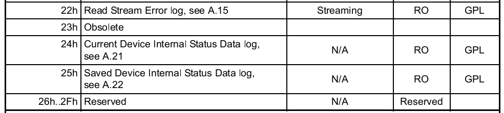

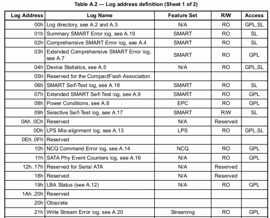

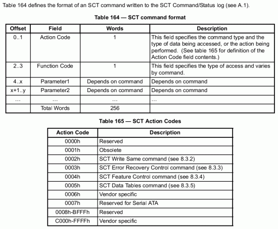

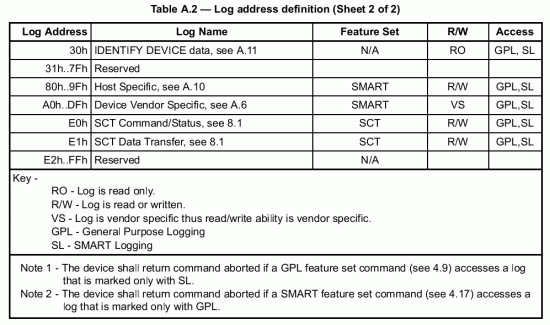

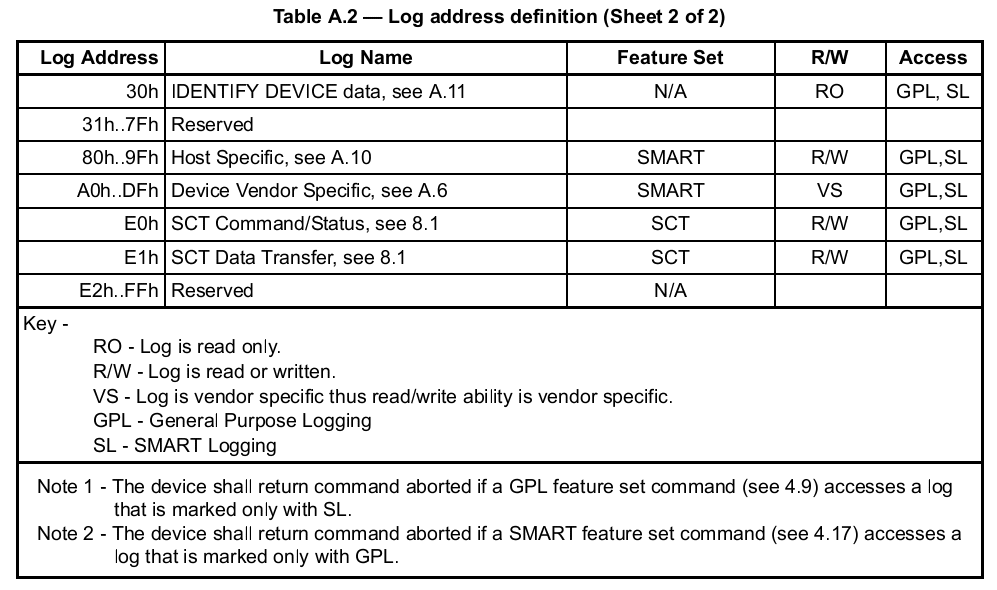

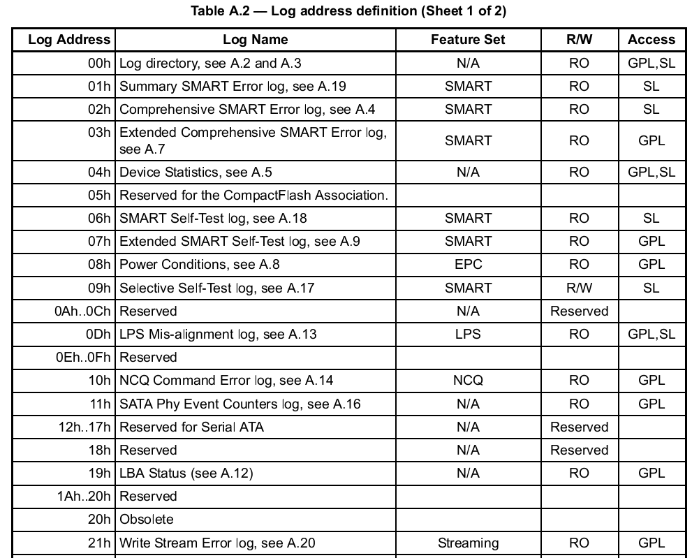

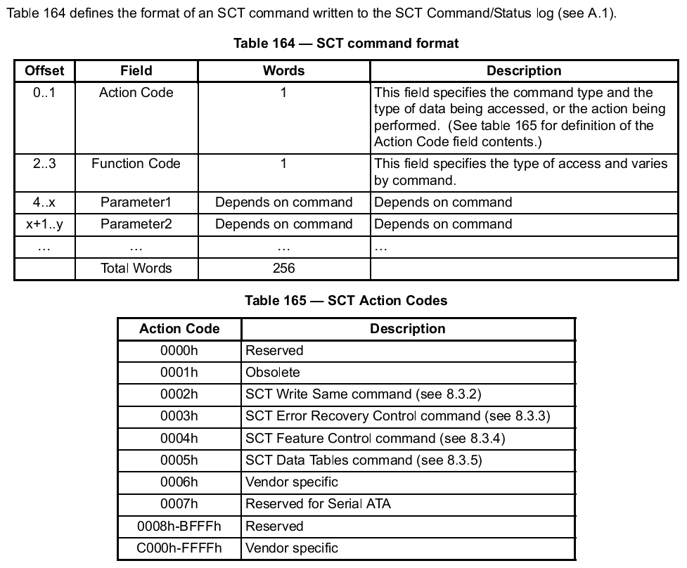

@BGman, I confess I was confused in regard to the meaning of SCT. Thanks for the clarification.
Table A.2 in the ATA standard distinguishes between SMART and SCT feature sets. AIUI, Seagate and WD use the SMART feature set to transport commands and data via vendor specific logs BEh and BFh. The SCT feature set uses standard E0h and E1h logs, although these can themselves transport vendor specific Action Codes.

The confusion in my case is due to the fact that, while WD uses the SMART feature set, WD's vendor specific command format in log BEh is identical to that used in SCT command/status log E0h (ie Action Code + Function Code + parameter list).
Just to add to the confusion, various documents from t13.org refer to the "SCT Command Transport feature set" and "SMART Command Transport (SCT)". The first is not strictly logical.
