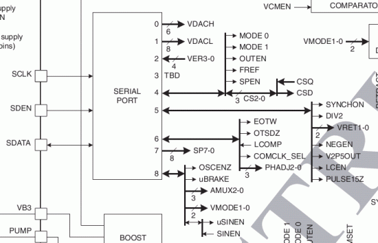

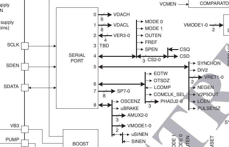

I don't have an answer for you, but perhaps some insight might be gained from the following datasheet:
SSI 32H6910 12V VCM/Spindle Driver:
http://web.archive.org/web/20100613121613/http://www.sluzhebka.com/DataSheet/DataSheets%20TI%20%2B%20SSI.PDF
Clearly the above chip is not directly relevant to your question (the PES is generated within the MCU, not the motor controller), but its datasheet may have similar AMUX (Analog Multiplexer) circuitry.

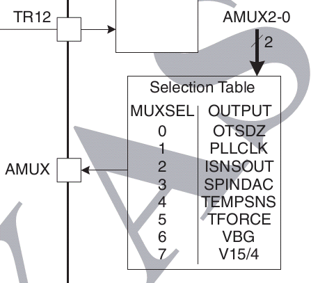

ANALOG MULTIPLEXER - To provide test visibility into internal analog signals, the AMUX pin is used to multiplex various internal analog signals. Table 9 defines the output signals for each state. In normal operation, AMUX must be set to 000 (OTSDZ) or 001 (PLLCLK). Other positions are for production test and chip evaluation only.
In the above example, AMUX is an analogue pin which enables of 1 of 8 internal analogue signals to be viewed externally. The required signal is selected via the motor controller's serial comms port by way of the AMUX2-0 bits. The multiplexer is akin to a single pole, 8-position analogue switch. This obviates the need for each signal to have its own separate pin.
In your case the PES could be one of two or more internal signals of the MCU which could be accessible or viewable via the MCU's AMUX pin. I suspect that you may be able to narrow down the prospective candidates by determining which pins look like they may be analogue rather than digital.

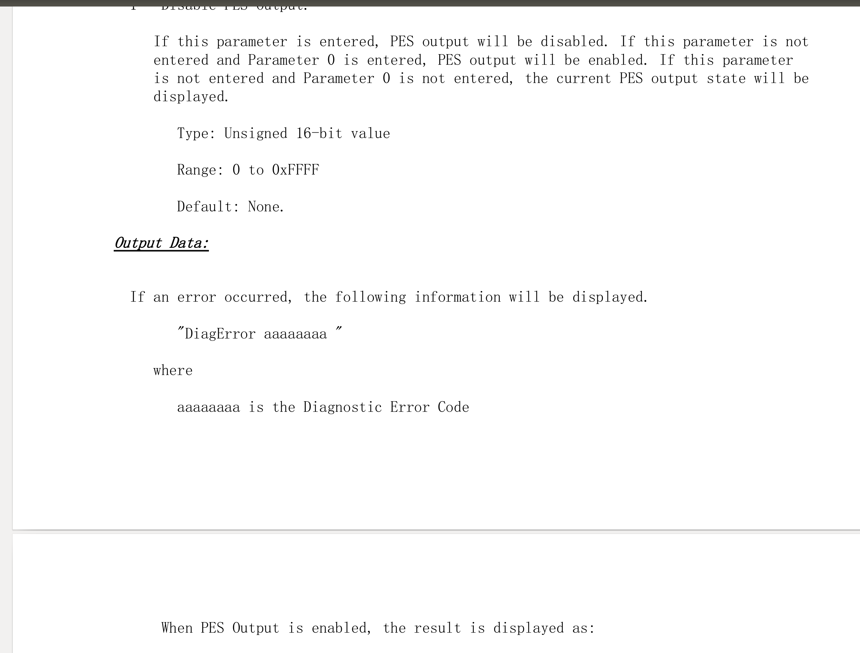

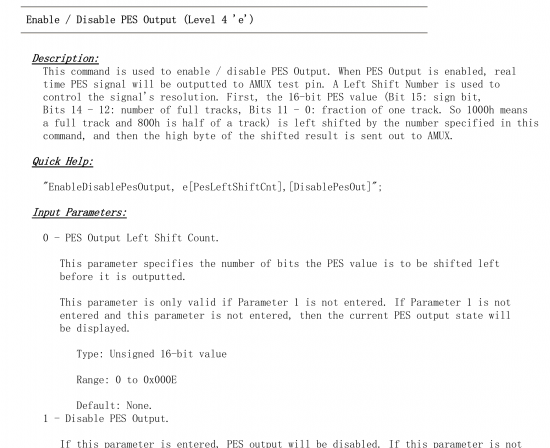

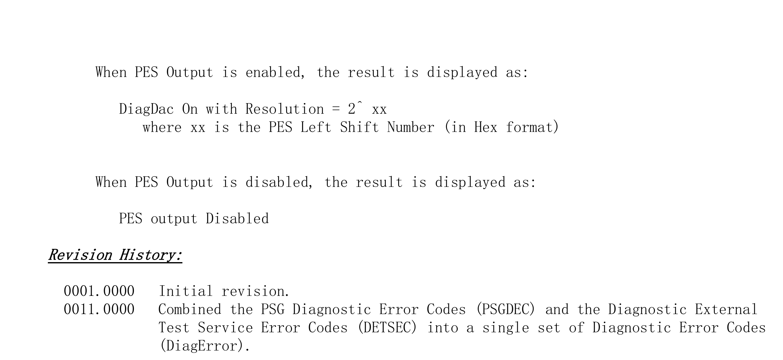

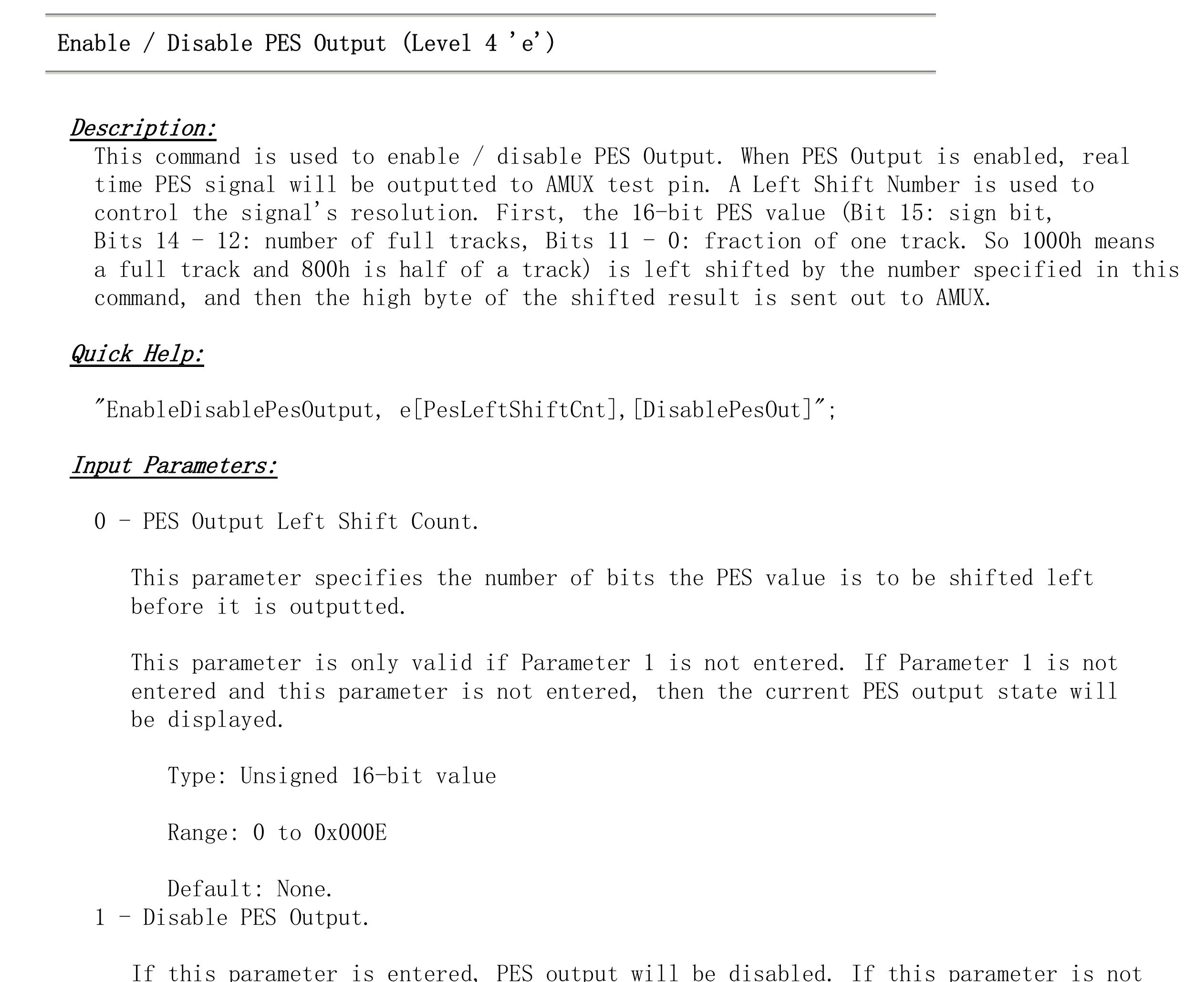

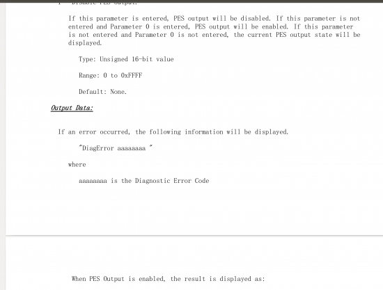

Thank you, that was very helpful! You can see from the attachments, however, that the PES is output as an 8-bit digital signal, not analog.
Based off the wording of the doc, it sounds like the AMUX is being used solely for PES? I am going to tap the MCU's pins and identify the AMUX by viewing how the signals change as I toggle the PES output on and off. It looks like I'm going to have to order a custom probing adapter from http://www.ironwoodelectronics.com/prod ... pters.cfm# , since they don't have 0.4mm pitch(MCU is the LSI B5502D0, which is a 176 pin 0.4mm pitch QFP), which will take some time. I'll report back what I find.

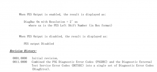

"DiagDac On with Resolution = 2^xx" would suggest that the output is being generated by a digital-to-analogue converter, and that the PES voltage is being scaled to fit within the DAC's range.
The DAC appears to have an 8-bit resolution:
"... the high byte of the shifted result is sent out to AMUX"
AIUI, this is the layout of the 16-bit PES:
sign   num tracks    partial track
| 15 | 14 : 13 : 12 | 11 : 10 :  9 :        : 0 |
+/-    4    2    1   1/2  1/4  1/8
Let's say that the PES has a low value, eg ...
| 0  |  0 0 0  |  0 1 0 1 0 1 1 0 x x x x  |
|    high byte to DAC    |   ignored       |
In this case the PES will only have an effective resolution of 3 bits. We can scale up the PES by shifting it left by 4 bits.
| 0  |  1 0 1  |  0 1 1 0 x x x x 0 0 0 0  |
ICBW, but that's how I understand the docs.

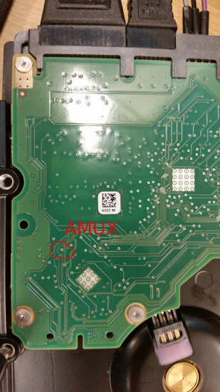

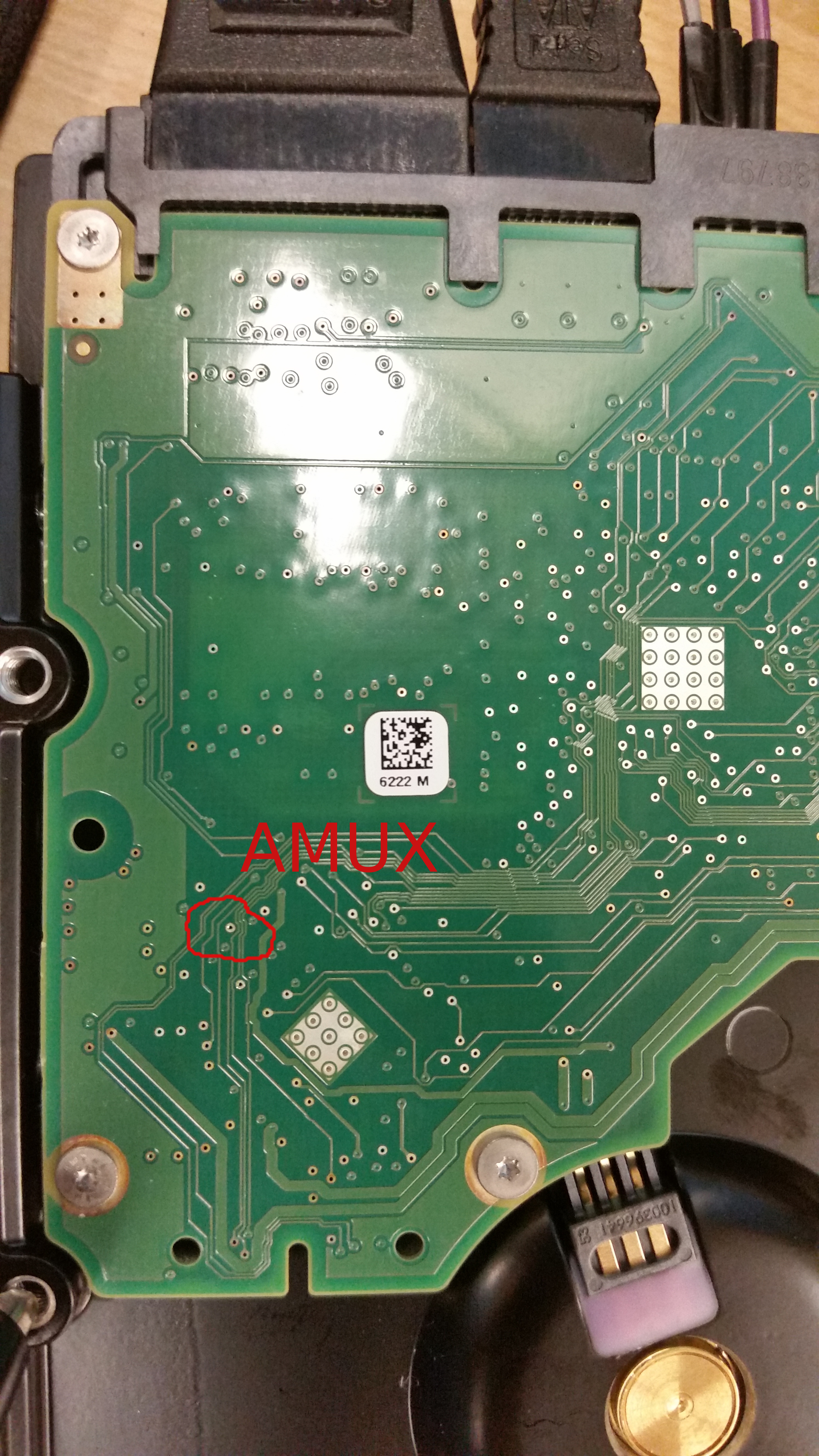

I'm nearly positive that is the AMUX pin for the Barracuda 7200.12 1 TB disk. If I turn on PES output, the output of that via becomes a 34khz step function, which is exactly what I'd expect given 0x11f servo sectors and 7200 RPM. Unfortunately, a few minutes later I accidentally pulled off my oscilloscope's clip and it somehow shorted the drive as it dragged across the board; now it won't even spin up. I ordered 2 more drives of the same model, and will confirm my findings on those once I receive them.
One interesting note: that via is connected to a pin on the spindle controller, and not the MCU. Do you know why that could be? Perhaps the spindle controller uses the PES signal to determine the spindle's rotational velocity?

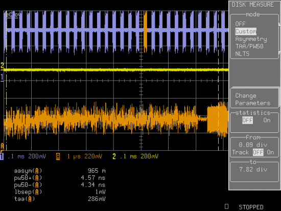

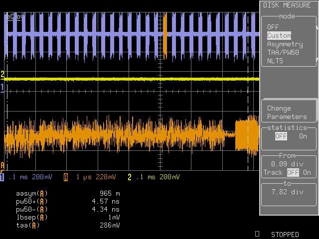

If u want Servo trace from a actual drive here u go, not sure if its what are u looking for
How Are You Beto ,Which Scope Is this Bro
