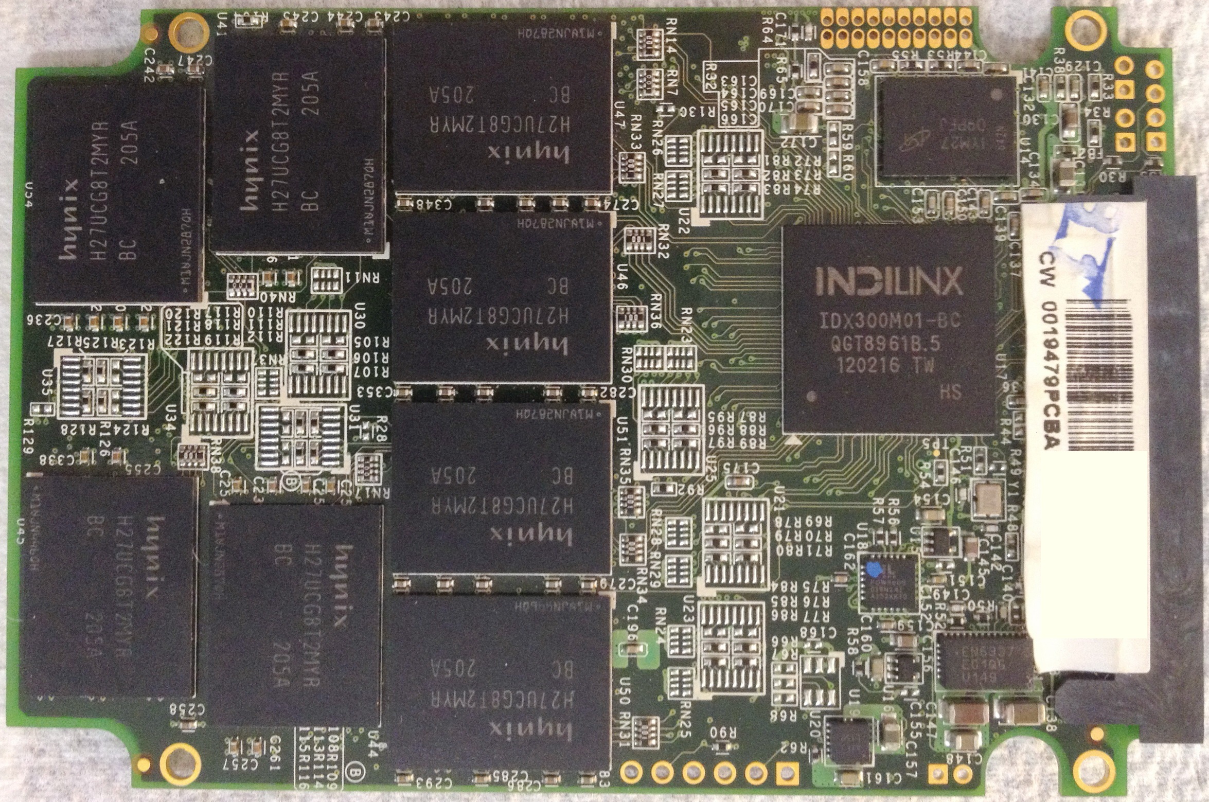

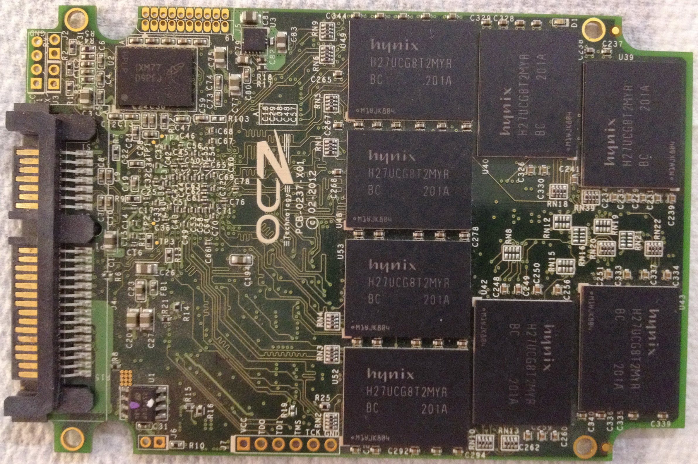

This SSD seems to be bricked, now it is for research. I didn't get the cover with the board, so I don't know what the model was. In this thread I will post anything interesting I find. I hope to include things like:
- Console access
- JTAG, hooking up, output etc
- Firmware update, RE, tricks, tips
- Possibility of NAND chip off recovery
- Wear levelling/ECC/data Structures etc
- anything interesting
Feel free to add anything you might know or find out, or any comments, criticism etc. All I ask Is the thread stays on topic to this research.
Vendor: OCZ
Model: Unknown (OCZ Octane? http://www.playwares.com/xe/power_hdd/23075600
Type: SSD
capacity: Unknown (128GB?)
Interface: SATA
Manufactured: Around 2012
Condition: Not Working
Controller: Indilinx IDX300M01-BC
NAND chips: 16x 8GB
NAND Vendor: Hynix
NAND Laser code:H27UCG8T2MR
NAND ID: ad de 94 d2

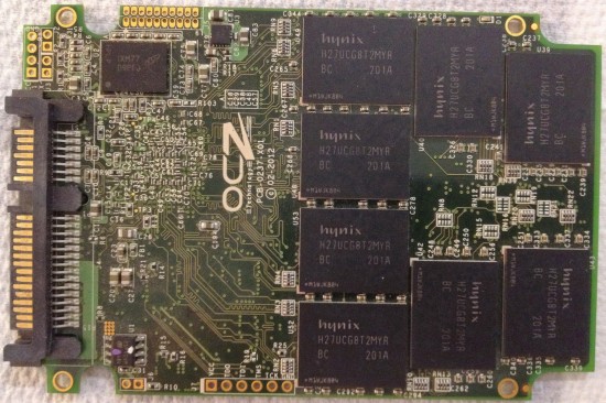

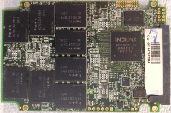

On the board, a serial port is clearly marked with VCC TX RX and GND. I got Minimal output on a serial test with Putty using BAUD Rate 115200 and shorting J3 1-2
sata_task started: S= DRIVE_IDLE_STATE
drive state: DRIVE_SEND_ERROR_STATUS_STATE
The other unpopulated 10pin block, J10 I don't know what it is.
JTAG port is clearly marked with VCC, TDO, TDI, TMS, TCK and GND. I will test this soon. There are Test points on the board, TP1 - TP4 etc. Not sure if these are useful.

Maybe your problem is on the U20 IC or the U1 (this one get's burned on many of the boards).
U20 seem like a QFA-16 but i cant read the code on it.
Could you tell what's writen on them?
 Post subject: Re: SSD Research - OCZ SSD
PostPosted: January 17th, 2018, 9:42
Posts: 3929
Thanks for the replies. I haven't had time to re-visit these but will soon.
U1 is made by ST and is marked: 25P40VP
U20 is marked:
AJFJ
L150
PostPosted: January 17th, 2018, 16:40
Posts: 17097
EP53A8LQI, Enpirion/Altera, PowerSoC, Voltage Mode Synchronous PWM Buck with Integrated Inductor, 1A, Vin = 2.4V - 5.5V, marking AJxx, QFN-16:
https://www.altera.com/content/dam/alte ... _03651.pdf
M25P40VP is a 4Mbit (512K x 8) Serial Flash memory.
