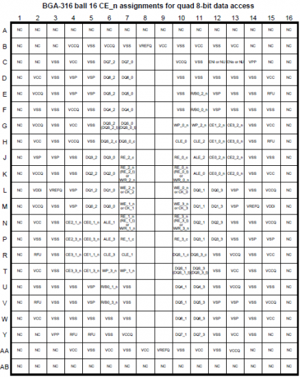

I finally found cheap JTAG adapters that you can use to interface with the Samsung SSDs: Search for "Altera USB Blaster". All the other adapters I tried did not work.
I have measured the voltages and connectivity applied to the BGA Flash chips by a slightly different PCB, which uses the same controller chip, and has the same BGA pattern:
http://www2.futureware.at/~philipp/ssd/ ... Pinout.pdf
Theoretically I could design an adapter board for it, would anyone be interested in it?
As usual, I updated my documentation.

What do the 12V pins do?

Is the Package BGA-316 ?

cant edit post now...
It is in the JEDEC standard. VPP 12v-24v. Chips can use internal or common shared external boost converter for programming.
Thanks, I thought that might have been the case, but it seemed like a retrograde step as this is how it was done more than 20 years ago.

Posts: 3975
I am not going to pretend I know the science, but regular chips use charge pumps internally and a lot of charge is used up by the pumps themselves. As these new chips are more like 16 or 32 chips daisy chained together it is a lot of wasted power, so it is a way of boosting to program votage with a single boost.
Not sure if readers are configurable enough in software/firmware or new hardware design is needed. I have most faith in VNR reader as that already has seperate i/o core voltage and has been able to be configured with firmware updates. possibly a different shield may be all thats needed.
