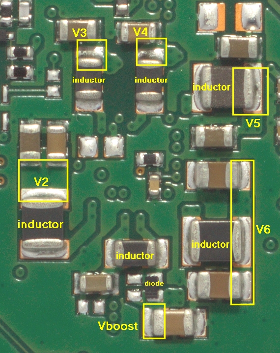

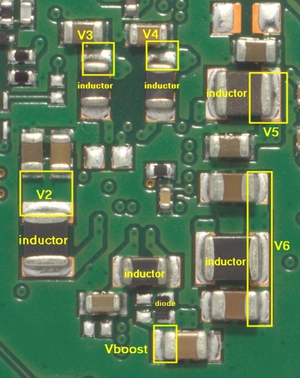

The Samsung EVO 840 have tied the WP (Write Protect) pins of the NAND flashes directly to ground on the PCB, so you would need a different PCB to make use of the WP feature.
Another thing you could try to use is the ERASE function, which needs the VPP voltage line, which provides a much higher voltage that is dedicated to erasing the flash. Since erasing is necessary before writing, if you don't supply the voltage for erasing, it also can't write. Theoretically. The VPP should be reachable somewhere on the PCB surface or on one of the smaller parts that are surfaces mounted on the SSD surface, where you might be able to easily break a pin or trace and thereby remove the VPP supply from the SSD.

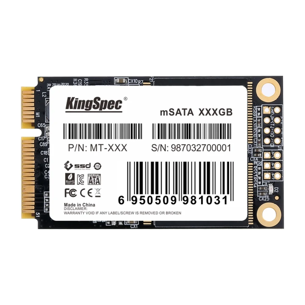

I did some more research and found some SSDs with more pins. Some are advertised as having write protection and hardware purge features. Though it looks like in some cases also a custom firmware would be necessary.
Hardware purge: https://us.transcend-info.com/Embedded/Essay-19
These Transcend SSDs have JTAG, Serial and 3 other pins which are probably used with a jumper to either write protect or erase the device. Anyone came across those or knows more about these pins?
https://ozon-st.cdn.ngenix.net/multimed ... 299165.jpg
https://www.transcend-info.com/Products/No-632
https://www.transcend-info.com/Files/ED ... N_1710.pdf
I also came across these similar SSDs from different manufacturers:
https://ae01.alicdn.com/kf/HTB1sIuNArSY ... esktop.jpg
http://www.zheinossd.com/photo/ps193925 ... active.jpg
They don't seem to have a serial connection but JTAG and three jumpers. One being labeled ROM but no information about the other ones.
These ones have a ROM jumper and one labeled QE.
http://www.zheinossd.com/photo/ps183760 ... _flash.jpg
These are mostly msata SSDs, I could also find some real SSDs with enclosure which have additional pins for different erase functions (some including firmware) and write protection. But I guess they are going to be pricey.

For the 840 Evo, Vpp is "Vboost" in the attached image. If you wish to disable it, then make a vertical cut through the PCB trace to the right of the diode.

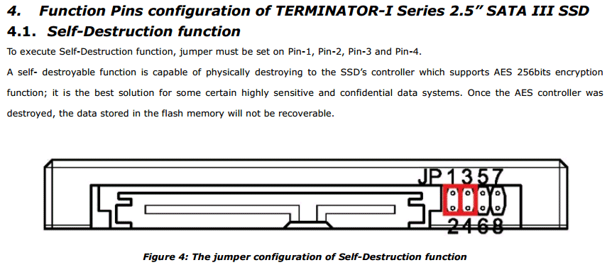

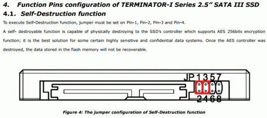

Is the flash controller really "physically destroyed"?
 Post subject: Re: Firmware security and using SSDs for (anti)forensics
PostPosted: November 7th, 2018, 19:40
Posts: 3598
Location: Chicago
probably it burns a fuse inside ASIC
