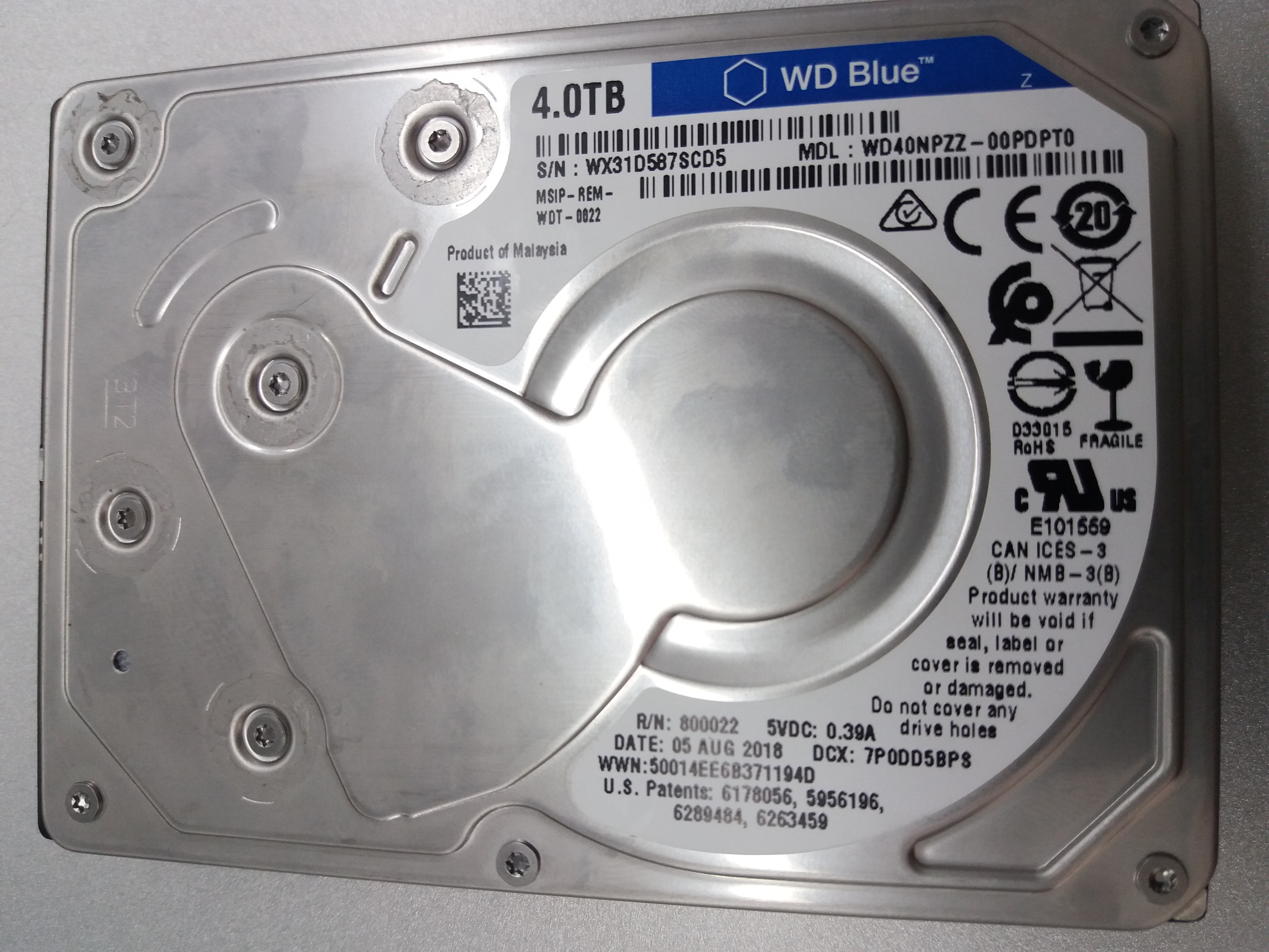

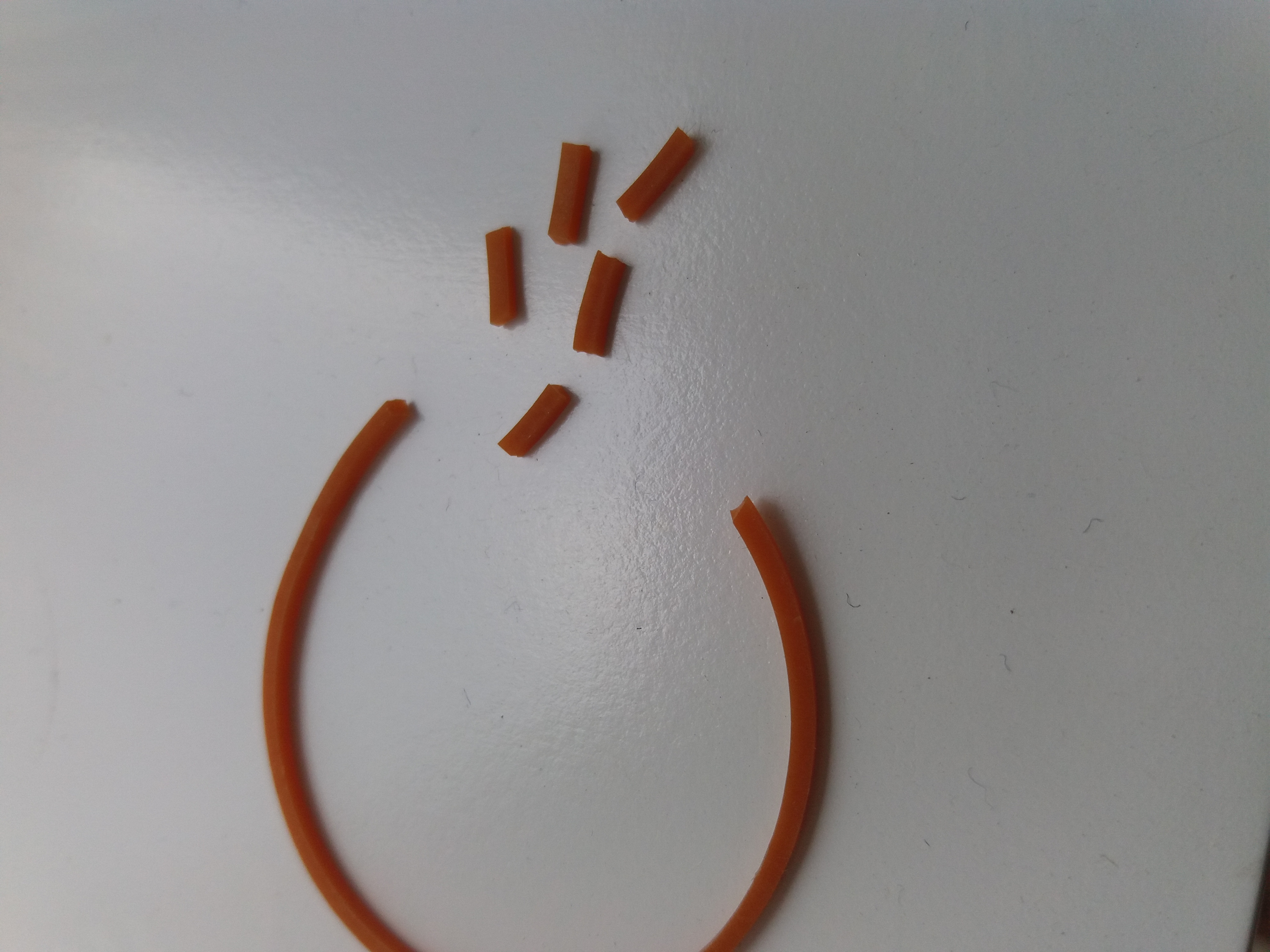

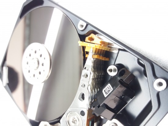

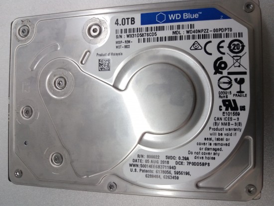

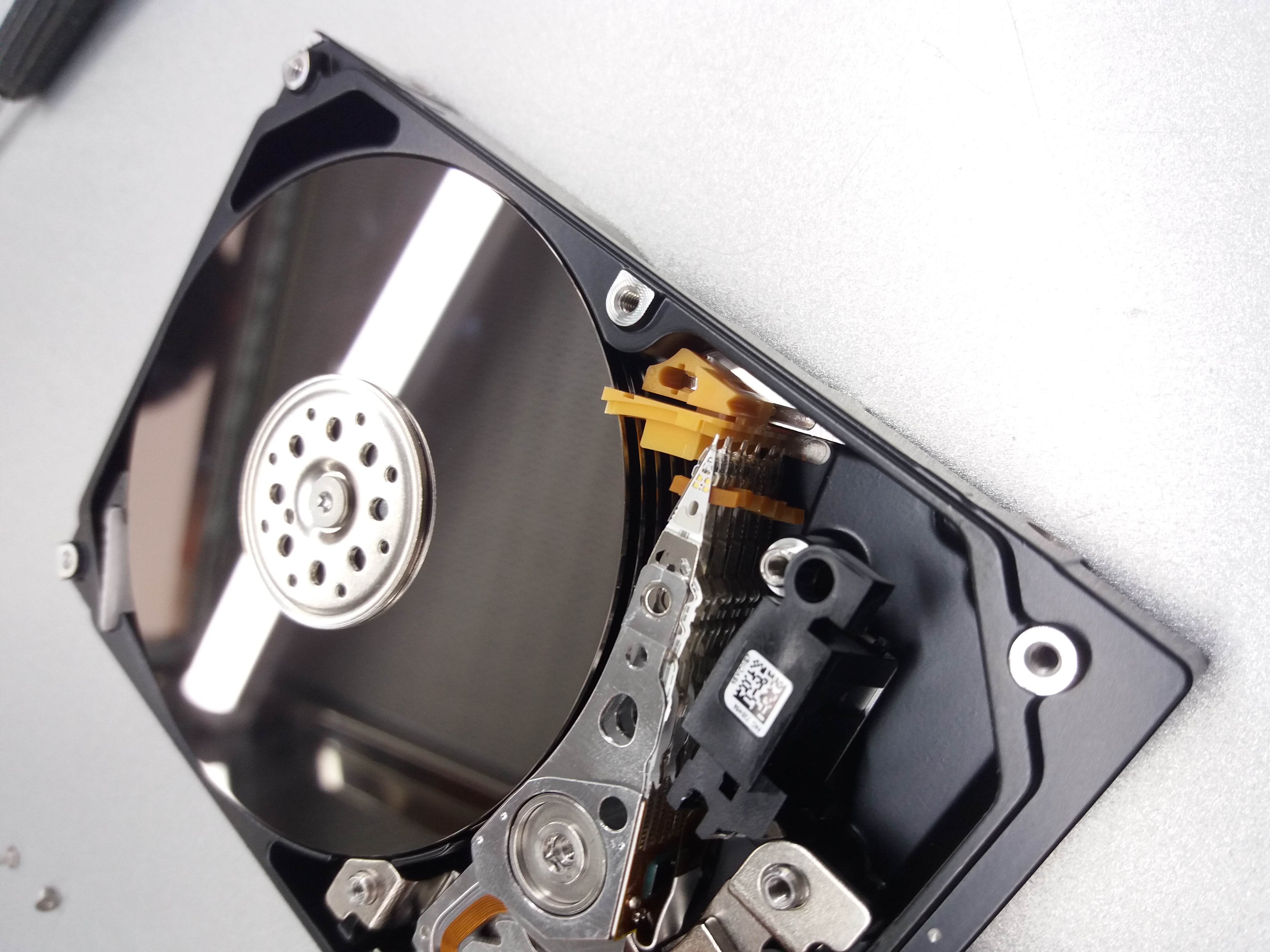

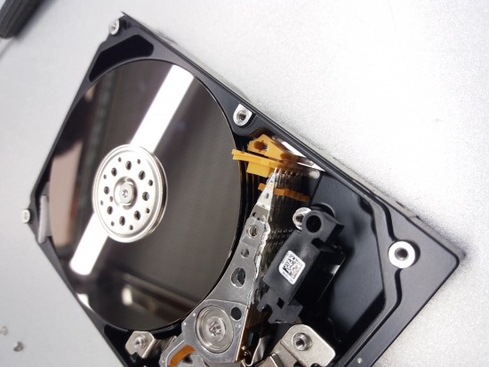

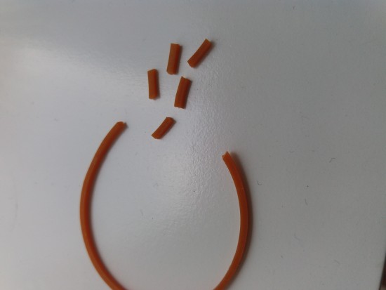

This is a simple head tool techniq with using rubber band.
this rubber band 100% mach for wd40npzz heads space.
use with very carefully
see the picture.

Works for experienced people. Have used this method on drives without specialized tools for more than 10 years.
Inexperienced people can screw up easily.

hi friend labtec
i agree with you and i know it.
but this is Pebble and SpyGlass new series 4TB 5 platters hard drive. i think some DR persons doesn't have this kind of specialized tool yet. this is DIY . i shared my experience and it would be a help to someone who hasn't specialized this kind of head tool.
also i have mentioned that use with carefully. beside someone willing to swap heads who needs well experiance. so if someone has specialized tools without experience and skill result is zero.

Apextool already have that tool for that family!
