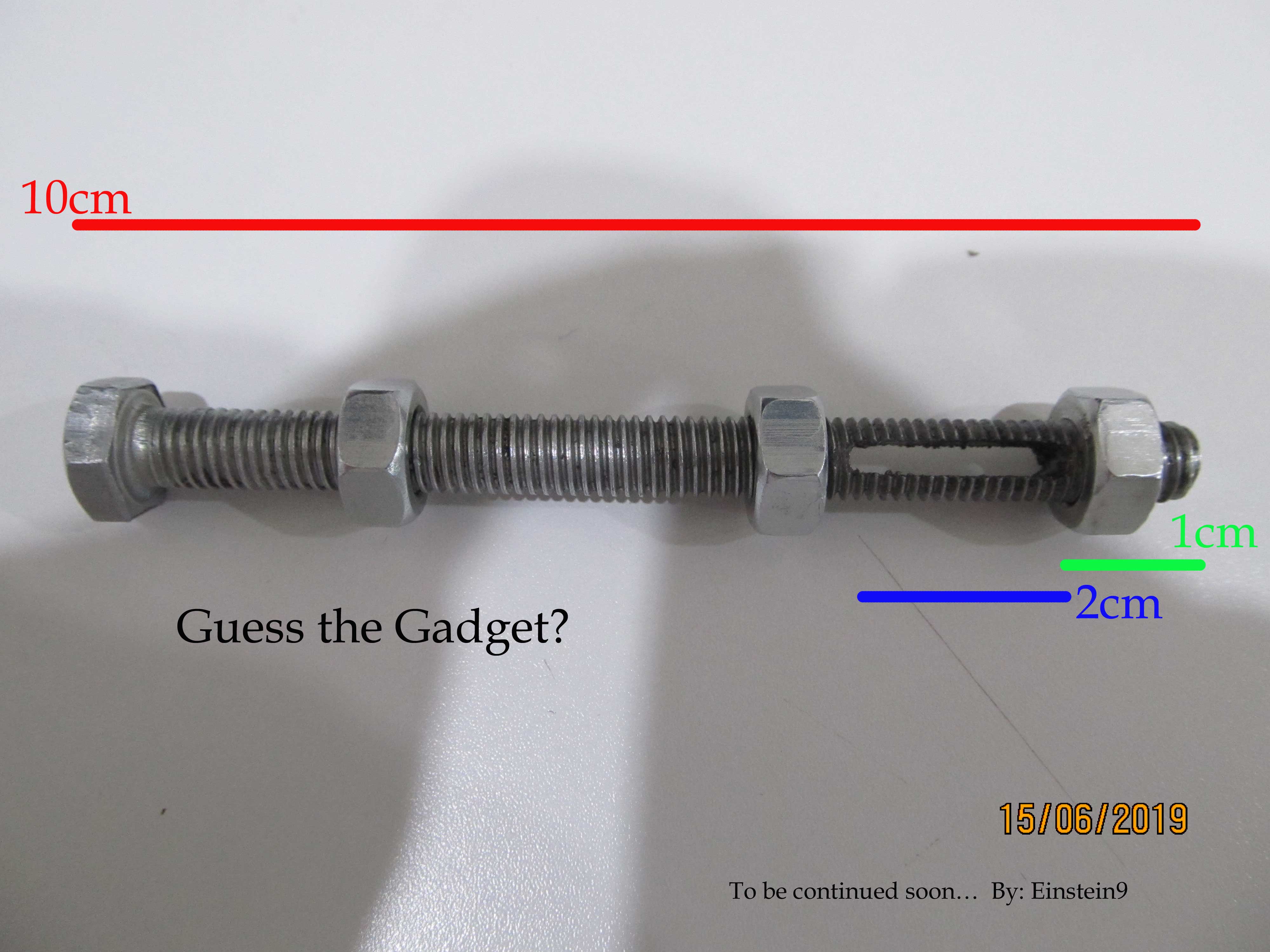

Saw a crazy DIY by someone (will post later) and Upgraded the Idea for better effective results
and Sharing it here (soon when its ready) needs some time to assemble :wink:
so the question remains, Guess the Gadget?

 Post subject: Re: Guess the Gadget?
PostPosted: June 16th, 2019, 7:39
Posts: 2848
HaQue wrote:
Shed Holder-togetherer
Its more like a DR Tool for our labs (but cheaper :wink: )
I need like 1 week more to get it fixed/assembled
you will love the idea in general (same as i do when i saw it)

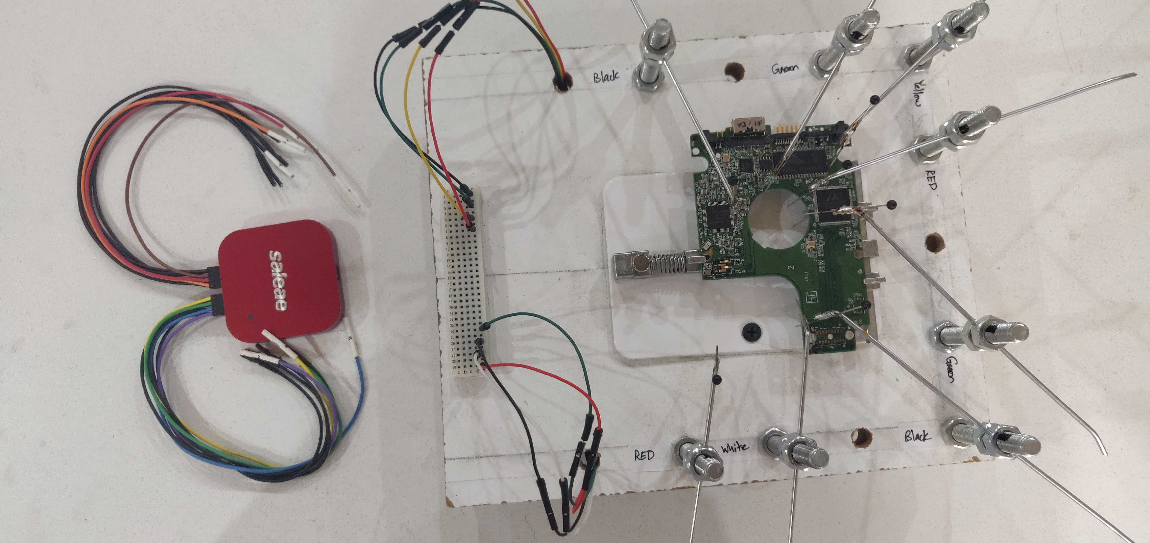

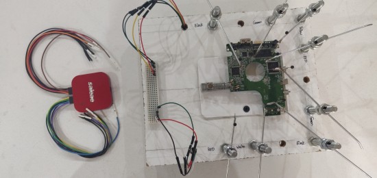

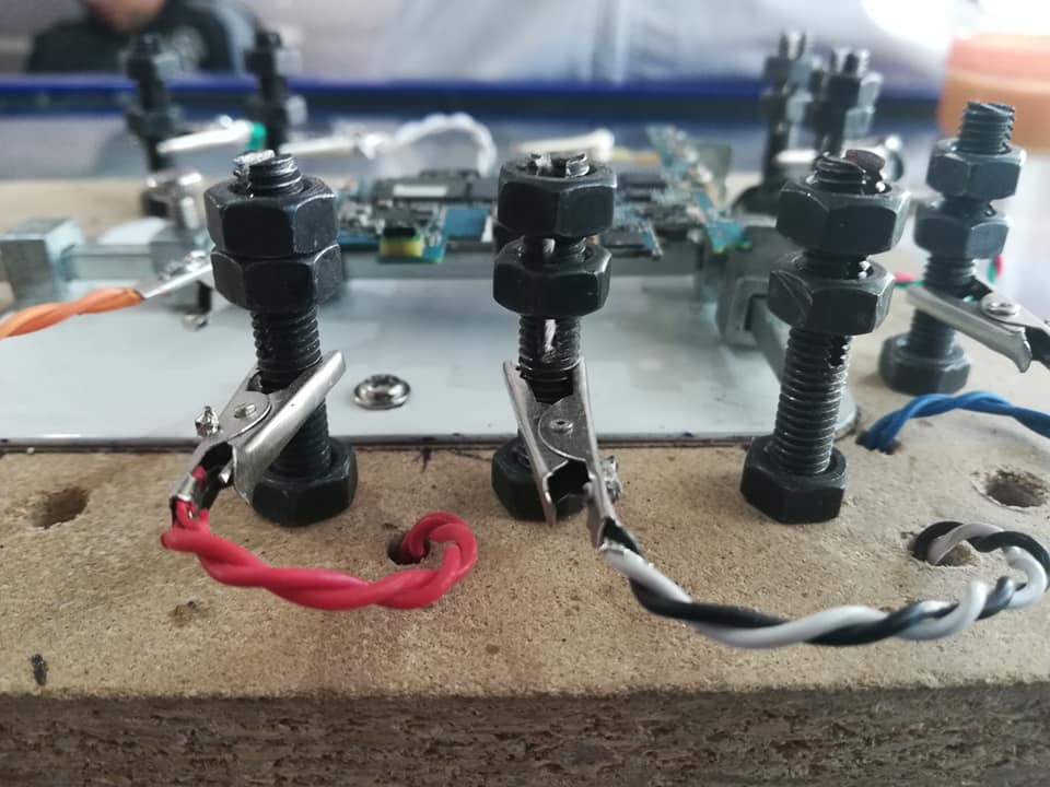

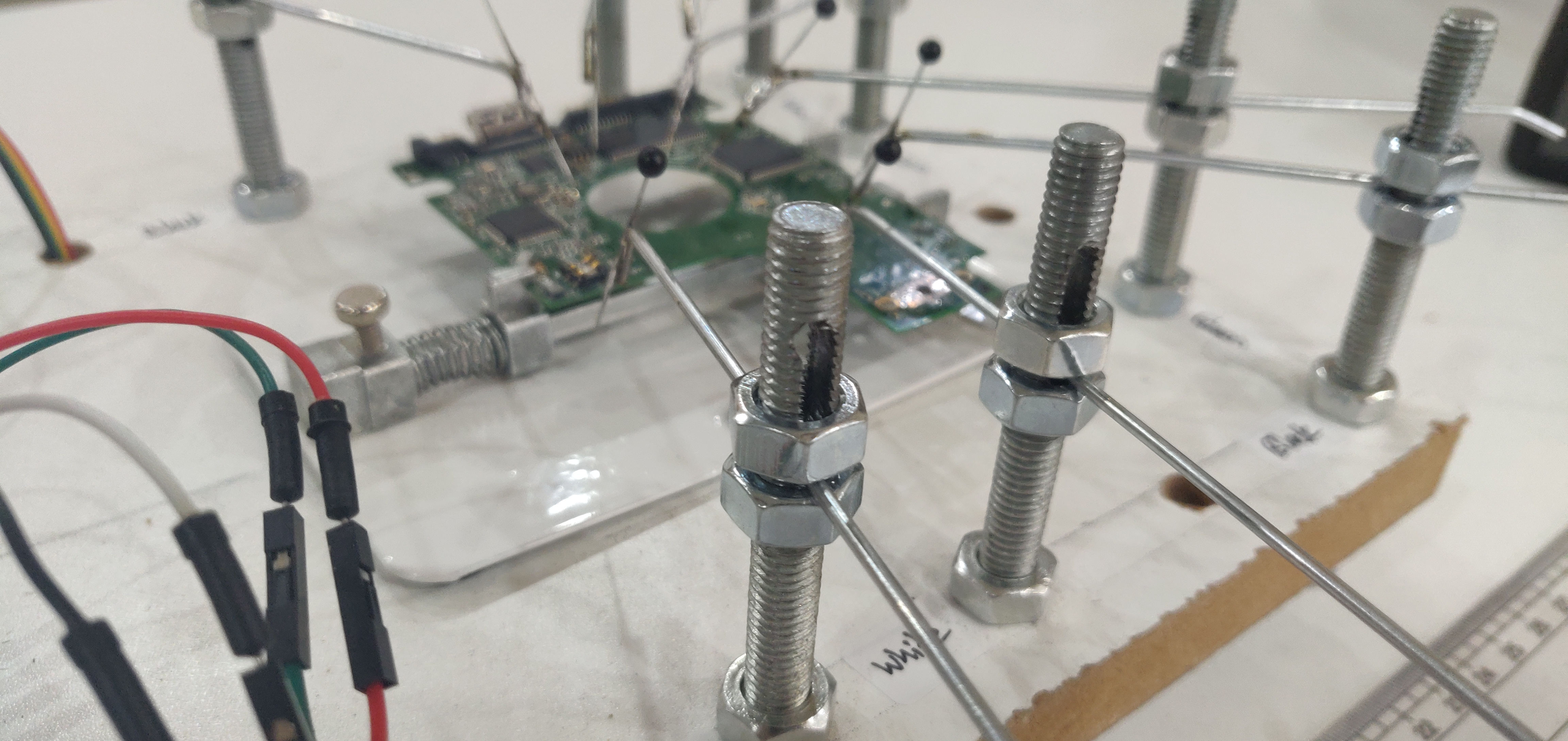

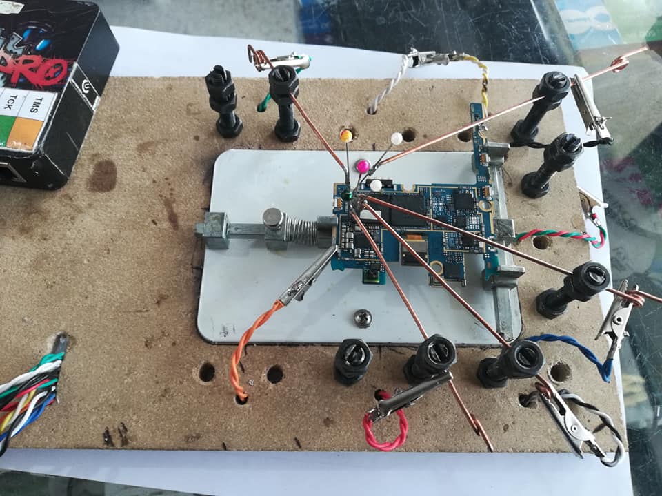

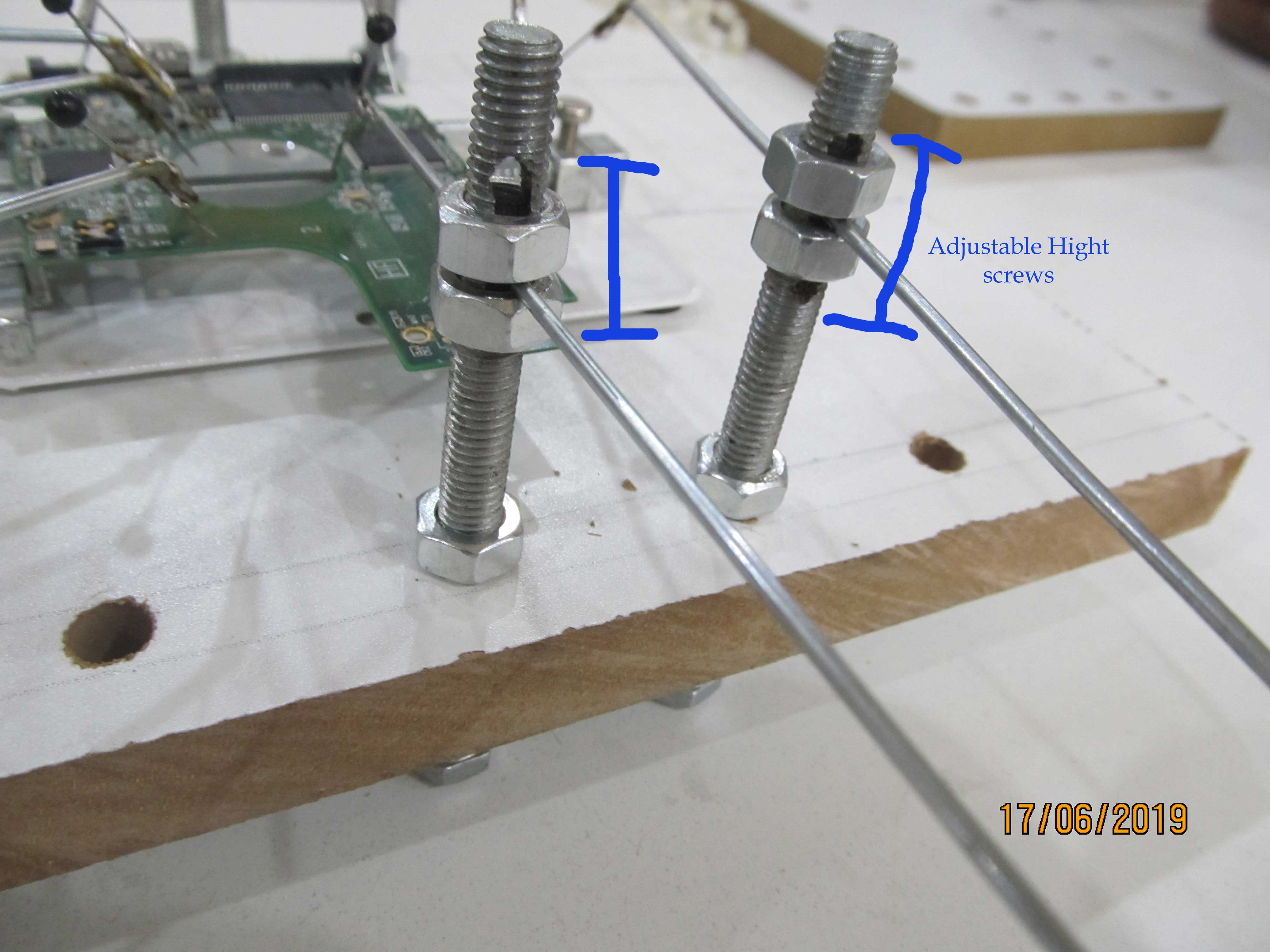

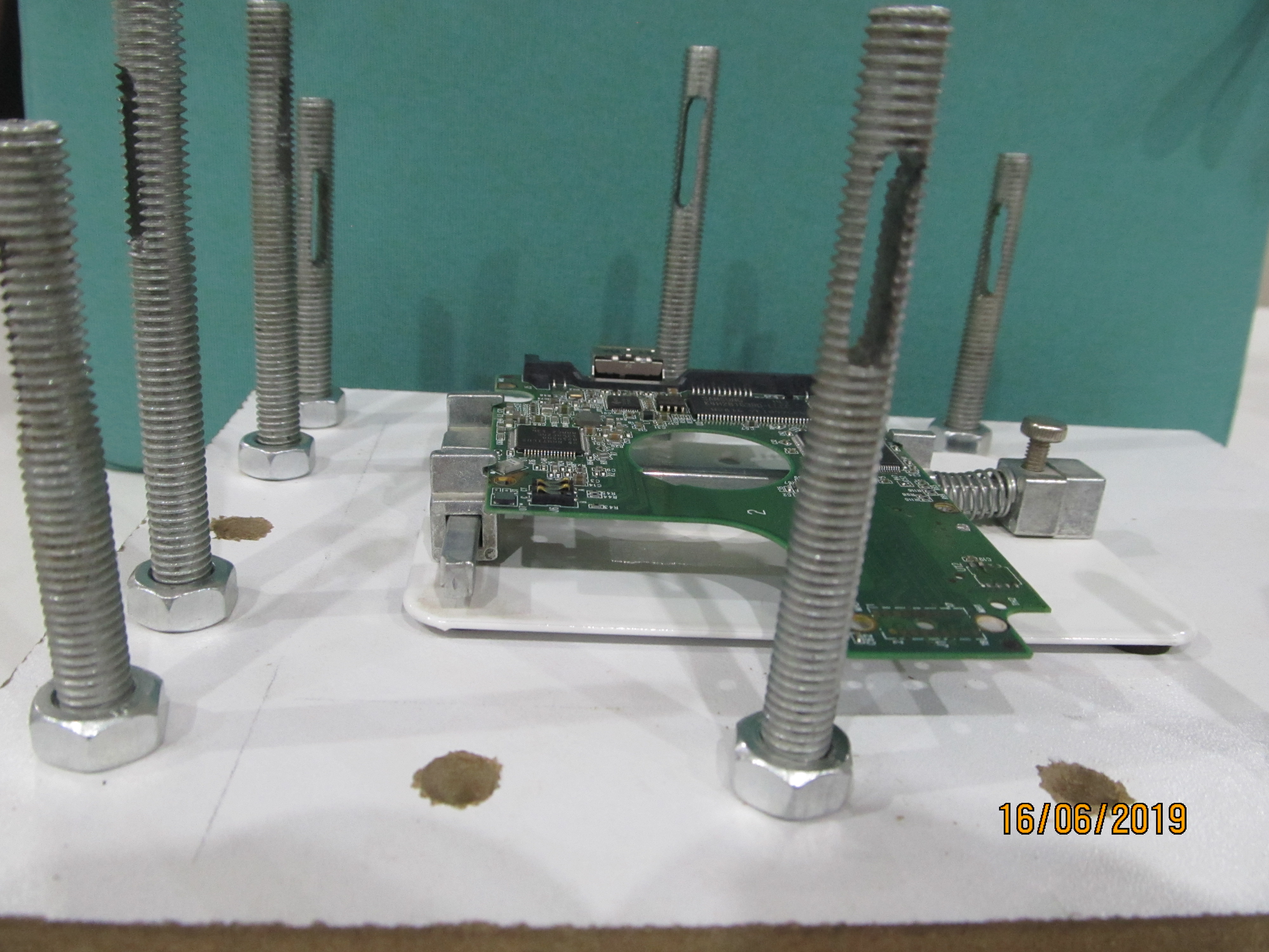

Here is the final master piece,,,
I work on many SSD cases, Mobile JTAG, and some other research will post in another thread later
and it seems i really need something similar to this in my Lab...
I saw some other guy (which you can see here also) I modified/added some extra stuff that meets my daily work
and here is the final output...
@HaQue, since you are the 1st. (only) one who guessed >> will PM you later some extra info. about this and feel free to publish it....
Have a good day....
PostPosted: June 20th, 2019, 11:29
Posts: 3963
nice, like ace labs spider board for monolith discovery. I have a saelae as well, and yes it is often a challenge to hook up wires in the right place. You could get some pretty good accuracy with that :-)
PostPosted: June 20th, 2019, 11:57
Posts: 2848
before i used to do few cases, but with more cases we need to find a faster/better way of doing things more practical...
PM sent....

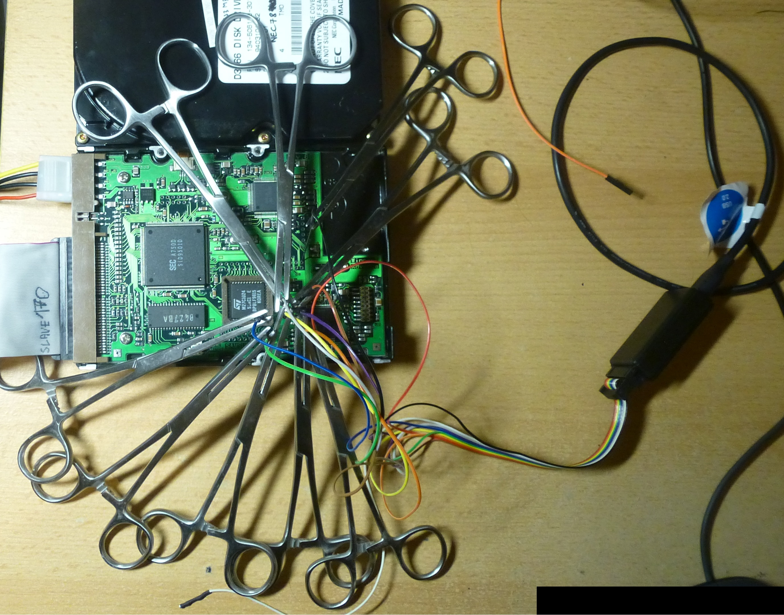

I use similar approach with surgical forceps :)

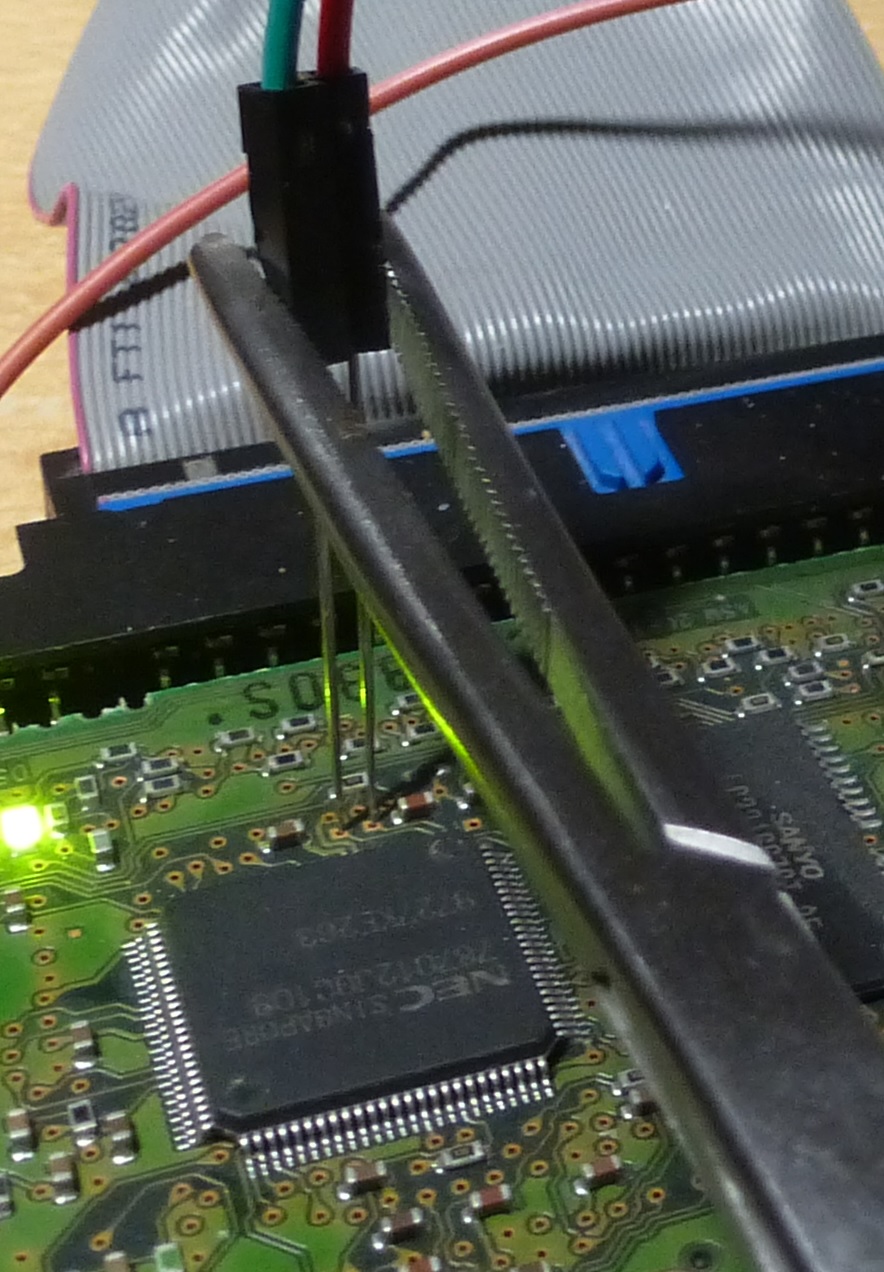

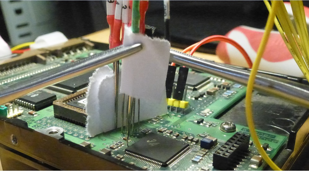

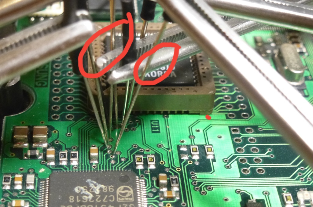

can't short circuit??
PostPosted: June 22nd, 2019, 3:13
Posts: 2848
All routes leads to the same destination,,,

short circuit..
PostPosted: June 22nd, 2019, 8:20
Joined: March 25th, 2018, 16:39
Posts: 26
Location: Europe
This is an illusion on flat photo only. I've got good LA recordings from this and many other similar connections. You can even see results from this particular connection, because I published it a year ago: http://www.hddoracle.com/viewtopic.php? ... =20#p18508
And sometimes, of course, exactly for short-circuit prevention, connection looks like this:
