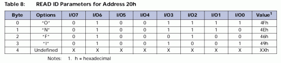

ISTM that the tool(s) would be more useful if it/they were to additionally support the 90/20 READ ID command. This command returns an "ONFI" text string.
AISI, the two READ ID commands would enable us to identify the lines corresponding to data bits 0, 3, 5 and 6. There would be two possible line combinations for data bits 4 and 7, and two combinations for bits 1 and 2. The final result would be 4 possible combinations for the real flash ID.
 Post subject: Re: NAND Decoder available as Trial for all
PostPosted: September 8th, 2019, 17:22
Posts: 17215

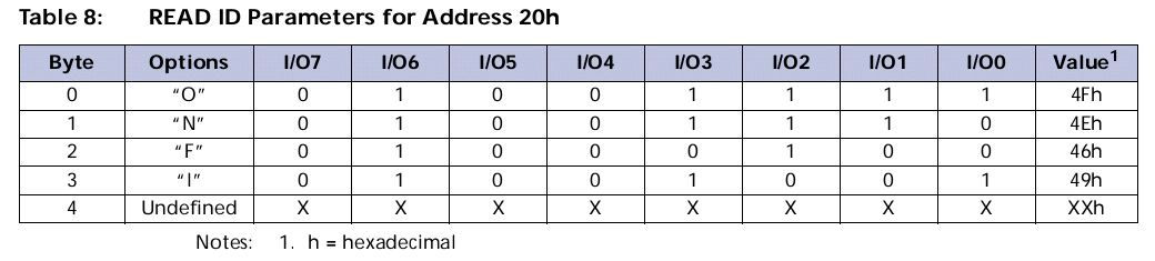

I think I made a mistake. ISTM that it should be possible to do better than that.
https://user.eng.umd.edu/~blj/CS-590.26/micron-tn2919.pdf
There are 28 possible combinations of lines 0 - 7 corresponding to the 90h/00h READ ID command. One combination will produce a 4-byte/5-byte ID. This identifies the two lines corresponding to data bits 4 and 7, but not necessarily in that order.
There are now 6 remaining lines, one of which corresponds to data bit 5. We now execute the 90h/20h READ ID command until we get a result. This identifies data bit 5, and it gives a result which we know is an "ONFI" text string.
Comparing "ONFI" bytes 0 and 1 gives us the line corresponding to data bit 0.
Now that we have identified data bits 0, 4, 5, 6 and 7, it only remains to find bits 1, 2, and 3.
Comparing the "F" and "I" bytes gives us the line corresponding to data bit 1.
Comparing the "N" and "F" bytes now gives us the lines corresponding to data bits 2 and 3.
Now we know all the data bits except for 4 and 7, but this leaves us with only two possible combinations.
PostPosted: September 8th, 2019, 19:40
Posts: 17215
Data bit 6 is identified by performing a bitwise AND of all four "ONFI" bytes. That is, bit 6 is the only bit which is set in all 4 bytes.
