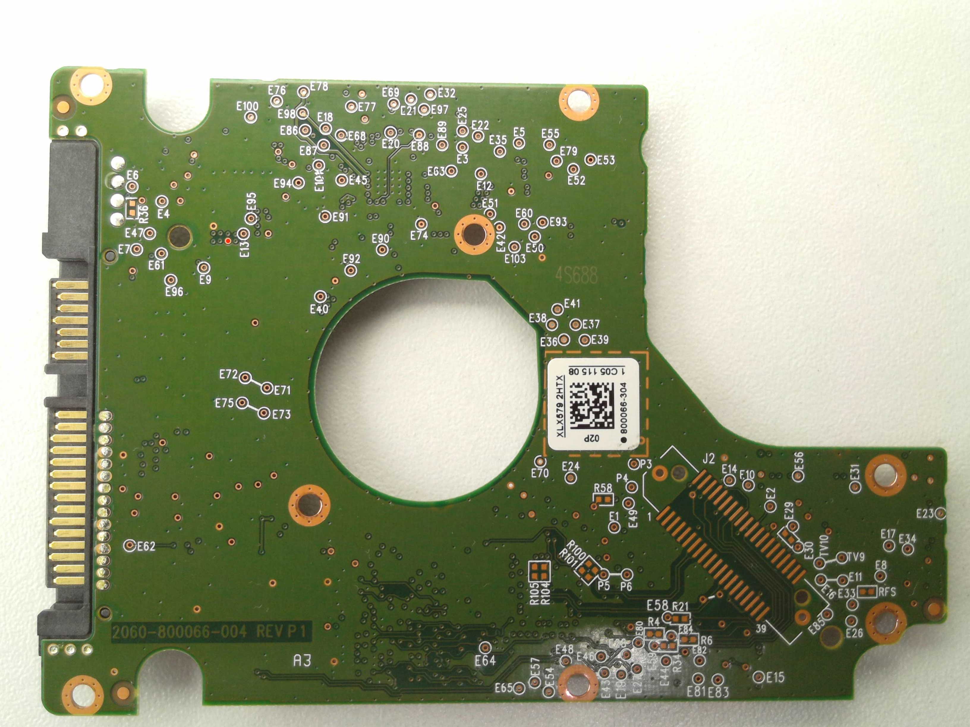

attached here is ONE of the pins (marked in RED), the 1st. step to the answer. :idea: :idea: (you may find the rest)
How to read it? Which App.? blah blah ...... you need to do your own homework.
good luck

between this point, and another, using resistor you get tiny console?

There is no way to get tiny console with hardware tricks. It is deactivated in MCU code.

 Post subject: Re: Palmer, Charger or any other...
PostPosted: July 4th, 2019, 6:17
Posts: 2855
Another point to motivate the researchers..
Hints:
There is 2 types/ways to deal with it...
A- Open heart surgery >> working/editing Decoding DUMP directly from the chip >>> Requires Pro. Tool & needs some time to understand how it works... (not nuclear science)
B- Normal Dump via JTAG (As dejan explained) Decode Dump then Modify then Write it back >>> does the job, but longer path...
I vote for the 1st. option believe me you will know later more than what you thought... and this will open a door which will help you figure out ANY JTAG interface...
have fun & enjoy it....
My Advice is to work in 701499 with option A since you know all inputs....
good luck again
"no more hints/points to the 800066 pcb"
:idea:

AFAIR there is no tiny console on Palmer/Charger drives, it is just not in the code.
JTAG is locked on locked PCBs, unless you have PCB with disable security, finding JTAG pins will be pointless exercise.

if you can short cut those test points correctly. then the drive can enter serial boot mode. the serial mode has 4 sub command ( AA, FF, 70, 72, 2, 5)
70 - get serial baud rate list (min - 115200 ,max - 3125000)
72 - set baud rate
AA - sync
FF - get a ack pack, and set default baud
05 - Go
02 - upload data
for the jtag, you can not find any correctly config file in openOCD.

Are you sure about that Doomer?
If you have both the Locked & Unlocked PCBs & JTAG pins ..... still pointless?? :shock:
PostPosted: July 8th, 2019, 9:11
Posts: 3598
Location: Chicago
For JTAG to work you'd need PCB with disabled security. Regular PCB has JTAG locked on HW level

this mcu use secure boot(Chain of trust). Therefore ,to unlock. must be connecting a logic probe to a PCB track or a package pin
Interesting
Do you know the test point number?
PostPosted: July 8th, 2019, 20:58
Joined: March 11th, 2012, 12:36
Posts: 27
Location: china
Doomer wrote:
Interesting
Well , unfortunately I can`t find it either. If you are interested secure boot,you can refer to this url
https://www.cnx-software.com/2016/10/06 ... -s905-soc/
https://github.com/ARM-software/arm-trusted-firmware
if want to enable jtag ,can short cut test point (maybe e65 or e67 or e54, because I forgot)
Thats ONE of the benefits of having a good friend from the other side of the world.
@flykiller, you are getting close...... very.
I see, I thought I missed something in the code

einstein9 wrote:
:wink:
I don`t think so. If can`t switch to uart boot mode, or change this port (0x30420064) value. Then is can`t unlock .... :P never
This port reflects HW fuse settings, so it is not easy to change it
As I said unless you have PCB with disabled security, finding JTAG points is useless, UART is locked out too
