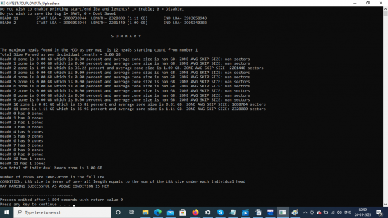

Dear all, I have made a small program that parses
Create Sub Map using Head Info .map files into legacy binary maps.
With this little tool, one can parse the said .map files into larger binary maps that is acceptable in DDI.
This enabled me me parse maps of Seagate,Samsung, Charger,Palmer to my beloved DDI and enabled me to image such drives with control over switching off heads/ switching to next heads and all the other functionality that exist.
I tried to add more information regarding average zone size, skip size, amount of size covered per head etc... that would help to image the faulty drives by setting the parameters as per the summary generated by the parser ( one needs to manually set in DDI 'available configuration' tab.
It is noted that it is very essential for your utility that generates sub map using heads info to create sum of length of chains equal to the final LBA/Size of the drive.
To use this file, unzip it to a location... add your map file in the inputmap folder. Use DevC++ and edit the name of input file as per your file name on line number 61 of the To_Upload.cpp code
I will try to upload a small video of how to do the above steps and compile.
Let me know how it works for all of you. :)

You are very correct. I have limited the parsing to just 10 heads. Infact I do not have any hard drives right now with me that have 10 heads. (Usual drives for recovery in my place are of 160GB to 4TB capacity, 4TB being really rare)
I guess a 4tb palmer/charger would have 10 heads but sadly I do not have any donated pieces by customers for any experimentation (yes openly ask for a donation from the client once the recovery is done and the client has checked his data+ backed it up else where. Some people love us enough to donate it :)
Generic record size that I could set was of 2A length, you are correct
For heads more than 9, It should ideally go up in its count as in 3A to signify 10 heads.. and thats where the footer count should increase intuitively (bytes 1E - 29)
bytes 0 - 7 start LBA ------------------->Is repeated in the same 7 bytes fro 08 to 0F
bytes 8 - F ?? --------------------> examine the heads footer at end of file, you will see 0-7 == 8-F i believe
bytes 10 - 17 size in LBAs
bytes 18 - 1B always 0x00 ? yes atleast for the ones i checked uptill 4tb
bytes 1C - 1D number of unicode characters in "Head#n" footer
bytes 1E - 29 "Head#n" footer ....never paid attention...but seems legit, need more heads to really verify.
Are bytes 18 - 1B always 0? Do you know their meaning? so far yes, they are empty .....empty across quite a few maps i checked.
I ignored the header for now completely as most of the job was getting done for the capacities that I got without accounting for the header.
It will be cool if people can test it with drives larger than 4tb and share the submap here.

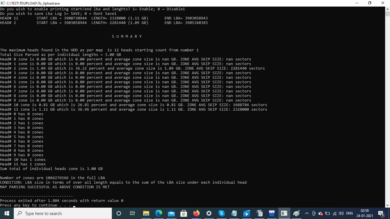

well wait a sec I was wrong.
Try to carve out a few segments from any mapfile
try below file
unt.zip [199 Bytes]
Downloaded 1386 times

ISTM that the head number is an ASCII code, eg "1" = 0x31 ASCII. Therefore 0x3A would be the ASCII code for a colon ":". Instead I would expect to see 0x41 (the ASCII code for "A"), if the head numbers were hexadecimal.
Otherwise, in the case of decimal numbers, I would expect to see "Head#10" -> 0x48,0x00,0x65,0x00,0x61,0x00,0x64,0x00,0x23,0x00,0x31,0x00,0x30,0x00
As for bytes 8 - F, look at the Palmer example.
 Post subject: Re: Head Map Parser
PostPosted: January 23rd, 2021, 17:36
Posts: 456
So just take any length of any example .map file provided.
Just in the .H.E.A.D.#.XX area put 3A and the parser would parse it as 10 heads. :)
just increase the size of the arrays which are globally declared to account for more than 10 heads. WOULD WORK IF THEY ARE USING HEX TO STORE IT THIS WAY
