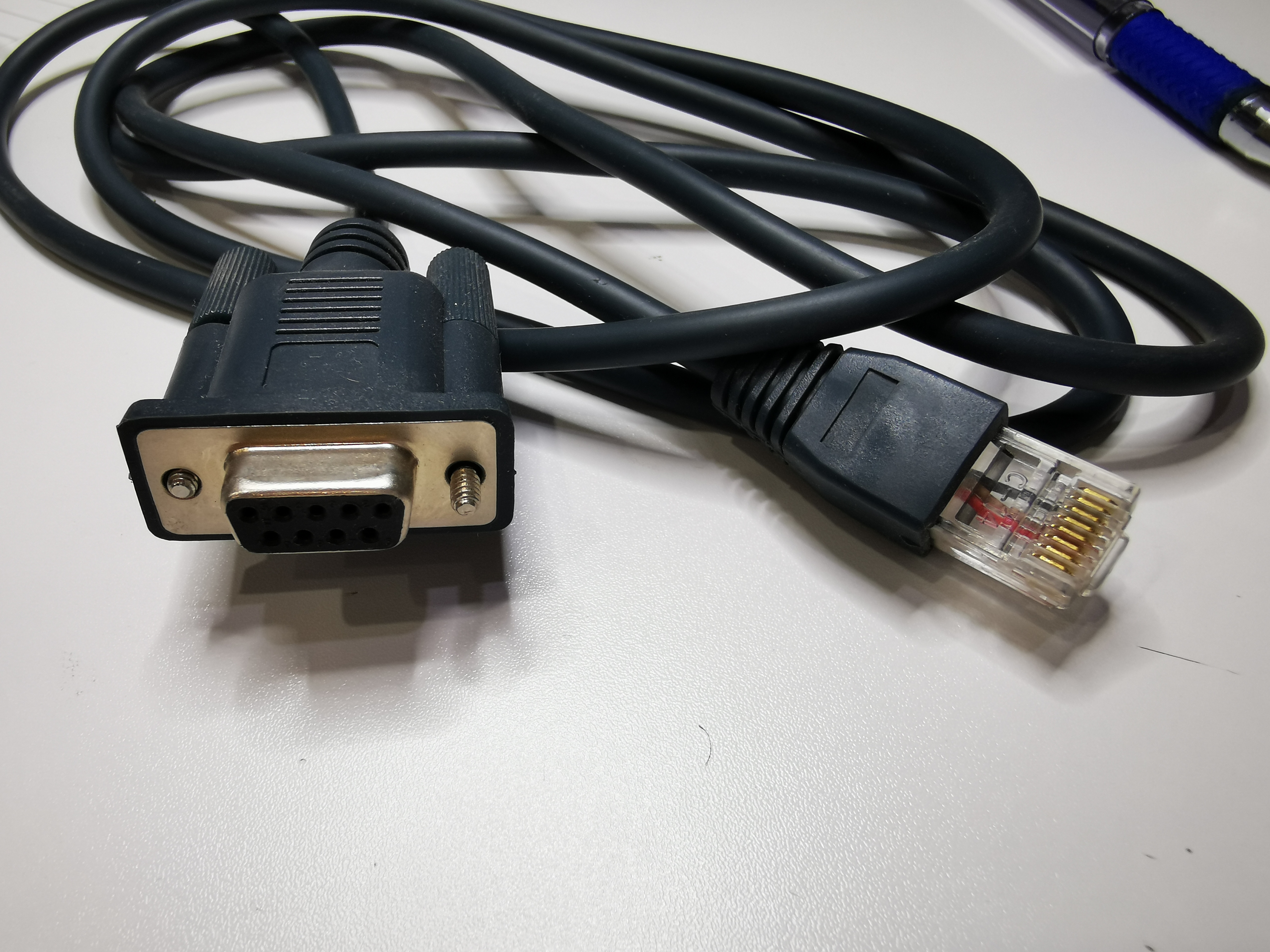

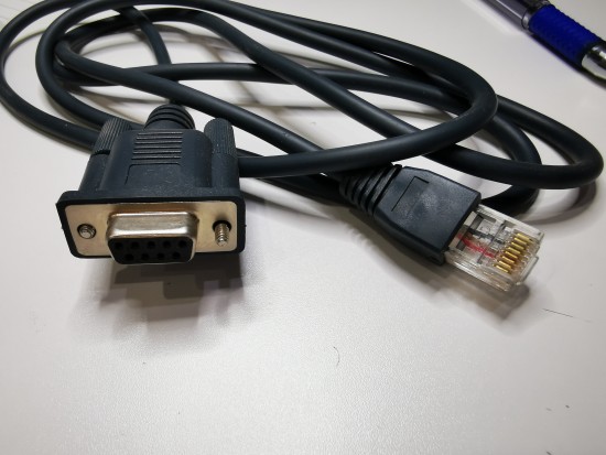

pepe, have you tried the Console Cable? RS-232 to eth (image attached)
with this cable you will be able to access the device booting and start repairing the unit
Note: some devices such as Cisco are using special pin parameters, not sure about the TP-Link
 Post subject: Re: getting a TpLink Switch back to life
PostPosted: June 6th, 2021, 16:13
Posts: 4844
i hooked up a n usb-ttl serial adapter to behind the ttl-rs232 converter (similar to MAX232) and did the above hacking through that. Almost the same as your cable, just a bit more simple (to me, in this situation, when the pcb is unmounted from the chassis).
