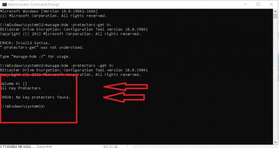

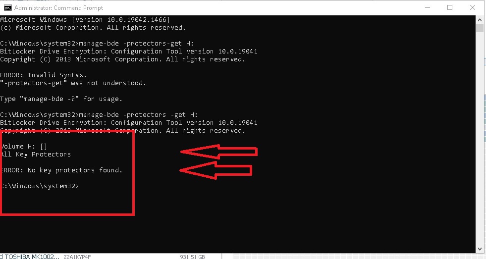

Hi Friends I want your expert advice / help for critical technical challenge I am facing.
Most of the windows 10 laptops now a days are having default Bitlocker encryption enabled by Microsoft.
However microsoft doesn't intimate nor give key to customer. Protectors in such cases are weak (clear key /No key)

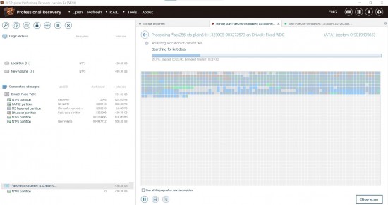

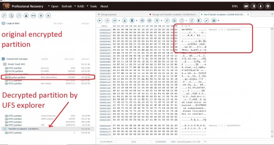

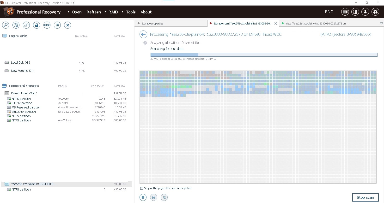

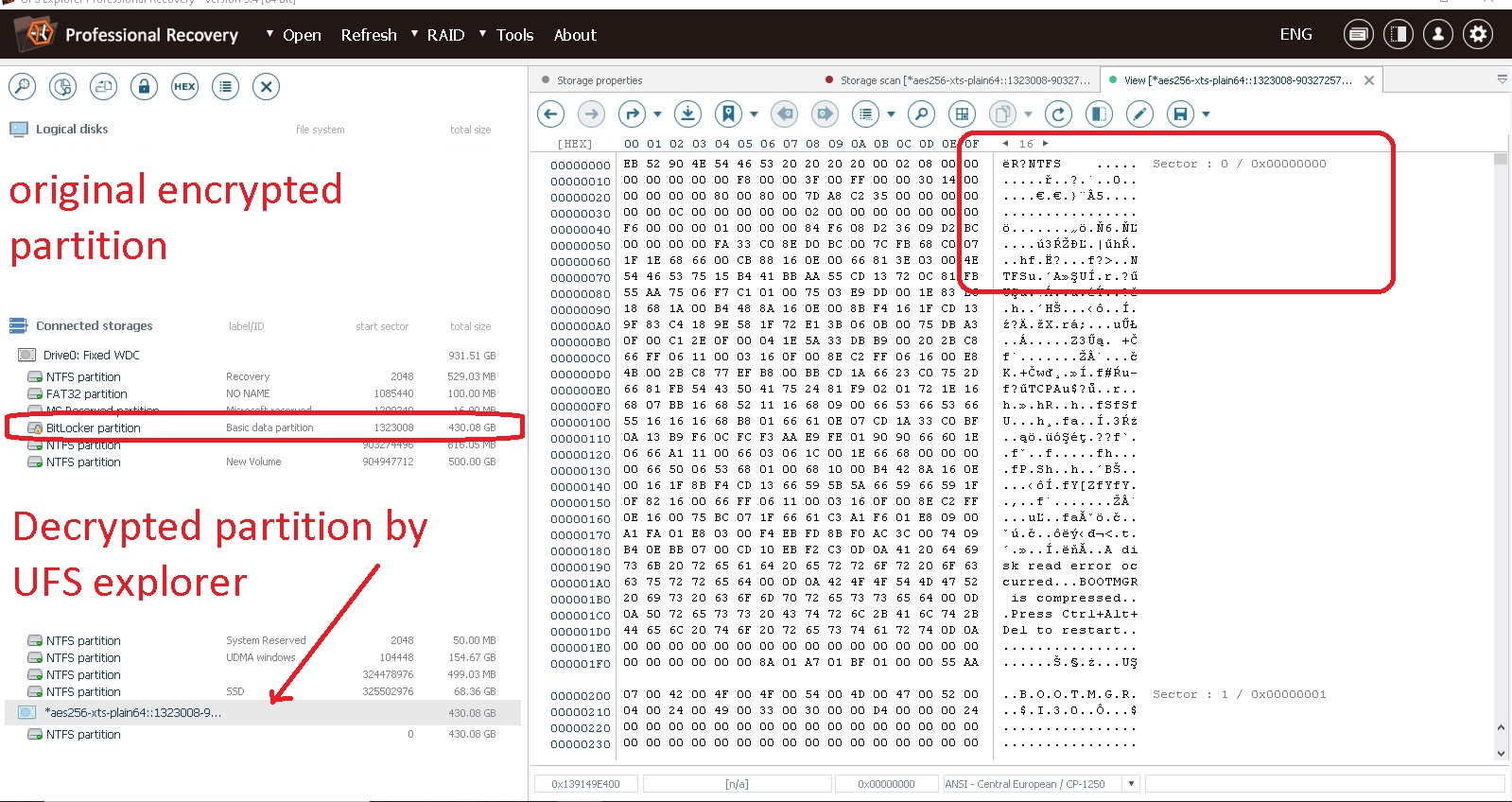

In DE there is utility to decrypt such volume. Some softwares (like UFS explorer) also supports this function.
I am working on few cases where user is not even aware of what is Bitlocker. No microsoft account is allowed by corporate security policy.
1) Case 1 --- IT engineer of customer formatted D drive which was having default Bitlocker encryption. Since all Metadata is lost data recovery seems to be impossible.
2) Case 2 ---- I have used 2/3 techniques to recover data from C drive (Bitlocker encrypted) , I could extract 80 GB of data as well.
Most of the jpg /video and some xls files are working while large no. of pdf and msoffice files are not recognized by msoffice.
I think full decryption has not been achieved .- customer wants all data .
My question is what is exactly clear key /No key --- if there is no key or blank key then what characters it is having ? Are they all spaces ? Since blank key is not accepted there must be some characters what are those characters.
How efficient is decryption from DE ? (My DE version is old and does not support this fuction)
Can someone pls. shade light on this ?
Thank you.

Clear/open key USUALLY exists on drives where full decryption process is initiated.
When a user starts decrypting the drive, Bitlocker creates clear/open key metadata, so when decryption is paused, it can be resumed right away, even after a computer restart.
It also means that drive is PARTIALLY decrypted, so decrypting the WHOLE drive is a bad idea - some files will be decrypted twice(it will be garbage).
