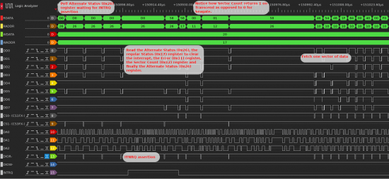

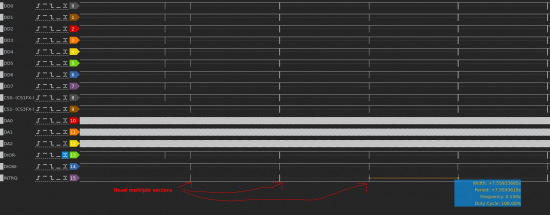

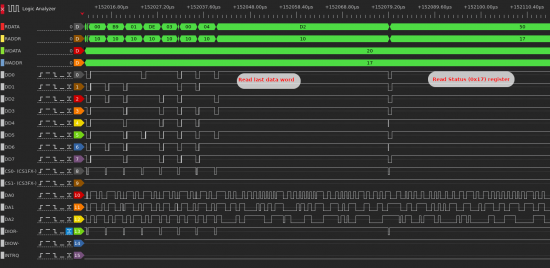

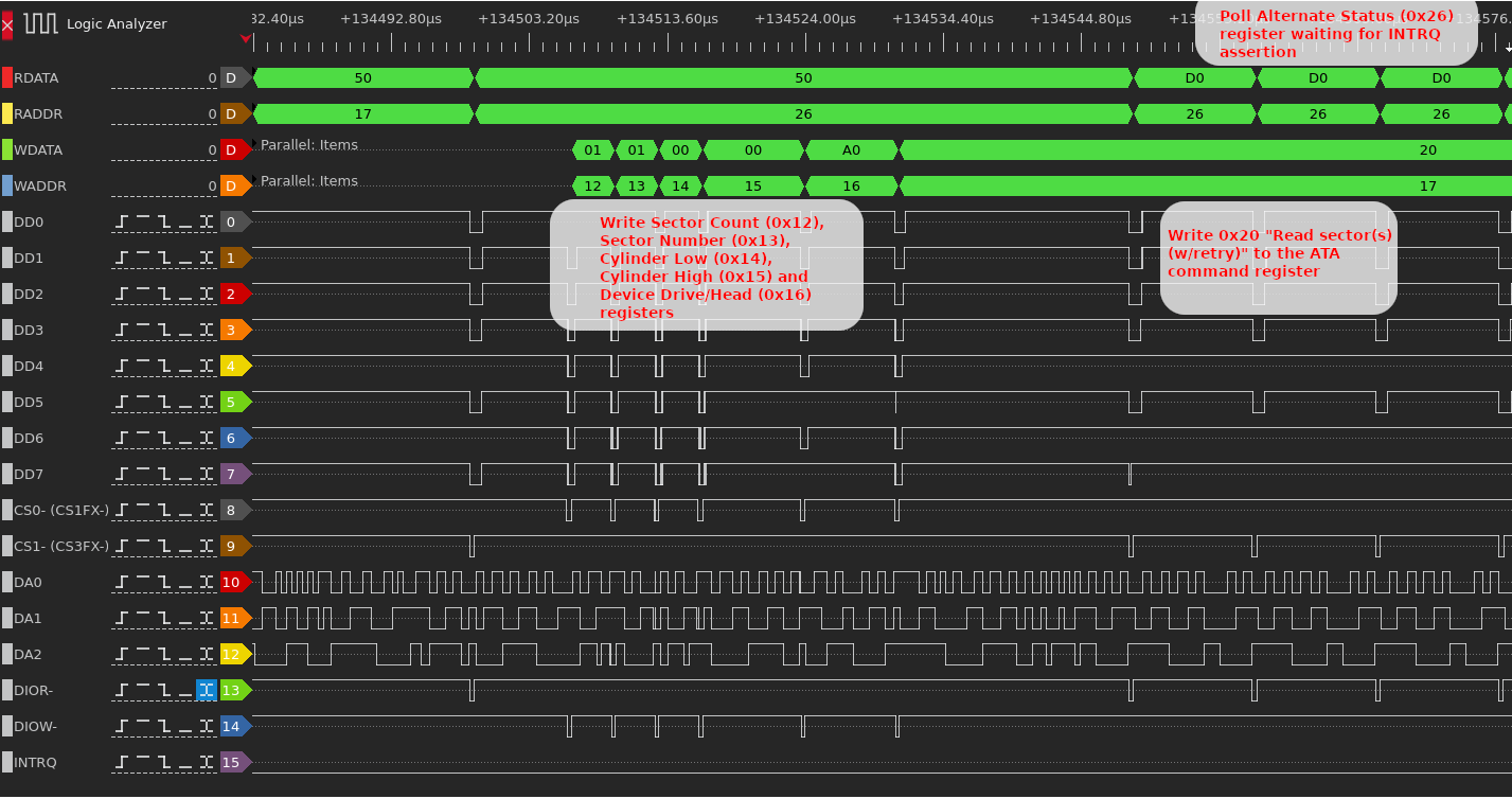

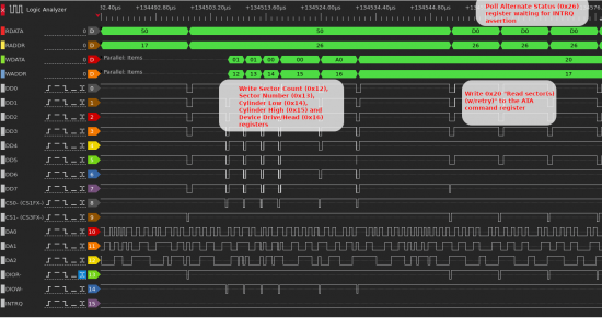

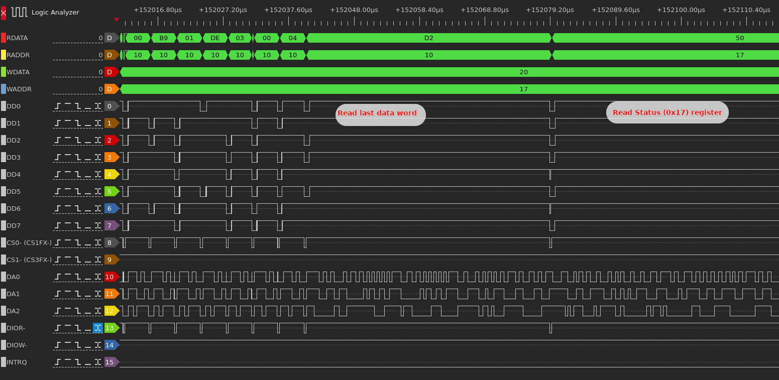

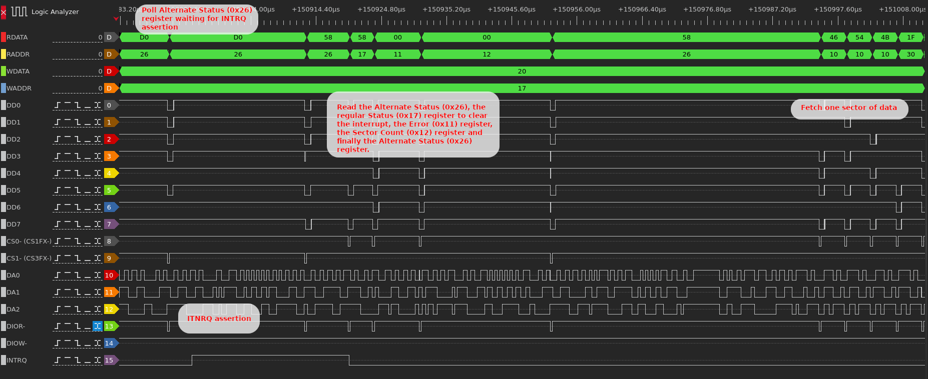

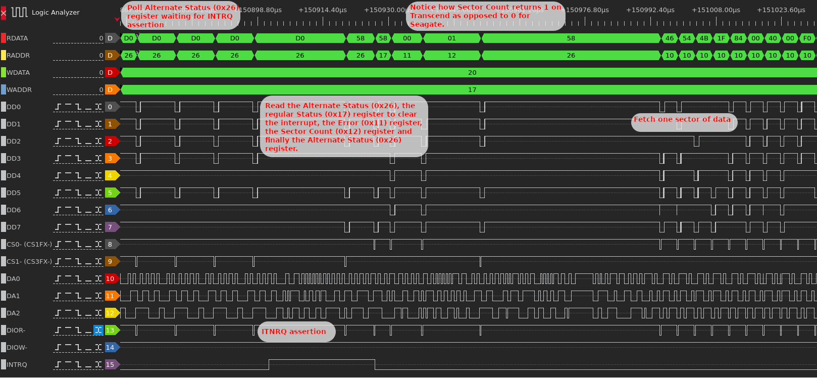

I have acquired an old Tektronix device. I'd like to replace its faithful 30 year-old Seagate drive for obvious reasons :wink:. The device is from around 1993, it is m68k based and runs pSOS as an operating system. The original hard drive - which still works without issue by the way - is a 2.5" 128MB Seagate ST9140AG (980 cyl, 15 heads, 17 sect). I bought a Transcend Industrial CF300 128MB compact flash and a CF-to-IDE44 adapter as a replacement (to be used in True ATA mode). The CF/adapter setup works fine on an oldish 2010 motherboard running Linux. It is not however correctly recognized by the Tektronix device.
The Tektronix device sees it, but it says that it is a 22MB Hard Disk (and not 128MB as expected). The Tektro also has a Format utility which simply fails:
"The hard disk format routine could not successfully format the hard disk. The boot sector could not be updated. Any data remaining on the hard disk may be corrupt. Run the hard disk diagnostics for more information".
FWIW, the Tektro's HD diagnostics utility passes. Although I'm not sure that we should take this generic error message to the letter.
I'm therefore learning about the world of old hard drives (pre and early ATA-1). At first, I suspected a variable overflow in the OS driver but I don't see what could cause 128MB to become 22MB. Right now I'm learning about CHS/LBA translation. But to me, the size of the disk should be reported during the IDENTIFY ATA command, so I'm not sure how it can get wrong.
Before I set up a logic analyzer on the beast to sniff ATA commands (I'm a bit lazy but I will eventually get to it :D), I figured someone here may have an interesting take on this problem :). Any luck?

Can you show us a dump of the Identify Device data block? Words 1 - 6 and 53 - 61 report the default and current CHS translations and CHS/LBA capacities.
https://docs.rs-online.com/1adf/0900766b816b6fd0.pdf (TS128MCF300 datasheet)
https://web.archive.org/web/20120321035657if_/http://www.t13.org/Documents/UploadedDocuments/project/d0791r4c-ATA-1.pdf (ATA standard 1994)
In these old systems the drive powers up with a default CHS translation. The BIOS then issues an Initialize Drive Parameters command (91h) which selects the desired CHS translation mode. This is so the drive can be addressed with one of the fixed CHS configurations present in the BIOS. This new configuration is volatile, so the drive will revert to its default translation mode after power cycling. You should be able to determine the scope's preprogrammed translation mode by examining the partition table or boot sector of the Seagate HDD.
There you go, dumped using hdparm on my Linux box:

Note that this information can also be found in the CF300 datasheet under "ID Table Information of True IDE Mode", page 76.
Word 1: 0x00f6: 246 cylinders
Word 3: 0x0010: 16 heads
Word 4: 0x0000: 0 unformatted bytes per track
Word 5: 0x0000: 0 unformatted bytes per sector
Word 6: 0x003f: 63 sectors per track
We can see that the CF300 follows a recent ATA spec that considers words #4 and #5 as obsolete. Whereas ATA1 used them to convey some information. I'm not sure what "unformatted bytes per track/sector" means, but perhaps my Tektronix uses these?

Hi fzabkar,
I had time to spend on this project over the last month. I spent a lot of time doing various experiments and analyzing the bootloader of that thing. I did a lot of work so I'll try to keep things brief and simple.
As you suggested in your last post, it is necessary to edit the CHS values in the BPB to match the newly-installed drive. Once this is done, the error message is no longer displayed. We get a neat "Executing Code Loaded From Disk" and I even get a nice Tektronix copyright string. However, it takes a couple of minutes to get there and the boot process stalls before reaching the OS (or rather while initializing the OS). Which gets me to the following point.

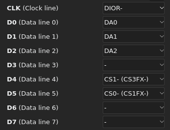

I took a lot of captures of the ATA bus with a 16-channel logic analyzer (DSLogic). At first, it was difficult to make sense of it (spec isn't crystal-clear about edge polarity to say the least and timings are rather short for 20MHz-analysis). But now that all is clear, I found one thing that stands out.
First, a note on how I'll decode ATA addresses in this text. I find it easier to use one hex digit for CS0- and CS1-, and another for DA2, DA1, DA0. Here is how I set the decoder in DSLogic to illustrate:
Also note that I only capture the data bus LSB (DD0 to DD7) and ignore the MSB (DD15 to DD8) as my analyzer does not have enough inputs. This is not really a limitation as most register transfers are 8-bit wide (aside from the Data register which is 16-bit wide).

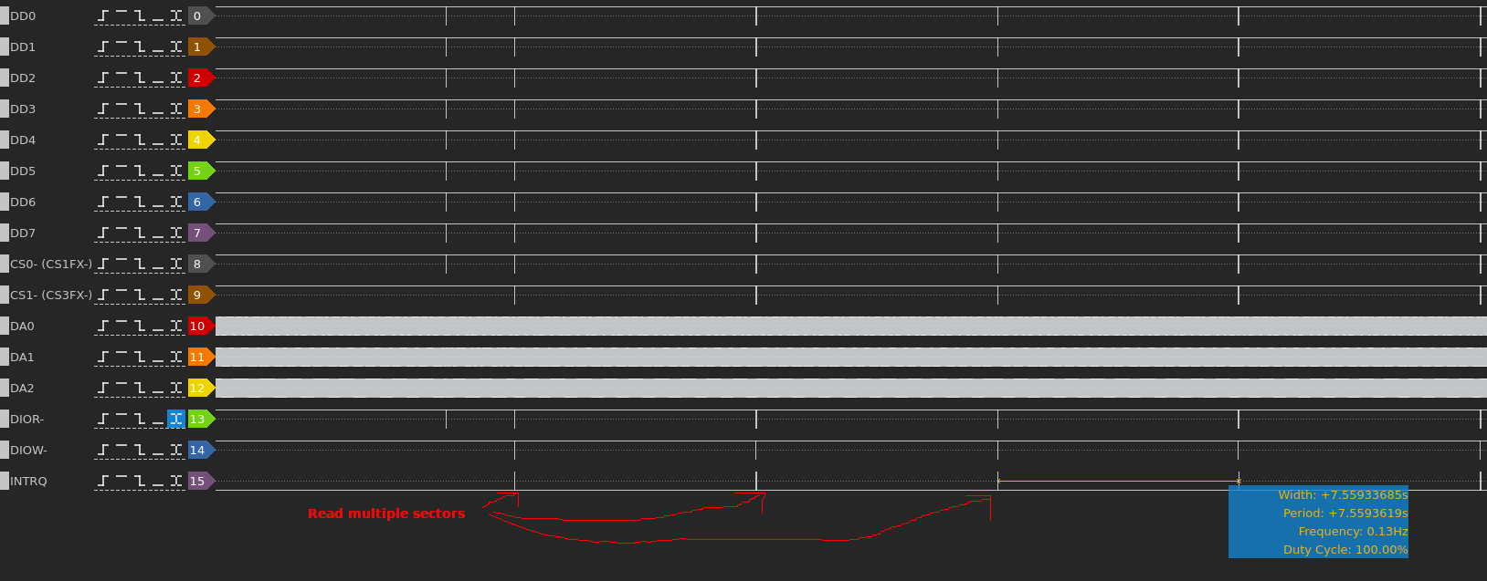

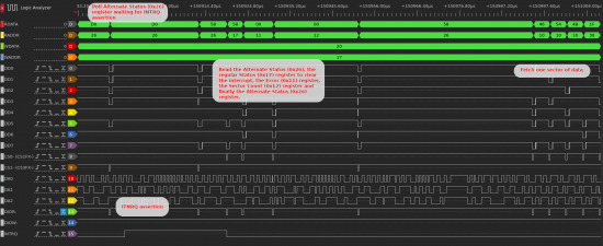

To get data from the hard drive, the bootloader initiates a PIO read of one or more sectors by setting up the Sector Count (0x12), Sector Number (0x13), Cylinder Low (0x14), Cylinder High (0x15) and Device Drive/Head (0x16) registers and then writing 0x20 "Read sector(s) (w/retry)" to the ATA command register. It then waits for the INTRQ pin to be asserted by the drive while polling the Alternate Status (0x26) register.
Once the interrupt is asserted by the drive (meaning that one or more 512-byte sector is ready to be fetched), the bootloader reads the Alternate Status (0x26) register once more, reads the regular Status (0x17) register to clear the interrupt, reads the Error (0x11) register to make sure that everything is fine, then the Sector Count (0x12) register to get how many sectors are to be fetched (important, more on that below) and finally the Alternate Status (0x26) register one last time. It then proceeds to read one full 512-byte sector by polling the Data (0x10) register 256 times. Once the entire sector has been read, the bootloader waits for the drive to raise INTRQ, then it starts over: read Alternate Status, Status, Error, Sector Count (which is now decremented by one), Alternate Status, fetches data... Until it fetches the last sector, where Sector Count now reads 0 (more on that below). Once the last sector has been read, it reads the Status (0x17) register one last time.

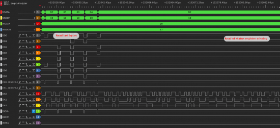

When I put a newer hard drive (I tried both a 128MB Transcend CF300 CF and a 40GB Toshiba MK4026GAX 2.5" HDD, both share the same behavior), all sectors are correctly retrieved. However, there is a huge 7.5-second delay between each read attempt (the following capture is hugely zoomed out, each spike represents a lot of register reads/writes).

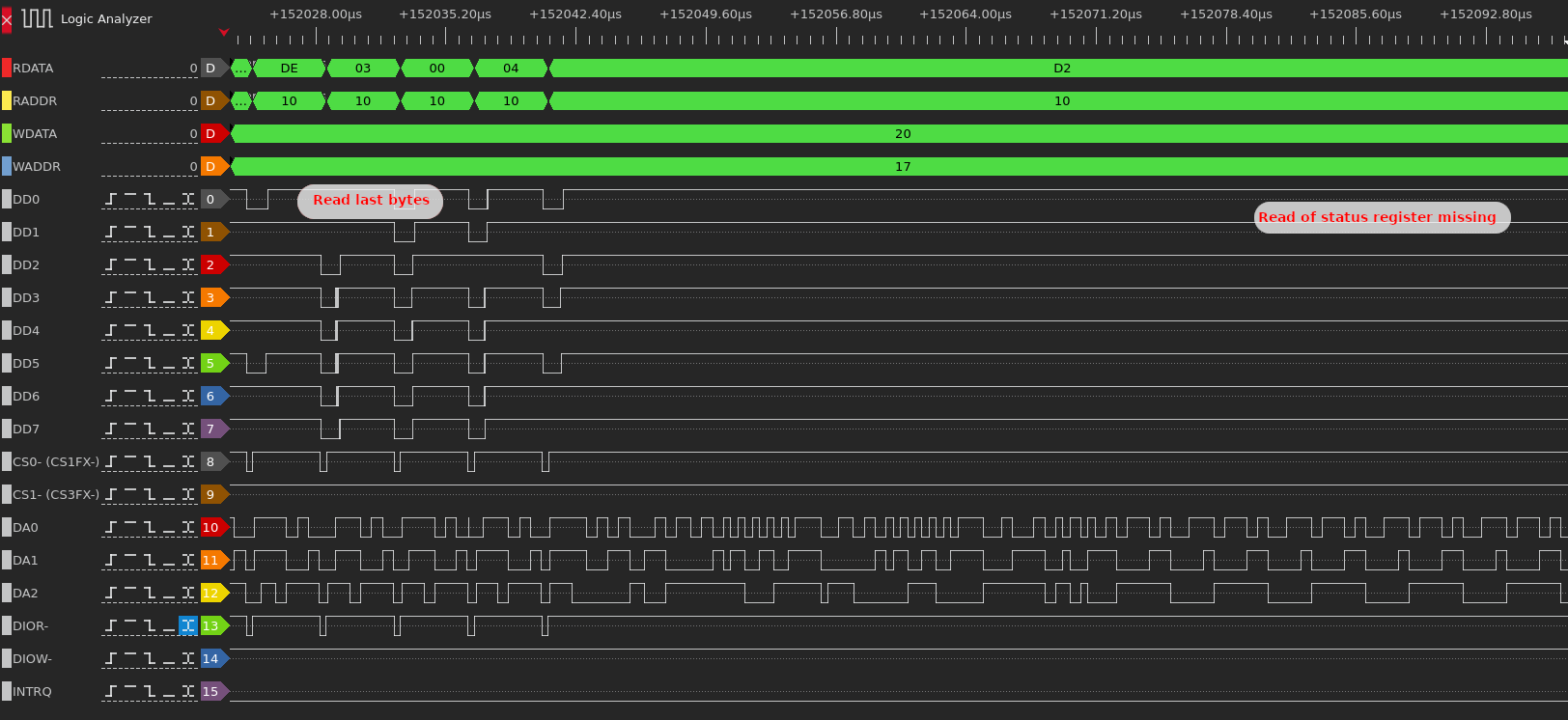

Upon closer inspection, we notice that the last read of the Status (0x17) register (after all data has been read) is missing. It is only performed 7.5 seconds later.
Going deeper, we can observe that the Seagate returns an incorrect Sector Count (0x12). It is decremented by one compared to the newer Transcend and Toshiba drives. For example, when reading one sector, the Toshiba or Transcend drive will return a Sector Count of 0x01 while the Seagate will return 0x00. When fetching 16 sectors, the Toshiba and Transcend report a Sector Count of 0x10 while the Seagate reports 0x0f.
I suspect that the Seagate drive doesn't follow the ATA specification correctly and reports the Sector Count register with an off-by-one. As the bootloader was written with the Seagate behavior in mind, with newer drives it will think that a sector remains to be read and wait for an interrupt, only to time out after 7.5 seconds. It proceeds to slowly load the OS which likes it even less and crashes.
