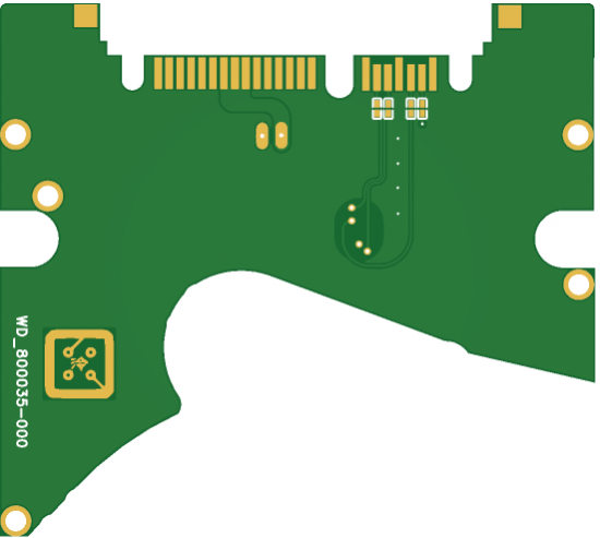

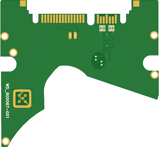

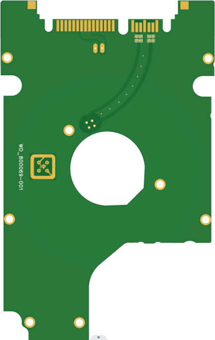

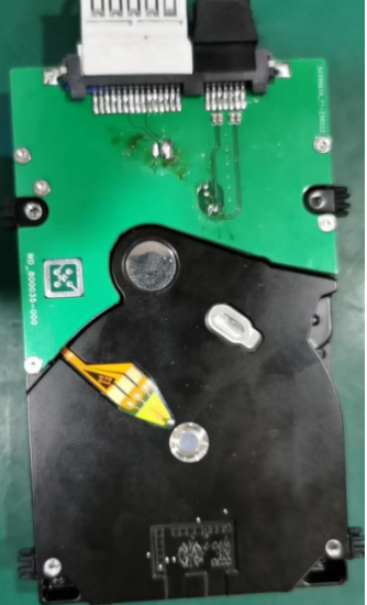

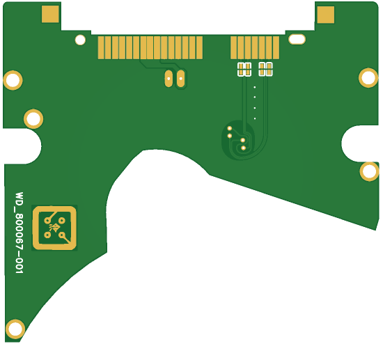

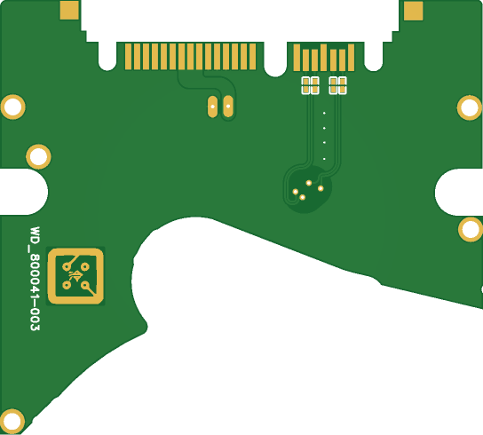

good news! Anyone can DIY for USB HDD conversion to SATA adapter. Since I've been busy recently (development, debugging for
Monolith's data recovery equipment) so only 2 models (WD-810035, WD-800067) have been tested and can work normally. I'll create more when I'm done with work.
How to use?
1: Remove the 4 capacitors connecting the USB-SATA controller to the HDD controller
2: Use an electric soldering iron to attach solder to the pad via holes marked E71/E72/E73/E75 on the PCB and the GND and +5V pads. It is recommended to use low-temperature solder. If you can buy alloy solder containing bismuth and indium, That's the best option.
3: Align the adapter with the edge of the PCB and the screw holes, and screw on the original screws.
4: Apply flux, use a soldering iron to attach the melted solder to the hole on the pad of the adapter, the adapter will be combined with the HDD circuit board
5: Use the diode position of the multimeter, the red test lead points to GND, and the black test lead points to the soldered pad. If everything is normal, it should display a value in the range of 0.35-0.45.

PCB thickness 0.8MM-1.0MM!0.8MM is the best :o

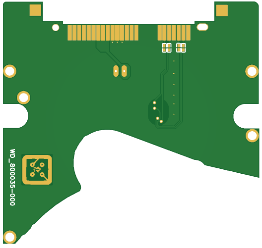

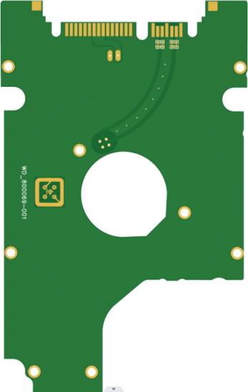

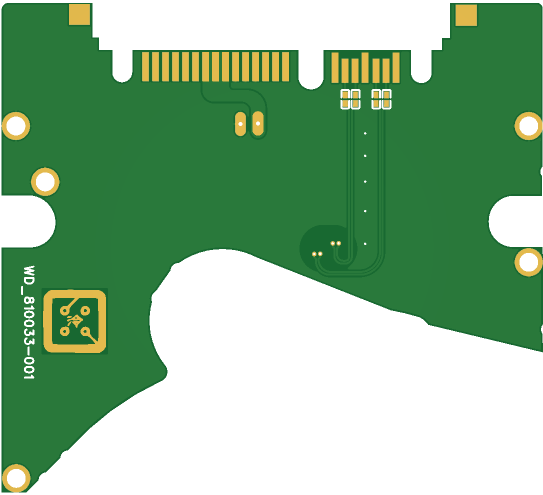

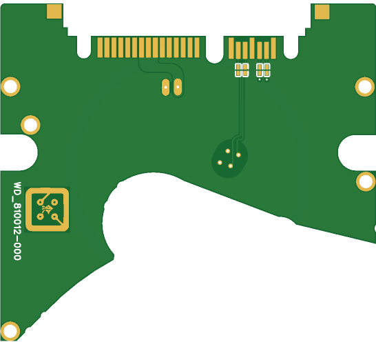

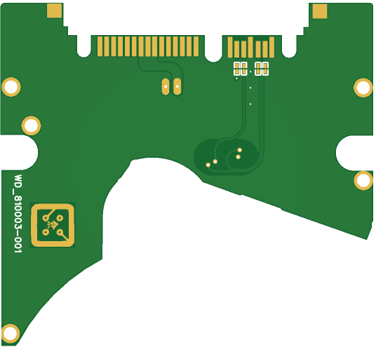

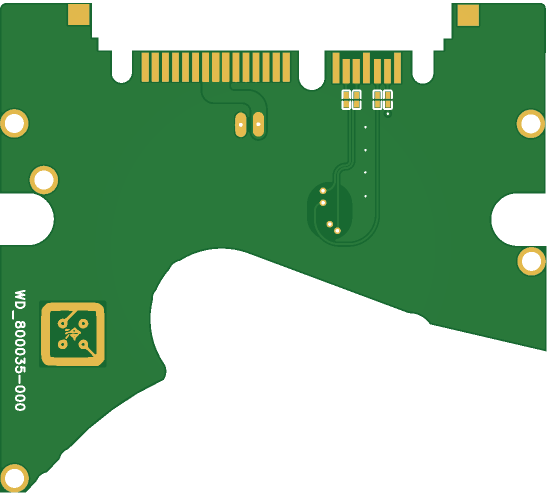

New update, draws a total of seven different versions I could find, replaced with new connector package, re-uploaded all gerber files

Some boards are tested, but not fully tested

Please note that some of the circuit board designs violate the differential pair routing rules, but this is unavoidable. If I satisfy one of the rules, I will violate the other. After careful consideration, the current state is the best I can achieve, and it has been tested to work well. I suspect this is due to the relatively short length of the transmission lines.

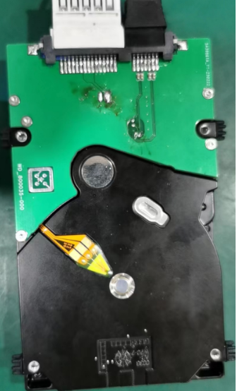

If the adapter and the hard drive circuit board are perfectly aligned in the Z-axis direction, solder can flow downward through the through-hole pads onto the via of the hard drive circuit board, completing the soldering process. That's why I chose low-temperature solder because it doesn't require the use of a hot air rework station; you can accomplish it with just an electric soldering iron. You can think of it as a manual BGA work. :lol:
Well,
Sin is sending me few pcb i do have low melt solder ,But i am of the opinion to remove board we need to desolder and then solder desolder solder desolder and solder desolder :mrgreen:

In general the characteristic impedance of SATA is 100Ohms, right?
Would PCB thickness affect the characteristic impedance?
Just trying to gain some AD mixed systems insight if you are willing to share with our usecase.
I plugged some numbers into this calculator and found that the PCB thickness does have an appreciable effect on the impedance.

When designing a 4-layer PCB, I use ATT2001 for impedance calculations. However, ATT2001 does not support impedance calculations for 2-layer PCBs. I believe the main reason is the lack of a ground (GND) or power plane as a reference. Calculating impedance requires considering the PCB stack-up design, different layers, and materials, including trace widths. In my case, I'm using a 2-layer board. If I use the bottom layer's GND as the reference plane, due to the layer stack-up, it is far from the top signal layer. According to calculations, the trace width would need to be around 22 mils to match a 100-ohm impedance, which is clearly impractical. However, in actual scenarios, impedance is not the most critical factor for signal quality in mid-to-low-speed signal transmission. In practical testing, as long as the distances are kept short and the differential lines are approximately the same length, the circuit can function properly.

well, my 2 cents are that it does not really matter in this case, if wires worked, this should work as well. Nobody has ever considered impedance when soldered wires and it worked, even without coupling caps. Perhaps at 3 or 6 Gbps (sata II or III), but for DR, you can limit port speed to 1.5Gbps without significant loss of transfer rate, coz platter to buffer xfer rarely approaches 200MB/s anyway. Surely not on 2.5" drives...
