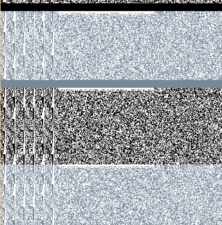

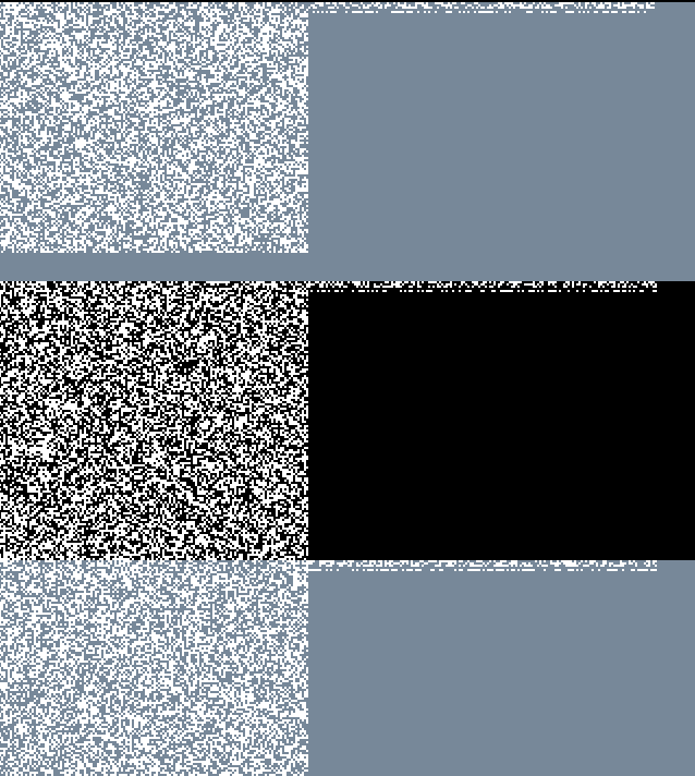

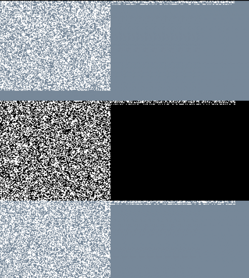

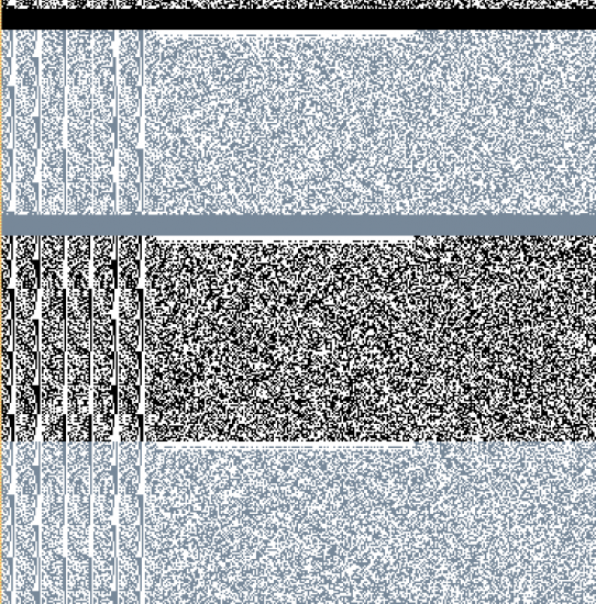

I will also add that Samsung abandoned its controllers in favor of SM in new MicroSD, UFD USB. For some reason in monolith USB they use standard configuration BCH ECC but not in microSD.
In all this chip you can find unxored marker "SMI". I also attach what LFSR looks like and there is no such thing, as far as I know, SM has never used LFSR.
