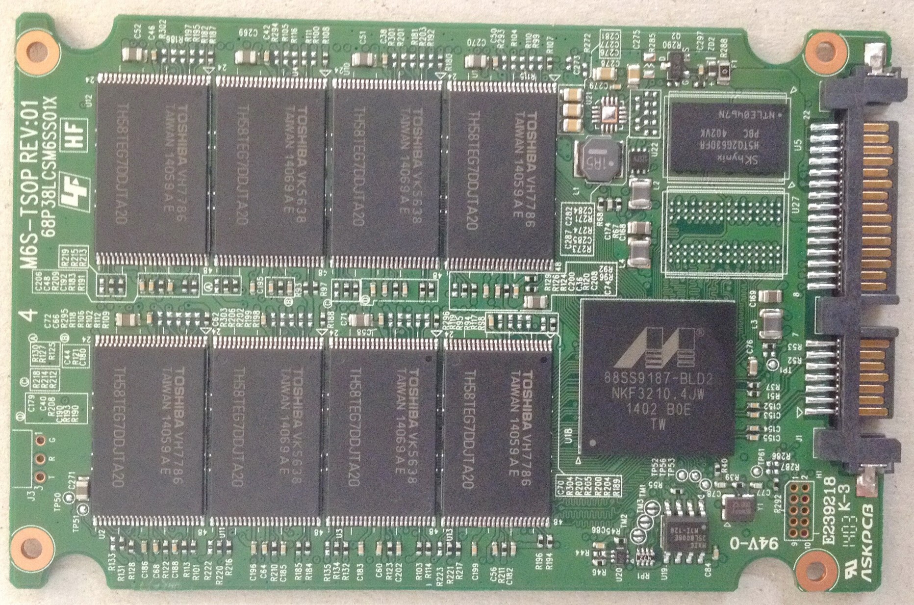

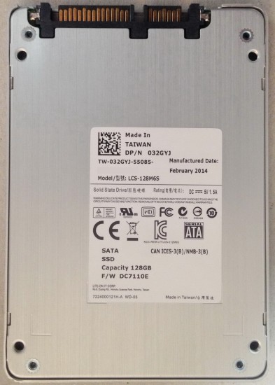

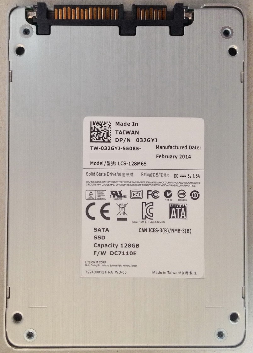

Vendor: LiteOn
Model: LCS-128M6S
Type: SSD
capacity: 128GB
Interface: 6Gb/s SATA
Manufactured: Feb 2014
firmware: DC7110E
Condition: New
Controller: Marvell 88SS9187-BLD2 (code name Monet)
Controller CPU: Dual-core Marvell 88FR102 V5 CPU
NAND chips: 8x 19nm MLC
NAND Vendor: Toshiba
NAND Laser code:TH58TEG7DDJTA20
Controller DataSheet: http://www.marvell.com/storage/assets/Marvell_88SS9187-001.pdf
I notice the string: KCC-REM-LIT-LCS-512M6S.. I wonder if this is a remanufactured/refurbished 512GB model?

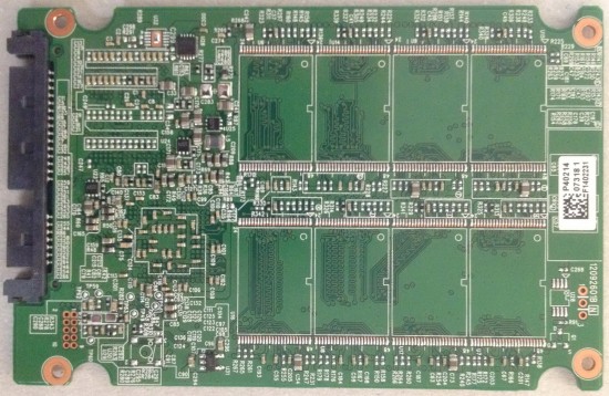

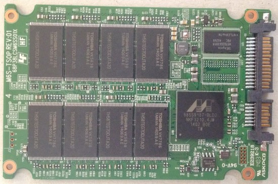

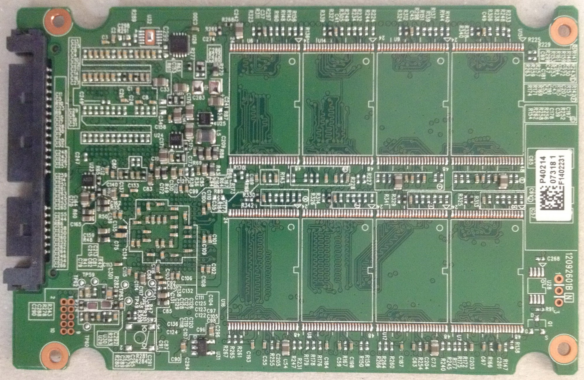

On the board, a serial port is clearly marked with TRG obviously TX RX and GND. I got no output on a serial test with Putty. Serial Console needs to be enabled?
The other unpopulated 10pin block, or the test points TP1, TP52, TP53, TP56, TP61 etc, could be JTAG. Not sure what TM1, TM2, TM3 are. I will test these soon.

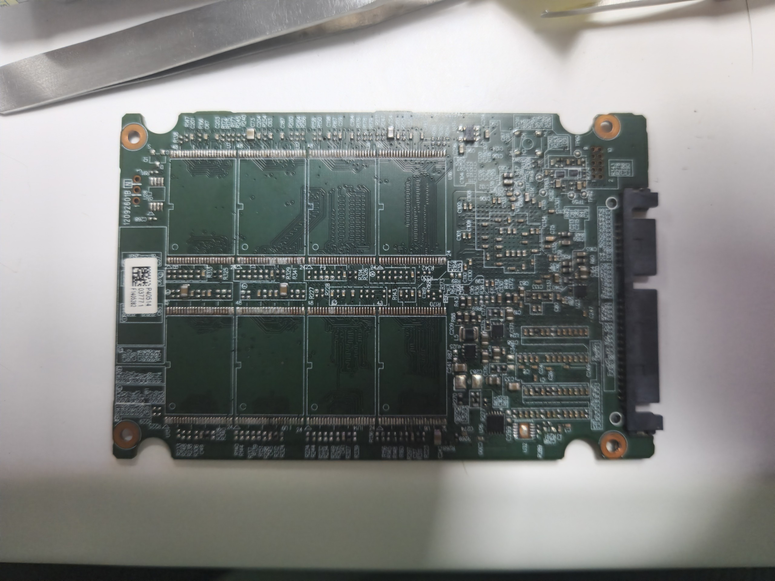

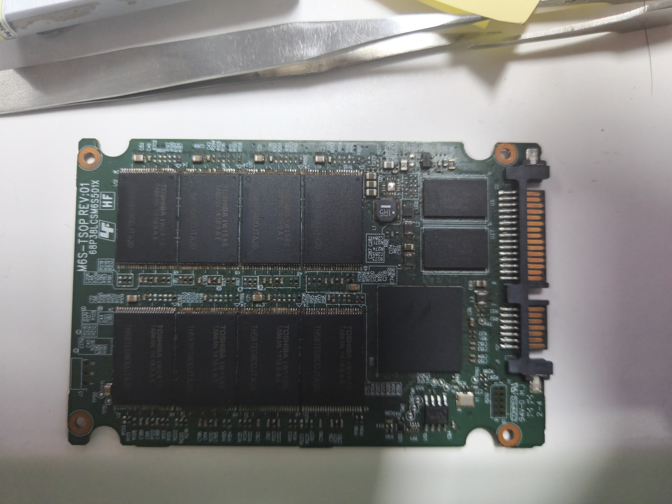

Just got one myself
Liteon it corp lcs-256m6s 256GB
Got a huge ant infestation of the SSD. After cleaning
The power of the SSD just cycles over and over The current of the 5V rail jumps up and down from 0.08 to 0.2
Probably power issues. Any information given will be a great help
 Post subject: Re: SSD Research - Liteon LCS 128M6S
PostPosted: December 20th, 2023, 1:45
Posts: 17228
Check the e-fuse (?).
Clear photos would help.
PostPosted: December 20th, 2023, 6:23
Posts: 261
Location: Vietnam

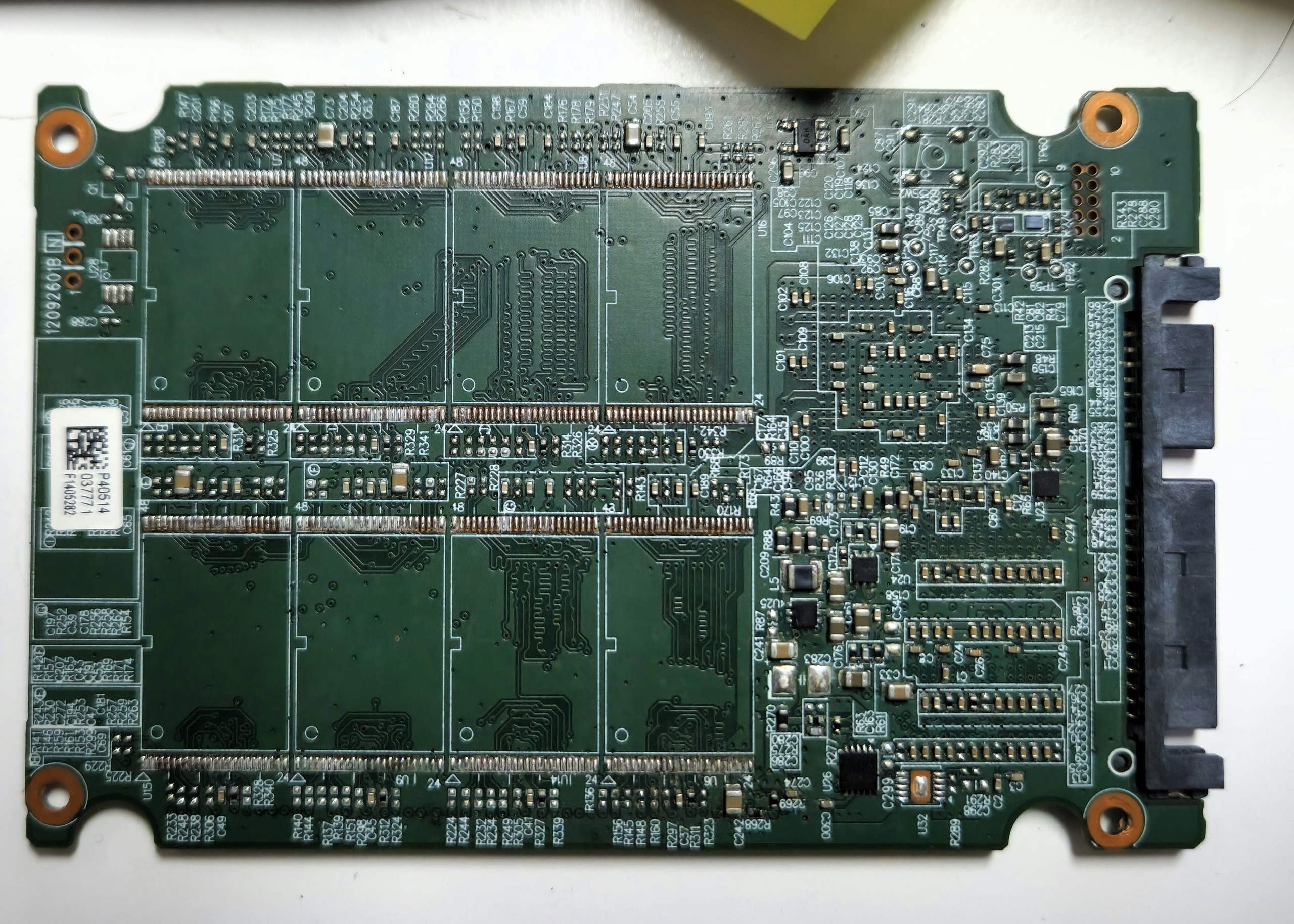

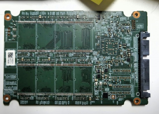

Here you go

The first photo is a bit too blurry, perhaps the "macro mode" of your camera might help if it has one?
The second photo looks like all the contacts on the flash chips should be cleaned with isopropyl alcohol.

The e-fuse is one of those black thingies.

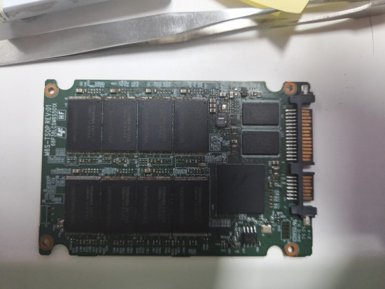

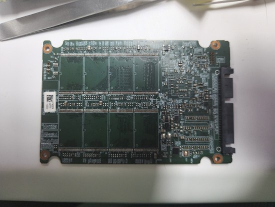

Posts: 261
Location: Vietnam
Yeah im starting with those chips 1st
Here is a better photo
So i cleaned the chips. The issue still remains
I got the footage
https://www.youtube.com/watch?v=B4yFUejMj3Q&ab_channel=TheRecoveryGuy
