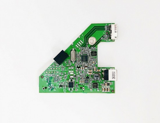

does somebody have the related dump or the drive that is willing to make a dump please?
I checked Ebay, but there are just complete drives available, not just the enlousure with the USB board.14TB are available though.
In the past I got the 14TB EasyStore enclousure with USB board and managed to get it run with the WD140EFFX (14TB Red Plus) and via WD Formatter to format it in XP compatability, Im able to use the full MFT partition size of 14TB.Recently I got the WD16KRYZ (16TB Gold) to try to get the max supported MFT partition and tried with my spare USB board with 14TB Easystore FW, but the WD Formatter can't even detect the drive, so would like to test the 16TB FW if any luck.Did somebody look closer at the USB board FW? I can provide images from 14TB EasyStore and WD 14TB My Book if interested.
 Post subject: Re: WD EasyStore 16TB USB bridge FW Wanted
PostPosted: January 30th, 2024, 2:45
Posts: 2857
send the photo of the required usb board
PostPosted: January 31st, 2024, 7:35
Joined: January 22nd, 2021, 11:42
Posts: 19
Location: Czech Republic
The board is actually same like in most of the 3.5" WD enclousures like EasyStore, My Book, Desktop Elements only with different onboard FW.
PostPosted: January 31st, 2024, 8:17
Posts: 2857
It should work, hdd size doesn`t matter ( i thought new)
ur problem is mostly the drive itself, seek pro. help better before you attempt to do anything
with the 14tb drive few people sadly
again for explanation, the 14TB WD Red works with this USB bridge , that I got from a 14TB EasyStore.
The problem is with a WD 16TB Gold and this USB bridge from a 14TB EasyStore.
