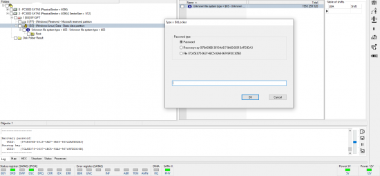

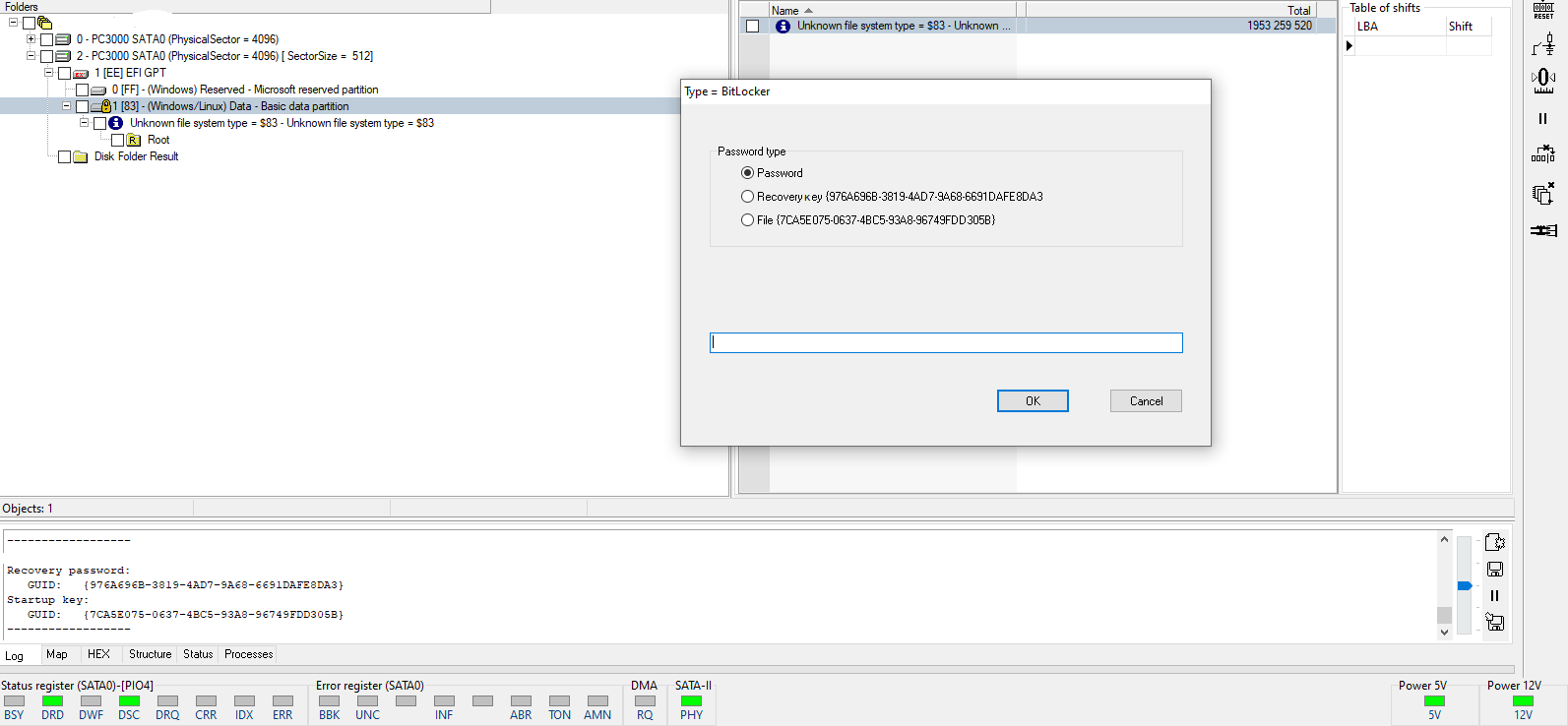

One of my customer has formatted OS SSD and afterwards his hard disk (both from laptop) has become inaccessible and is showing bitlocker encryption.
Customer is not aware of bitlocker & is not having microsoft account as well.
clear key bitlocker volumes can be decrypted in DE which asks me whether to decrypt. It shows both GUID for password & startup key . DE also shows volume label as well.
any suggestion pls.

udma or anyone can decrypt only suspended bitlocker volume ( Drive is technically encrypted but encryption key is stored in unprotected volume).
VMK is clear key.
In this case it seems active protectors are present. Recovery might not be possible unless -
1) You can brute force using quantum computer
2) You are MS having backdoor
3) you are 3 letter agency.

I would like to know because in DE volume label is visible .Is that means MVK is somehow available ? I have carved bitlocker metadata & volume header , is it of any use?

Though keys are stored in multiple locations , its not like a file . I thinks its of no direct use.
