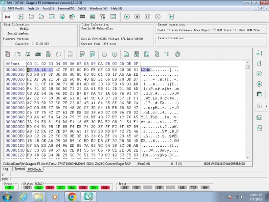

 Post subject: 10tb seagate ROM
PostPosted: July 8th, 2025, 1:03
Posts: 153
Location: Karachi
hi

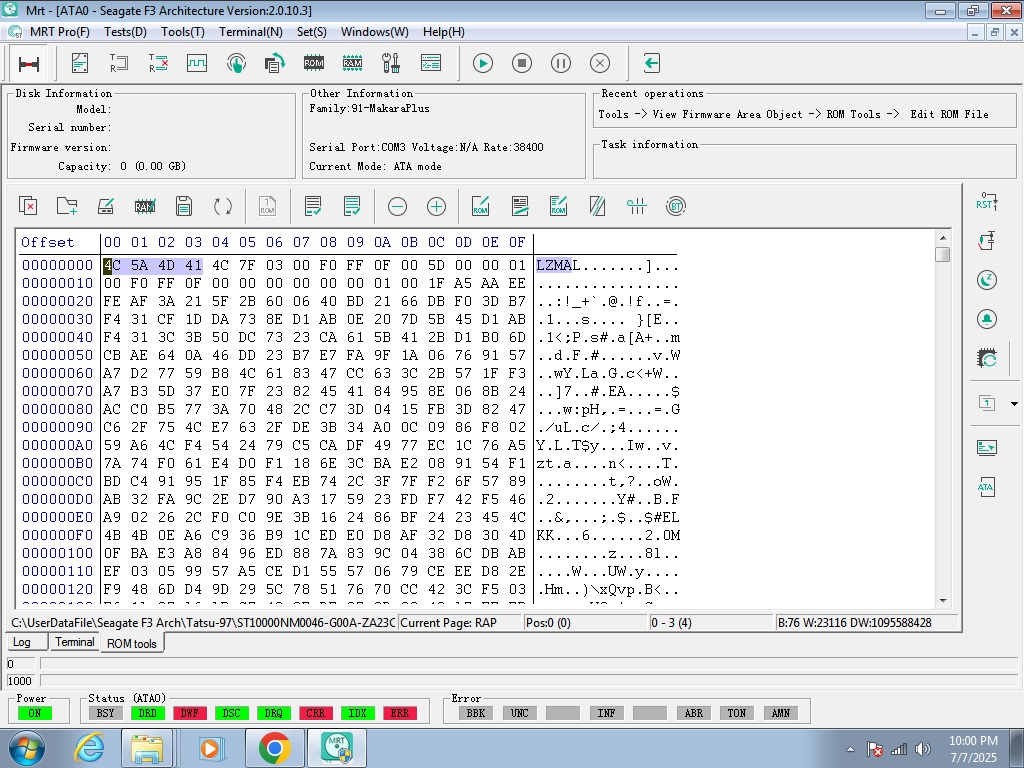

what is this four offset
 Post subject: Re: 10tb seagate ROM
PostPosted: July 8th, 2025, 4:08
Online
Posts: 4848
probably the start of your compressed RAP segment?
