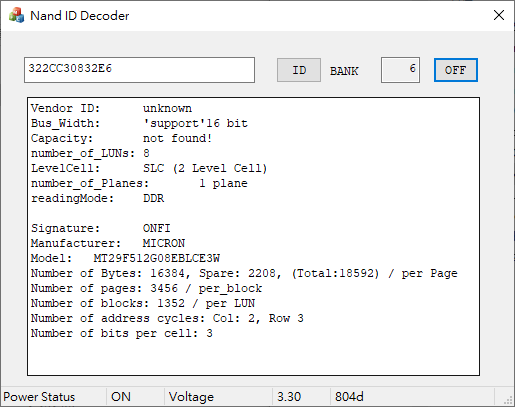

This program is based on the webpage of ACE blogs.
https://blog.acelab.eu.com/pc-3000-flash-determination-of-some-chip-parameters-by-id.html
If you are also interested in it, you can download it from attachment.
NIDD.rar [116.03 KiB]
Downloaded 1349 times

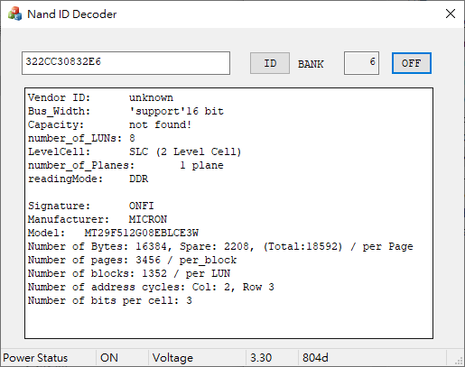

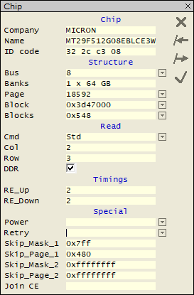

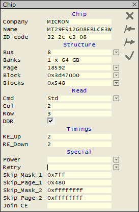

I add ONFI data for this software. And it will be helpful to make config(chip.txt).
for example
Pages = 18592
block=Number_of_pages_per_block * pages= 3456 * 18592=64253952=0x3d47000
blocks=blocks_per_Lun=1352=0x548
The skip page is from my bitmap viewer.
The skip page of the final result is different to the database in FlashExtractor. But I think mine is correct in my case.
