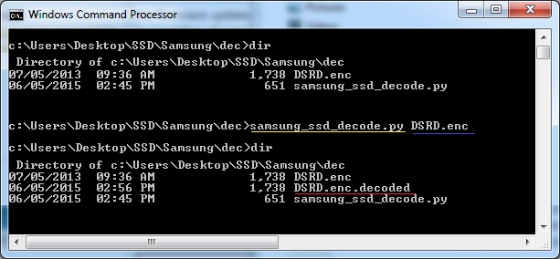

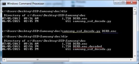

For firmware update ISO's, you can strip out the relevant DSRD.enc update info file and, for example, "DXM06B0Q.enc" firmware files in a number of ways.
here are a few steps that work:
1 .Right-click and choose extract using 7-zip.
2. Open the extracted folder, then navigate to the appropriate disk image that holds the firmware. it will be called something like "Bootable_2.88M.img". Depending on the ISO, if it is a DOS or Linux based boot, the files will be in various places, not hard to find. Interestingly there is also mac trash files and deleted firmware, looks rather sloppy TBH.
3. Extract the files from this image, you can use winhex to parse the image, probably even R-Studio or GetDataBack..or whatever. many ways to do this.
4. find the firmware files. DSRD.enc and DXM06B0Q.enc are examples.
5. copy "samsung_ssd_decode.py" to the same folder and run it.

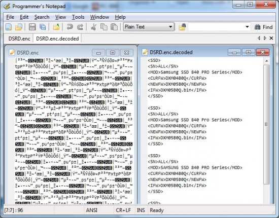

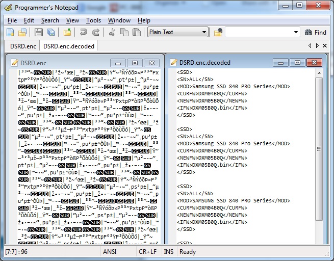

here is before and after screenshot, but the actual firmware file is probably WAY more interesting ;)
I have some other stuff I am working on, hopefully I can get something interesting to share out of it.

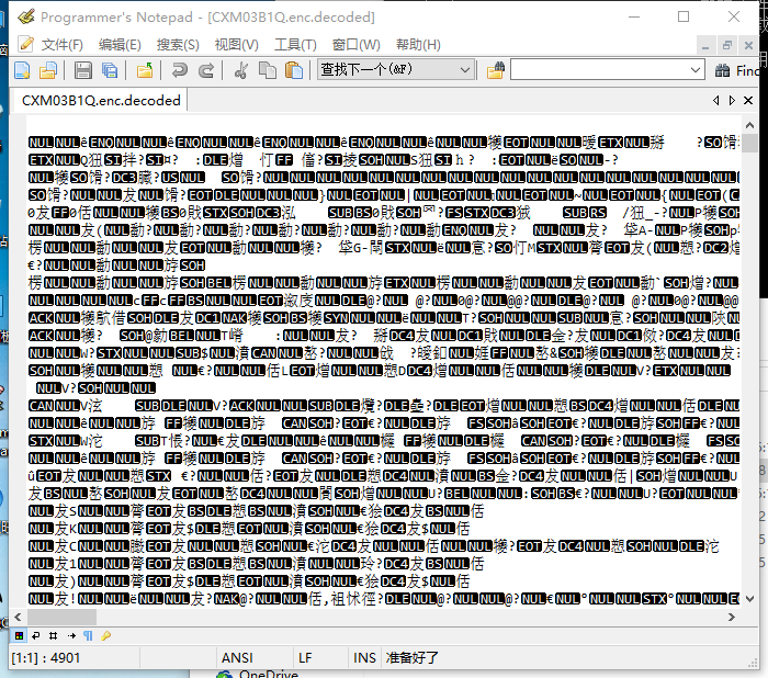

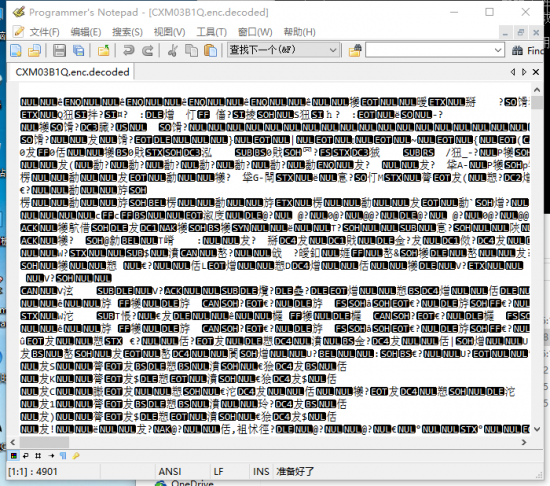

@HaQue
I want to edit "dsrd.enc",so I use "samsung_ssd_decode.py" to change it ,but how to change "dsrd.enc.decoded" to "dsrd.enc" ? and can't use
"samsung_ssd_decode.py" to change "CXM03B1Q.enc".
