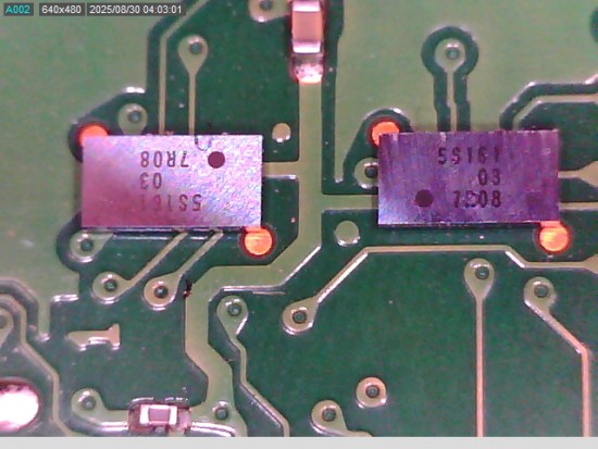

i want to read rom.
10tb seagate.
is that possible wihout soldering
any connector like this ?
https://www.aliexpress.com/item/1005003937748732.html

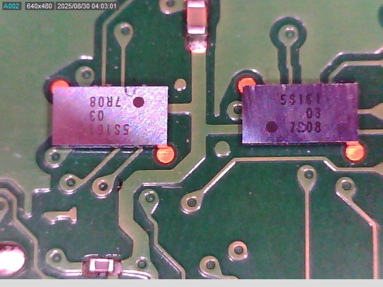

any information about these 2 roms
both ic/chips have 2mb data
the rom have 2 copies ?? or
one chip/ic have 1mb data
when we read rom via mrt shows 2mb.
which rom mrt read,
which rom we need to read for UNPACK with F3 ROM
Explorer,
any any any information/details, about
please
please
please

If you read one ROM using MRT, you can read the second one, just swap the first pin

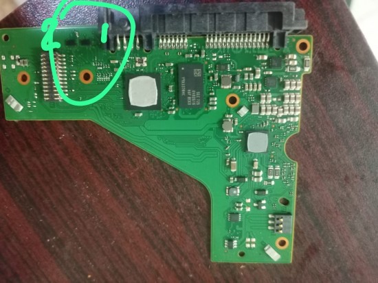

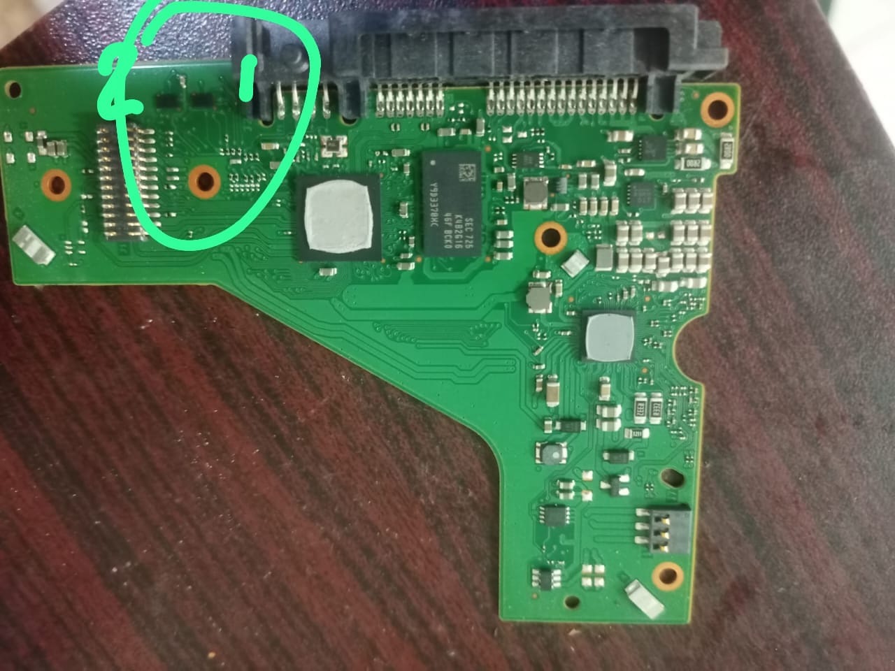

sir
just few say few words, ( just swap the first pin)
how to do this.
please

You need to swap the CS* pins so that ROM1 becomes ROM2 and ROM2 becomes ROM1. However, it's not clear to me which trace is CS*. You'll need to do some investigative work.
https://www.onsemi.com/pdf/datasheet/le25s161-d.pdf

Two ROMs have seven contacts connected to each other, they need to be found. One contact will remain, the first one.
