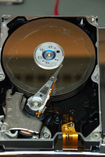

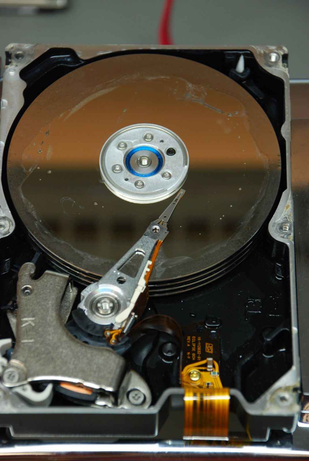

Ok, one photo ;)

interesting how successful was the recovery of this drive how did you clean the other platters
would love to know more
 Post subject: Re: Disk after flood - recovery
PostPosted: June 3rd, 2010, 8:12
Posts: 922
No success unfortunately. Heads are gone, massive platter destruction.

Well, the drive on the picture was a Quantum, so if heads were gone even if media was recovered to acceptable conditions, THIS was the biggest problem.
BlackST has right.
When is clean water it is "quite easy" to recover data, but what about slime?
