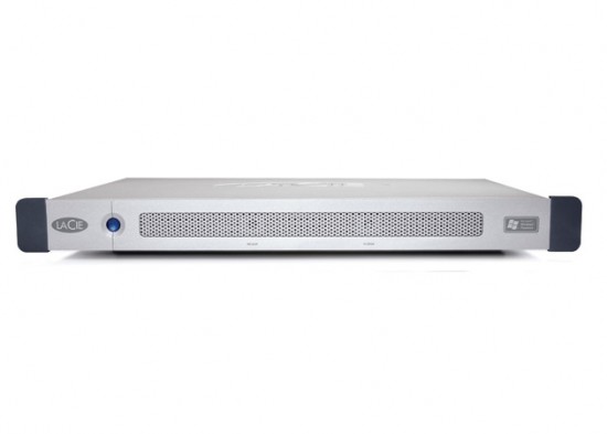

Well I had a Lacie netowork unit once with 4 500Gb MAxtors as a RAID 0.
Two disks had platter damage but I got 350Gb of data recovered off it. Now who da man!
