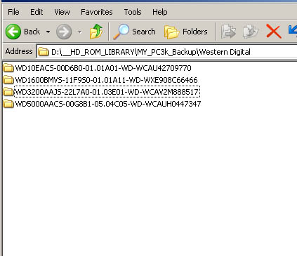

BytesBack
well this is what i have for now, but if you wait for 2 days more i will update my library here coz have alot here, need to sort them coz took it from friend of mine

BytesBack
from the image i posted, tell me which one u wanted so i can attach here

Einstein,
The one you had highlighted would be the one I need. WD3200AAJS-22L7A0. Providing it is that firmware revision of course. If you send it I can always check it out.

BytesBack here u go
let me if it works with u
ROM.rar
double chk it before using
(182.44 KiB) Downloaded 766 times
