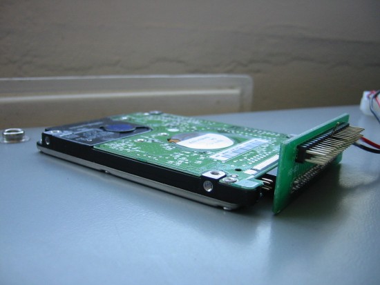

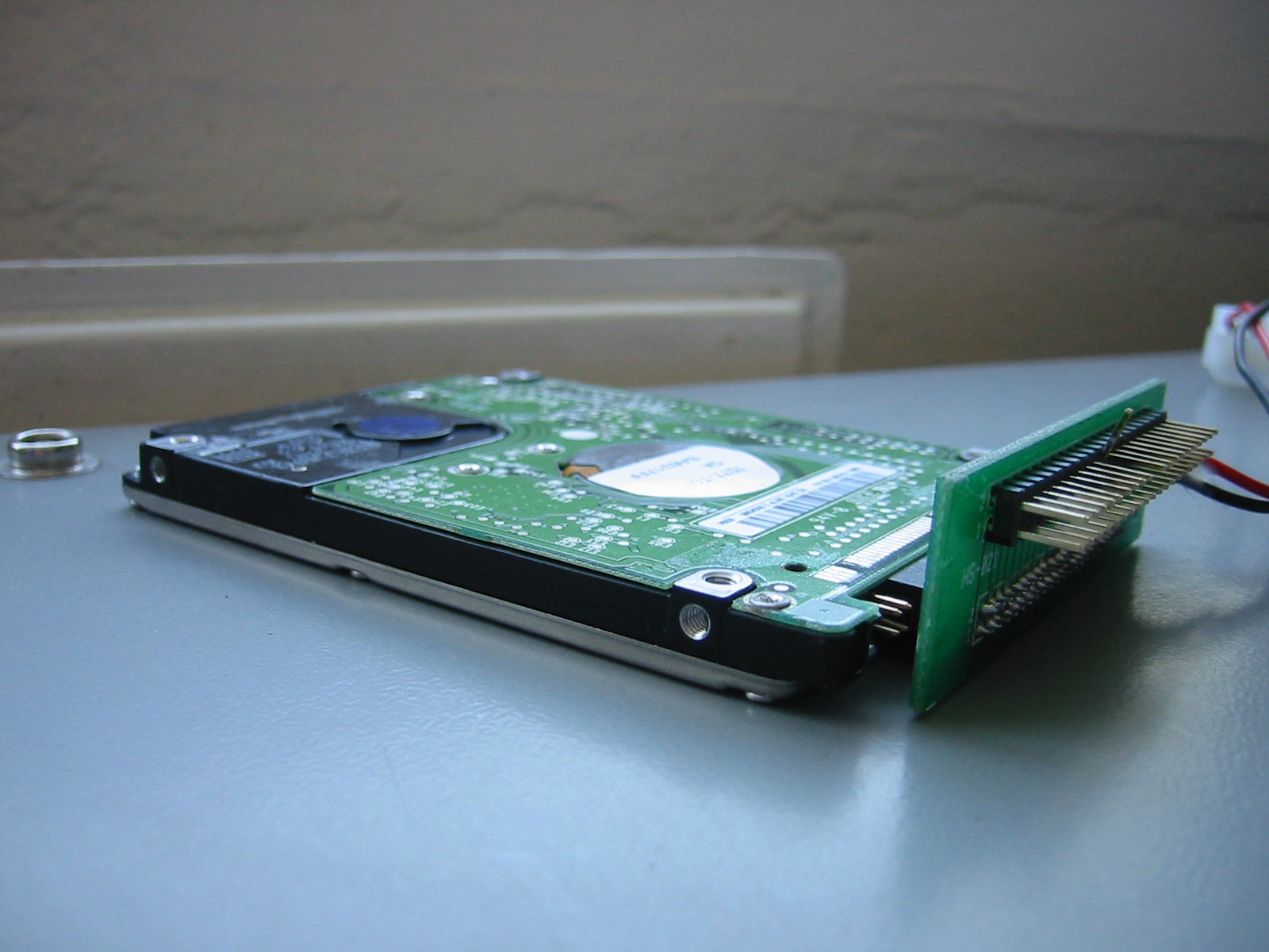

for future ref I have attached a photo of the 2.5" / 3.5" adapter
