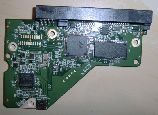

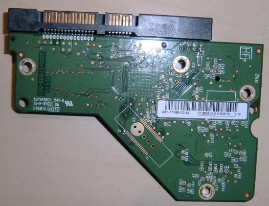

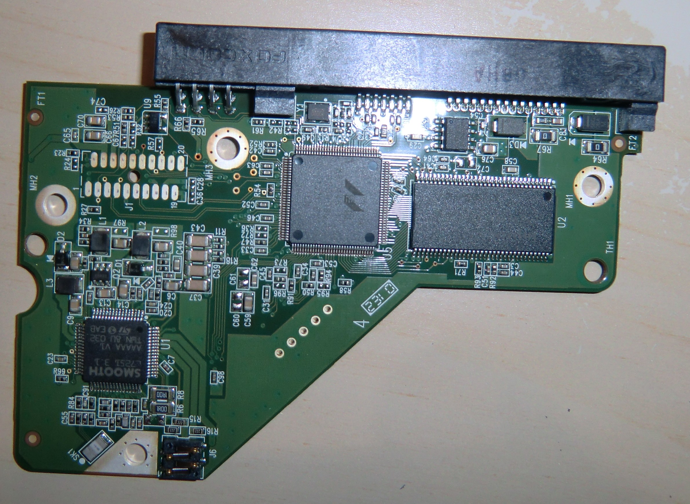

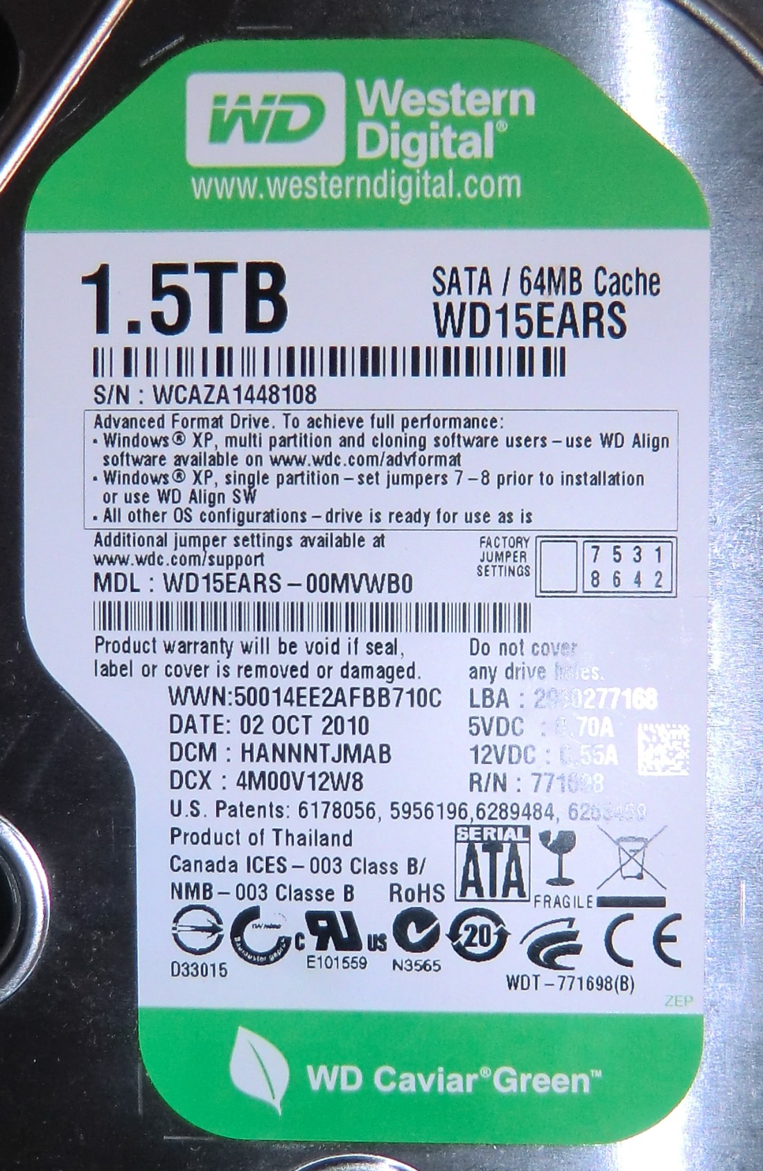

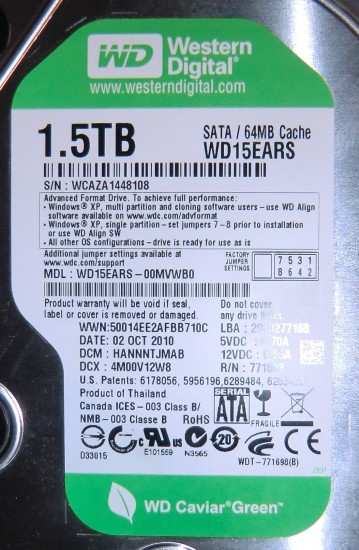

Hello I'm searching a PCB for WD15EARS-00MVWB0 and shipping to Germany.

Why you think that you need a new PCB?
PCB do not appear to be damaged...

The hdd was in an USB rack and somebody pulled the cable off. Since that the hdd spins up, but is not detected by the controler.
 Post subject: Re: PCB WD15ears-00MVMB0
PostPosted: June 30th, 2011, 14:44
Almost certainly NOT a PCB fault if the drive spins up and sounds normal (i.e. does not spin down again)

Any other ideas to fix the problem, than change the PCB?
PostPosted: July 1st, 2011, 4:55
Joined: March 8th, 2010, 15:44
Posts: 176
Hi
Did you already check the diodes?
Is the first thing to do.
PostPosted: July 1st, 2011, 7:57
Joined: June 29th, 2011, 10:44
Posts: 7
Location: Germany
I didn't, but i will if you thing, that is necessary. Is it enough to check D3 and the one near R64, or must i check all?
PostPosted: July 1st, 2011, 10:11
Posts: 176
Is better checking all.
If you see that they are all ok you can see if when you connect the drive to power cable the main chip gets really hot..
If the controller gets really hot he can be damaged.
PostPosted: July 5th, 2011, 4:49
Posts: 7
Location: Germany
First I checked all diodes, they are ok.
Then i connected only the PCB to power, the mainchip was getting hot. But i needs 3-4 Minutes, till it was to hot to touch.
What do you think?
PostPosted: July 5th, 2011, 5:52
Posts: 1091
Location: Angel Data Recovery
Surely usual SadleG6 problem (not with PCB) , and enclosure probably some WD MyBook with encryption. :)
Often issue in present time.
Angel Data Recovery
PostPosted: July 5th, 2011, 6:19
Posts: 7
Location: Germany
Do I understand you correctly, you think that the HDD is encrypted? If so, I can tell you that it is not. But you are right, it was in a My Book Case.
What does SadleG6 meen?
PostPosted: July 5th, 2011, 7:05
YOU might not have encrypted it, but the MyBook enclosures DO usually encrypt them unbeknown to the user.
SadleG6 is the factory name for this family of drives, and there are known issues with them.
PostPosted: July 5th, 2011, 7:48
Posts: 7
Location: Germany
But even if it encrypt itself, shouldn't it detected by the Bios?
If i connect the HDD before bootup, the PC's freezes at SATA Setup and no drive gets detected.
PostPosted: July 6th, 2011, 7:00
Yes it should if the drive it not faulty, but yours clearly is.
This drive needs pro assistance to work with the (probable) firmware problem with it.
