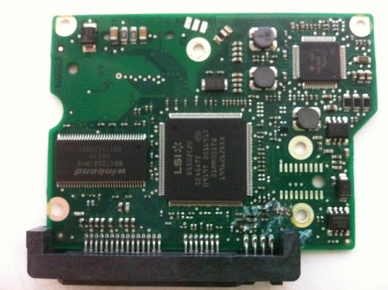

Seagate Barracuda 7200.12 500GB
ST3500418A​S
PN: 9SL142-301
Firmware: CC35
Date Code: 10015
Site Code: TK
Chip: B5502C20
I included a pic of the current burned up board.
I need to get a replacement board and any thoughts from you guys if you think I can just replace the board to get the data off the drive.
File comment: burned up on the bottom right

You will definitely have to move the 8-legged ROM chip, which is one of the ones on the right hand side. Can't remember exactly which one from memory and I can't read the numbers on your pic. Pretty sure it's the corner one though.

Yes its the right corner chip .

This supplier includes a "firmware transfer" and postage in the price (US$50):
http://www.onepcbsolution.com/seagate-b ... 00418.html
Here is the chip that needs to be moved:
http://www.users.on.net/~fzabkar/HDD/ST ... 5V_TVS.jpg
BTW, I can see some fluff (?) on your board, but I can't see any burn marks.
