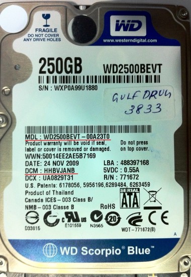

 Post subject: need WD2500BEVT-00A23T0
PostPosted: October 26th, 2011, 11:06
Joined: October 26th, 2011, 10:42
Location: Dubai
Hope I wont be dissapointed...
am looking for Western Digital WD2500BEVT-00A23T0 with DCM - HHBVJANB
My recovery guy told me that atleast the 5,6 letter of DCM along with the model number should match..
PLease help..as am about to face the consequences of not keeping a healthy backup
please find teh attached pic for the same

Am able to find a couple of them but the model number refers to WD2500BEVT-22A23T0 instead WD2500BEVT-00A23T0
will this work?
 Post subject: Re: need WD2500BEVT-00A23T0
PostPosted: October 27th, 2011, 3:52
Posts: 3550
If the DCM is what it should be, it should work.
PostPosted: October 27th, 2011, 13:41
The "22" vs the "00" is of no concern.
PostPosted: October 30th, 2011, 4:48
Location: Dubai
IF 22 vs 00 is of no concern..then I should try my luck with 22A23T0..what do you think.
The recovery team told me that its the 00 and 22 refers to the firmware version and it should match..is it realistic
PostPosted: October 30th, 2011, 10:38
If they think that, then they are no "recovery team" at all :-(
PostPosted: October 31st, 2011, 6:43
Posts: 3550
Agreed. We just told you the 22 vs 00 is of no importance in this matter.
If the "recovery team" insists, well, then... :mrgreen:
PostPosted: November 1st, 2011, 4:05
I strongly suggest you choose another "recovery team" if you value your data at all.
