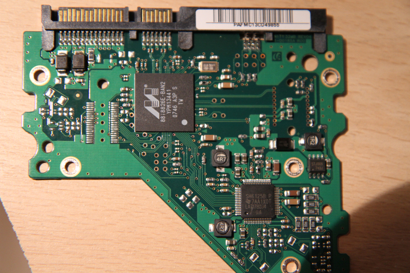

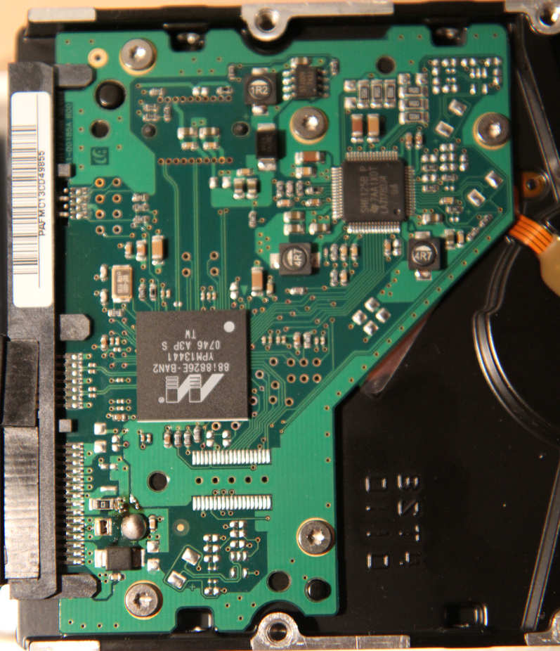

on request .. here some more details + image:
The HDD was usually mounted in an external case (icybox), which was usually made for two HDD and worked well there. After we mounted a second one - everything seemed fine. But when I looked at the case some hours later, the whole case had stopped working. It took me a while to notice, that when I remove this HDD, which is the subject here, the case inclusive the other HDD started up again.
The removed HDD though just did not start up at all. Bringing it to a single external case only set the power control lights of this case to flickering - thus we assumed, that there is an issue with the electronic circuit.
Meanwhile, as mentioned before, I got the HDD starting, when I had swapped the PCB from an elder model of the same SAMSUNG HDD HD753LJ ... but I did not get it recognized .....
... so that's basically the story .. I also enclose an image .. I hope it's good enough - as I only have my mobile around at the moment ....
Thank you for your immediate reply.

Check the two TVS diodes near the power connector for short circuits. Use a multimeter on the 200 ohms range. Also check the zero ohm resistor. It may have fused open.
The faulty diode can be removed, and the resistor can be replaced by a short length of wire, or a 2A picofuse. Just be sure that your PSU is OK, as you will no longer have any protection on the affected supply rail.
For continued protection, you can replace the 12V and 5V TVS diodes with an SMBJ12A and SMAJ5.0A, respectively, from Farnell, Mouser, Digikey.
Good luck.

is it me or can you see a blown ic chip there right at the top ?????????
for sure that looks damaged to me :shock:

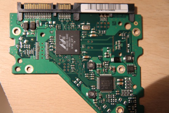

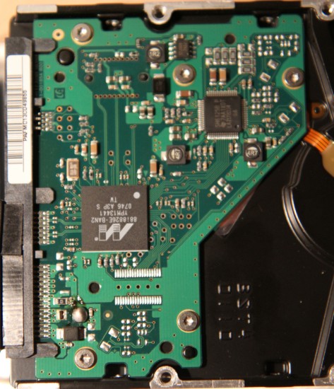

Same problem as mo2this. Lot of pro + personal data to recover.
Left TVS diode (near to power) seemed burnt. Checked with multimeter, it is totally shorted cut.
@fzabkar : You are a genius
I simply disconnected the diode and brazed the diode end. That was it !
Thanks :)
