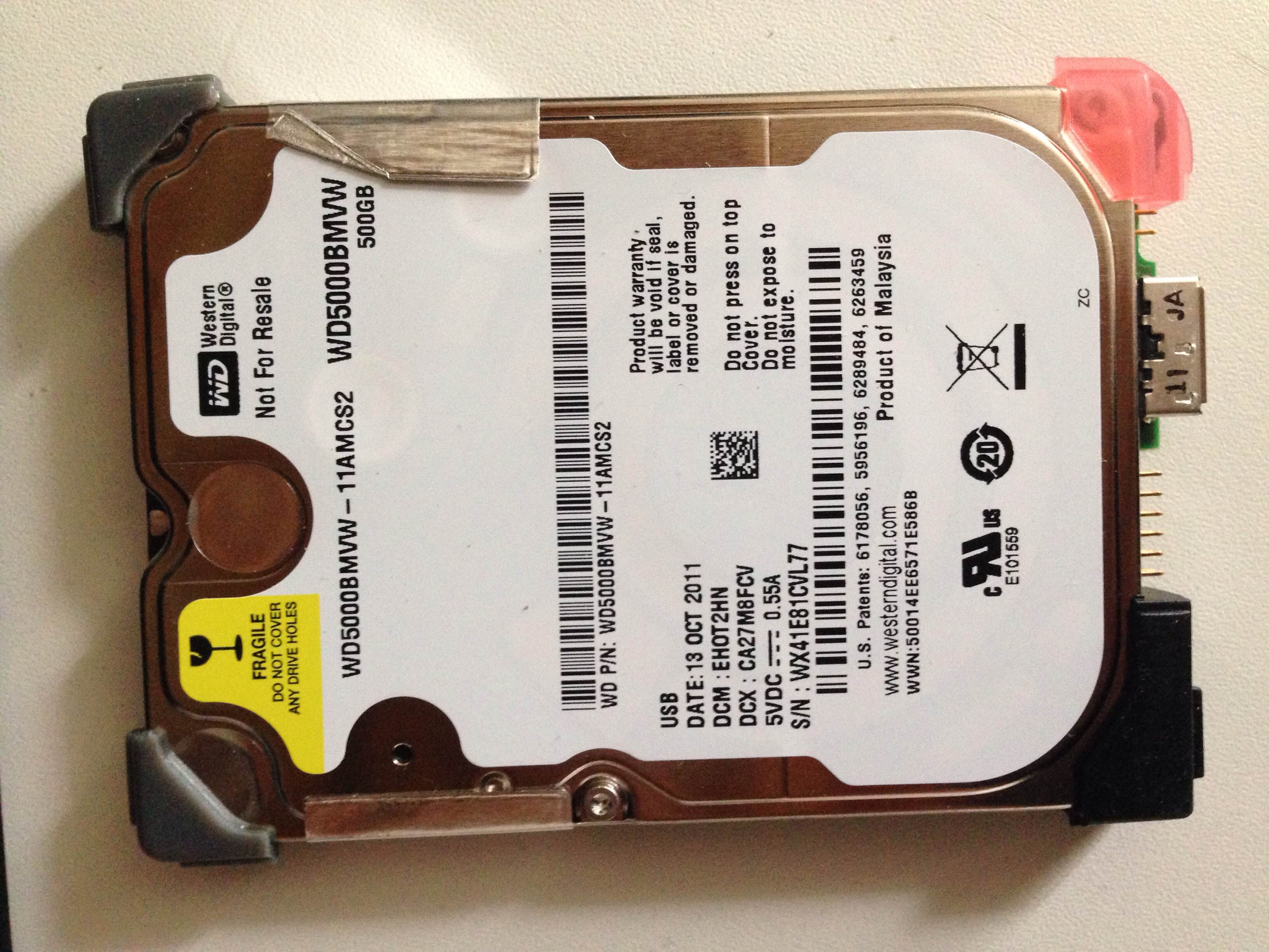

Hello people out there :)
The external HDD of a friend crashed on the floor when it was connected to the computer.
I need heads for the :
WD P/N : WD5000BMVW - 11AMCS2
DCM : EHOT2HN
DATE : 13 OCT 2011
DCX : CA27M8FCV
S/N : WX41E81CVL77
Product of Malaysia
Two photos are joined to this post (hdd opened in a DIY Cleanroom ;-) ).
This HDD contains only 3 heads. The top surface is not read by a head.
Thank you and happy recovery !
Alexandre
File comment: HDD Opened with 3 heads only
File comment: HDD cover photo WD5000BMVW - 11AMCS2 - EHOT2HN - 13 OCT 2011 - Malaysia

I've checked on your website and it seems that this model is closer to mine than the one you are offering :
Link : http://www.harddrivesforsale.com/wd5000 ... amcs2.html
What do you think ?
Does someone have an advise ? :)
Thank you !
 Post subject: Re: Need heads for WD5000BMVW - 11AMCS2 - EHOT2HN - 13 OCT 2
PostPosted: July 25th, 2014, 2:35
Posts: 3551
These are quite interchangeable, so most probably they will do for you, as long as the head map is correct. Yours is 0,1,2 so a drive with HM 1,2,3 won't do. So be careful.

The HDD has been restaured by using the http://www.harddrivesforsale.com/wd5000 ... amcs2.html donnor :)
Thank you all for your help :)
PostPosted: August 8th, 2014, 8:52
"Restaured"? As in now it works and data is accessible?
PostPosted: August 9th, 2014, 5:12
Joined: July 18th, 2014, 14:07
Posts: 10
Location: Paris
Yes, I opened it in a DIY cheap glovebox and moved the heads.
When connecting it back to laptop, it did many noise but worked. After that I imaged it with dd_rescue for 3 or 4 days.
I finally obtained ~40% of readable sectors (the starting and end of the disk sectors zones where heavily corrupt).
After that a photorec pass was used and recovered files parsed a little with a custom bash script (for adding relevance, removing dupes, sorting, ...).
I could maybe do better with professional tools. I don't know if in Paris there are geekly professional for experimenting a different approach for comparison.
