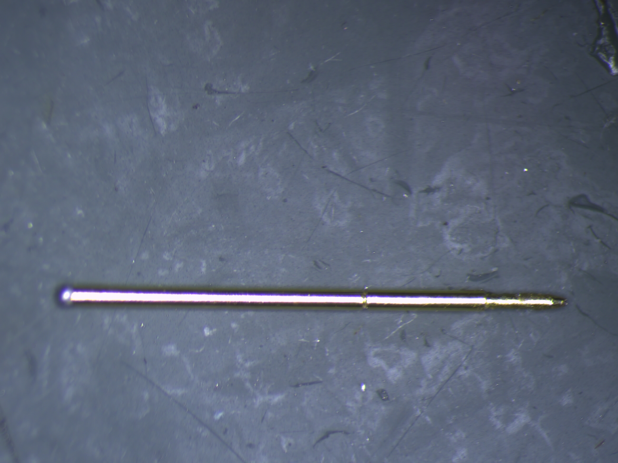

Anyone have more recent contact details fo Alex. Sent an email to the address above but no reply.

Lardman wrote:
I've tried to get hold of these twice via Apexlabs and wasn't able to, Not sure if they're actually still available.

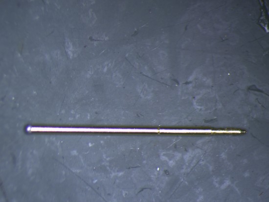

Thanks Mike. I am actually only after some of the pogo pins used in the socket. One of mine has locked up and needs replacing. There are literally 1000's of pogo pins and its hard to track down the right size anf type. I was hoping Alex could give me the specs.
 Post subject: Re: Socket for microSD 3x7 --- 3in1 PC3000, FE, Rusolut
PostPosted: June 20th, 2025, 4:06
Posts: 1303
I used some P50-B1 20g in a similar project recently, the pressure on the tip was the main concern. The selection narrows dramatically the finer you go on the scale do you have a picture of them - specifically the tip type, can you measure what's already there with callipers or are they in accessible?
PostPosted: June 20th, 2025, 10:46
Posts: 1772
Location: Phoenix, AZ USA
Overall length - 12mm
Tip Length - 1.87mm
Tip width - 0.37mm
Tip length - 0.5mm
I have done extensive searching but have not found one.

Posts: 1303
PA-038 looks about right possibly and F tip.
PostPosted: June 20th, 2025, 11:23
Posts: 1772
Sorry I gave you a bum steer there with the body width.
This is what I should have detailed
Tip Length - 1.87mm
Tip width - 0.37mm
Body Width - 0.5mm
PostPosted: June 21st, 2025, 3:49
Posts: 1303
I can't find anything at the usual suspects either - the 0.5mm OD on the barrel appears to be the main problem. I can find similar at some niche places but they all have a different metric off. If you can't get anything you could drill out the VCC & VDD to use a more common size and swap those pins into the control/data lines.
