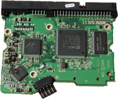

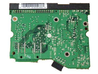

I need a working PCB for the following drive (I can sell the drive also, because I think, that only the PCB is damaged and need not to recover data):
Western Digital WD2500BB-22GUC0
DATE: 25 FEB 2006 (Canada ICES - 003 Classe B)
DCM: DSCANT2CA
PCB number: 1061 - 701266 - 200 AK XW 1U43 97LQ 4 0004340 6344
Would be great, if anyone has infos how many numbers should match.

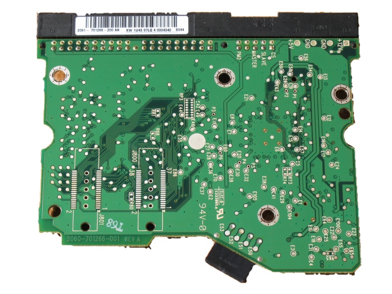

You need to use the number that is imprinted into the PCB - not the number on the label.

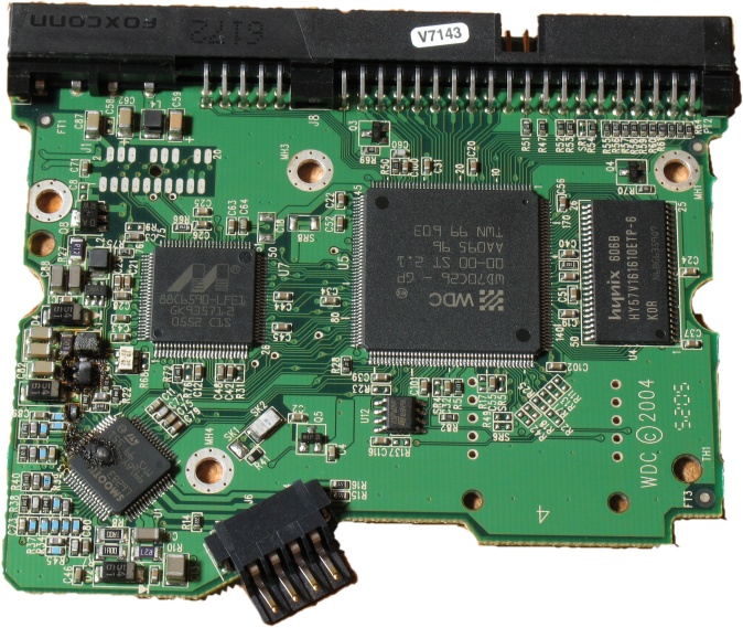

Tell me the number on the main CPU eg 7022gp or 7020sw .

Here are pictures from PCB back and front.

I have this pcb PM me for more details .
