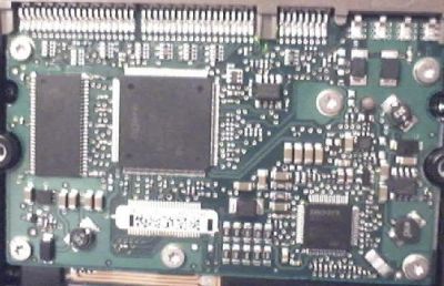

My drive spins up, but will not recognize in Bios. Need replacement controller.
SEAGATE BARRACUDA 7200.8
300 Gbyte
ST3300831A
FIRMWAR E 3.01
No visible damage to board, but I'm desperate- worth the $$ to try.
Re: WANTED: SEAGATE BARRACUDA 7200.8 300 GIG ST3300831A FIRMWAR
July 17th, 2008, 15:17

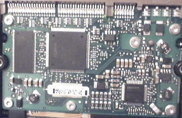

Post a pic of the PCB .

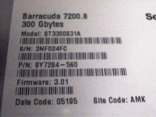

July 18th, 2008, 2:52
hd info.JPG (12.2 KiB) Viewed 11733 times

I have pcb for the drive u can PM for more info .
